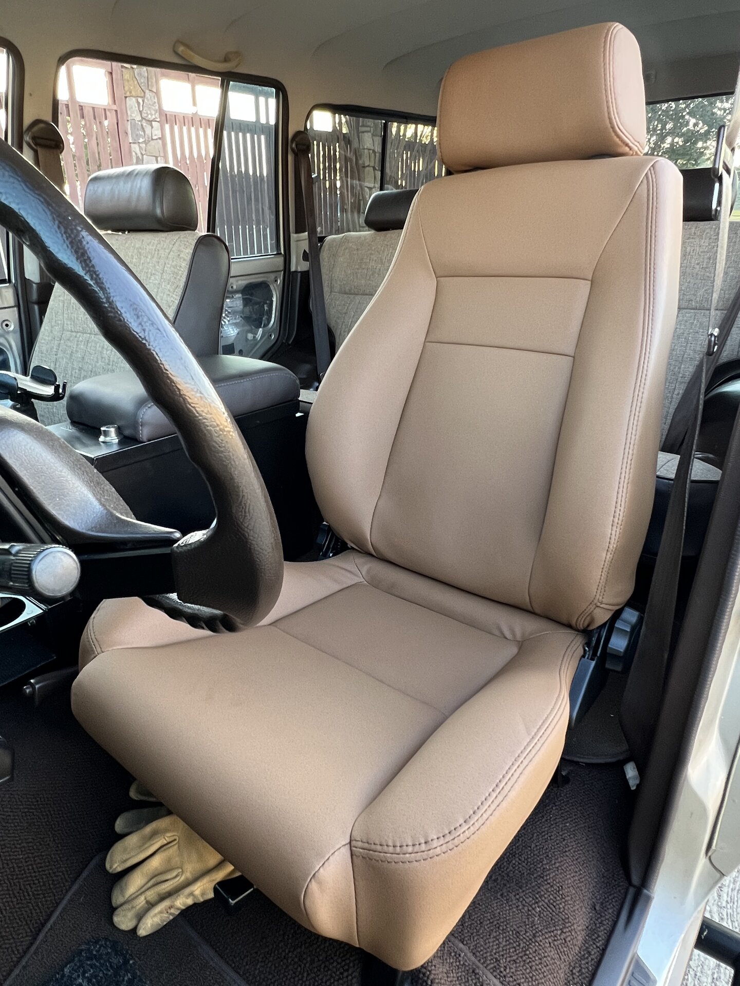

Had my interior replaced recently, Brown. Shop struggled to get anything comfortable with seat foam. Even with the trimming and cleanup it was no better. If you or your guy is good at structural foam work worth a shot, I spent the first year with a small pillow, every stop was torture to stand up. Pulled the seats out and bolted In Smitty. Bolted both seats in easy and comfortable. I’d have loved to keep stock but life is short. If you’re near DFW holler I’ll be glad to meet to show you what all I did with seats, I have my stock seats covered but can check them out to get an idea. The vinyl strips down both sides would look nice though. Entry side may take it harder. This is the CruiserCorp covers in rear and scheduled to have front seats covered to match soon

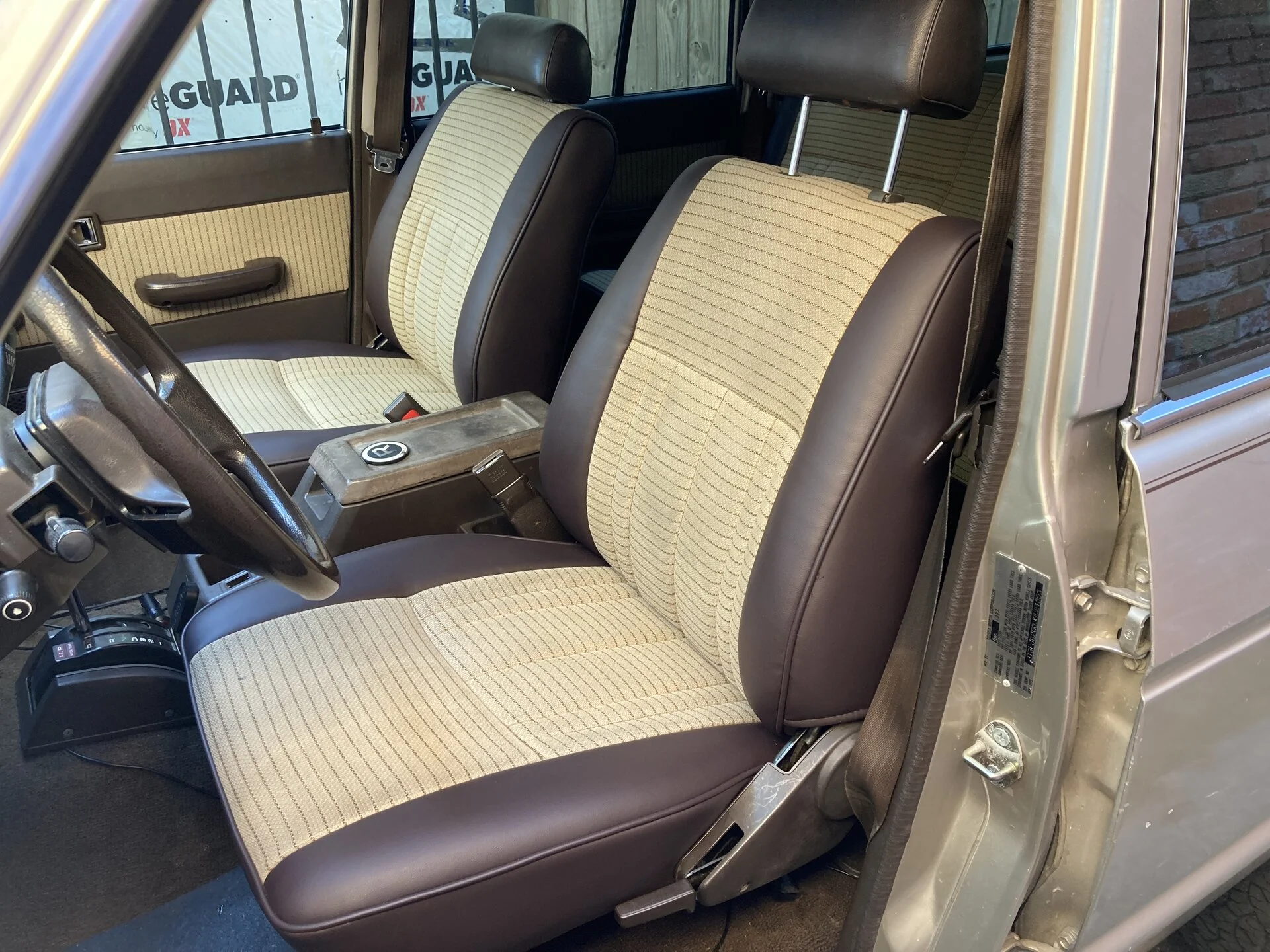

Well I guess I am stubborn, or determined to learn the hard way, because I went ahead and had the seats redone. The shop replaced all the vinyl and wrapped the bolsters, leaving the original fabric in the center so it all matches the rest and the door cards, etc.. I think it looks really nice. They are definitely better. The shop added extra foam in the bolsters and that helps a lot, although truthfully they are still a little lacking in lumbar support (which I am sure is how they were originally). Although the back seat was in pretty decent shape they did the same on it so it all matches. They also fixed the common issue of the bracket breaking its spot welds on the driver right side by welding it back together. Overall pretty happy with it.
