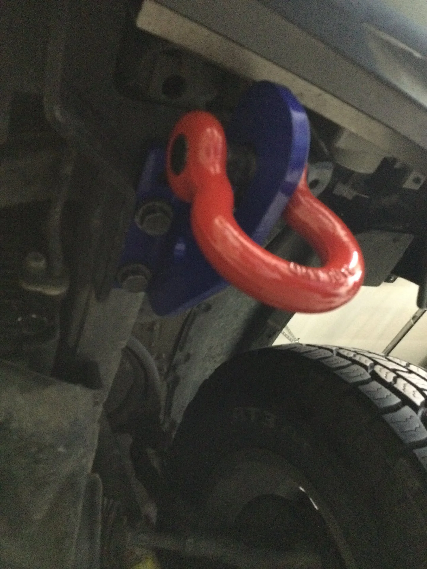

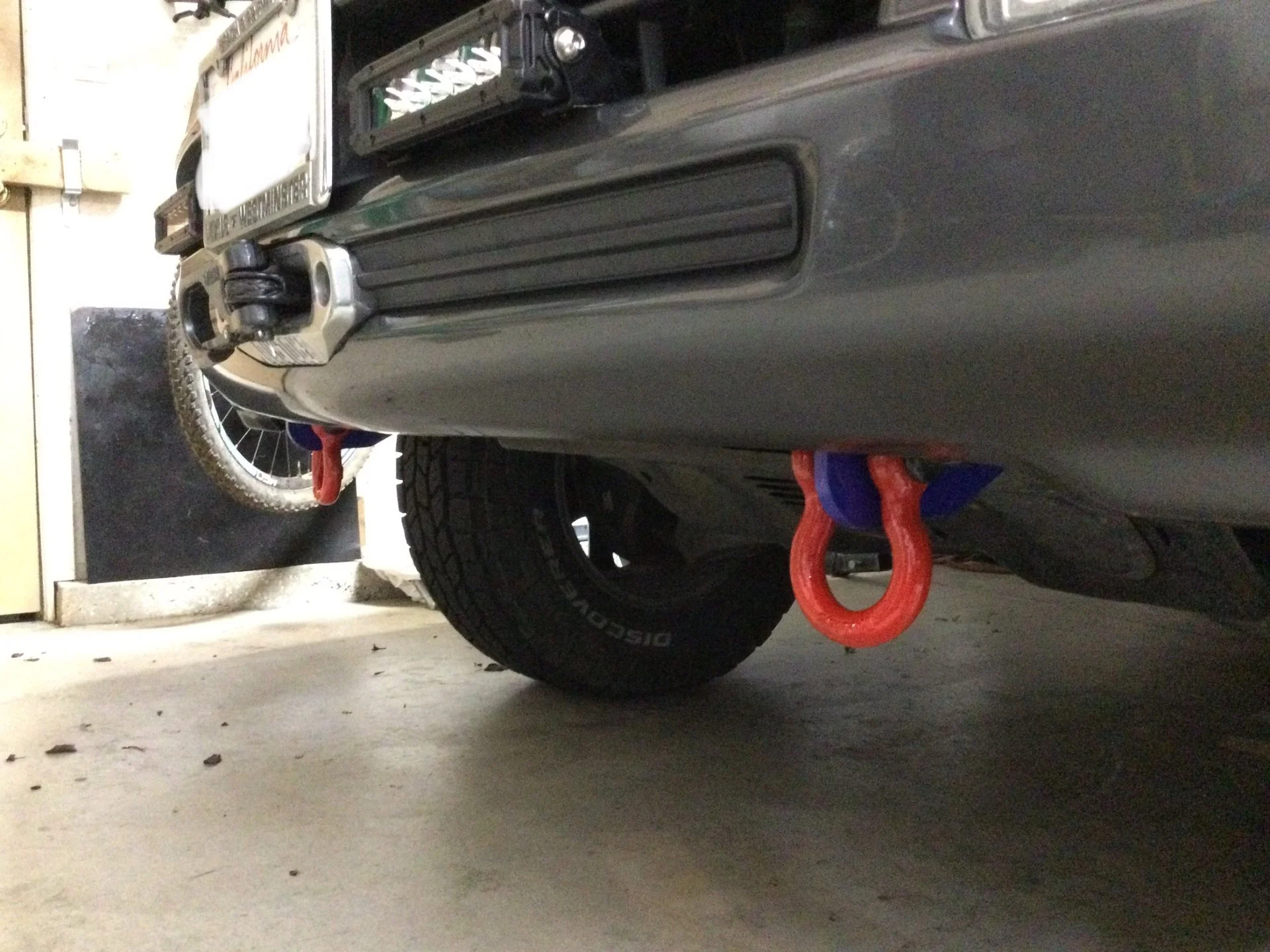

Took a chance on eBay that these tow points from a Nissan GU would fit and it payed off. For $80 I got some really beefy tow points with shackles. They bolted perfectly to my LX470 and put the shackles in what I think is a better position to to clear the bumper from damage and have a good pull. They are made of 3/8” iron so I think their pretty stout.
These look great. Anyone have thoughts on how strong they would be?
