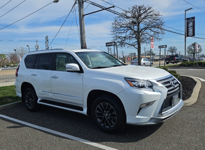

front & rear lip add-ons installed.
Is anyone utilizing the stock bumper & lip with recovery points installed? What setup are you using? Can a tow strap fit under the lip, without putting stress on the lip? Or a passthrough?
I bring my car on the beach. Its a little unsettling going on the sand without front and rear tow points.
Also, I'm planning to add a curt style rear hitch. Is this sufficient in the event of a rear recovery? This is just on the sand. I will never have the need to be recovered from a trail/ditch.

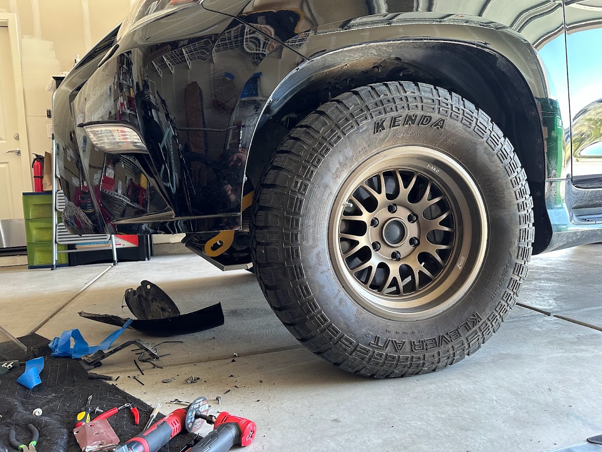

I have the Treaty Oak style recovery points, and I don't think they'll do a straight pull without touching the lower valence. I had the regular non-sport one. They now clear since I've trimmed the bumper, but there isn't really a straight line out from there.

Thanks for the replies everyone. Just from looking at it, you can obviously see there is no chance for a front recovery point with that valence. I was hoping someone made a pass through with minimal modifications. All of this was a no brainer on my Taco.
@r2m - Thanks for the links. To be in compliance with the NY state park 4x4 beach/fishing pass, its mandatory to have most of those items (jackboard, tow straps & d ring, portable toilet, shovel, fishing gear, compressor, etc) Already have CC and definitely been planning the MTS module, after I install the beatsonic. Its a shame though. I like to back in (barn door facing the ocean), for trunk convenience and ease of pulling out.
@jdam - i love those Kenda tires. I have Kenda's on my BMW F650GS ADV bike.
