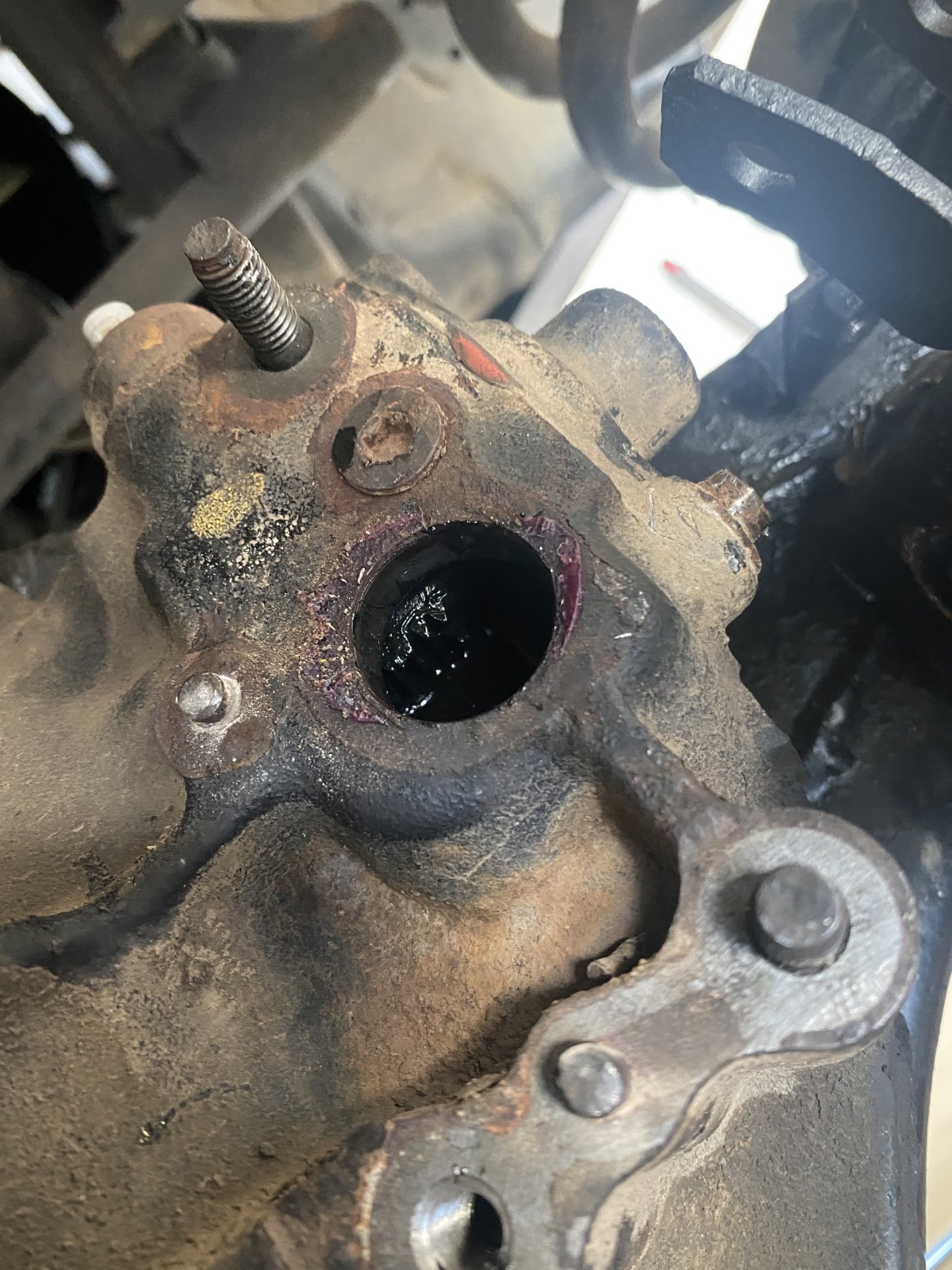

Pulled the actuator and confirmed it is locked. I have no clue how to get it loose.
If it’s still jammed use the mounting hardware to gently pull the third member back to the housing.
Then reinspect the shift collar
Pulled the actuator and confirmed it is locked. I have no clue how to get it loose. View attachment 2792488
Mine also fought back on the way out. Made it happen by rotating the pinion flange with one hand while pulling/rocking/wiggling the 3rd with the other. The ring gear was catching on the housing...by rotating the pinion & ring gear, the gear got traction where it was kissing the housing and caused the 3rd to pretty much walk itself right out. This was with the factory 4.10's on the way out. On the way back in with 4.88's, spinning the pinion in the opposite direction helped it settle back in. Good Luck!
I was finally able to get the diff out. I used a big brass punch to seat it back in the axle housing, manually locked and unlocked it multiple times and spun the flange while pulling it out as mentioned above. Thanks for the help.
