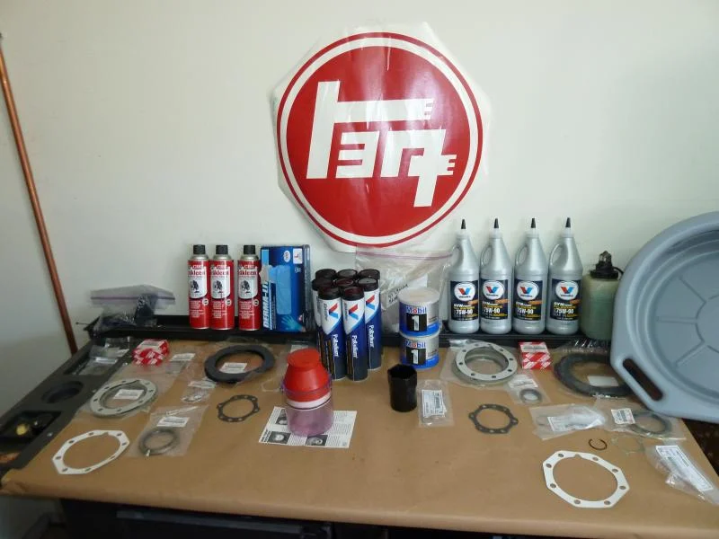

The parts and supplies are in.
Guess I'll jump in with both feet and see where this takes me. Read and re-read the rebuild procedure many times so I'm pretty confident that I'm somewhat sketchy on this whole repair, which in turn finds me moving forward anyway.

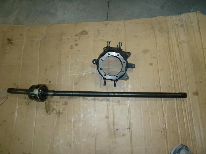

The Trunion Bearing was stuck on the trunion shaft, but a BFH and a ratchet extension knocked it off. I was amazed at how easy the axle came out and the axle seal as well...very messy so far.
What has been interesting is some of the gaskets don't seem to be in place...missing?
