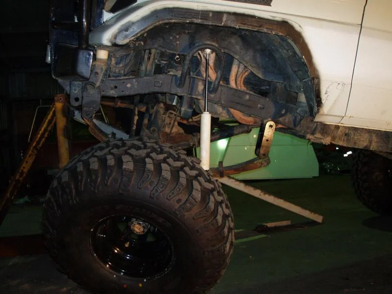

Has any one else had this problem? Im running an fj73 cruiser soa with a shackle reversal long leafs and shackles. Getting unreal flex with that heaps of axle wrap. Im thinking a ladder bar may be the way to but there is very little room and its going to have to be very short so i think it will bind up and limit travel.
Any suggestions?
Thanks

The spring clamps are not tight allowing the springs spread.....! Getting loads more down travel. So yes i do realise this is a big factor in whats making the axle wrap just intersted if this is a problem for anyone else and how fixed? Im thing that the ladder bar is the better way to go. There is just very little room to fit it. Im also conserned that its going to be very short causing binding.
What kind of springs are those? Looks like lift Springs. that could be part of the issue, and i think it was part of the issue in PPFJ60's rig.
I would clamp those springs back together, or better yet get some stock flat spring!
the flex you are gaining is not worth the issues its causing. I think a wrap bar is just a band aid in this instance.. most soa guys dont have issues with front axle wrap!
On flat ground the spings are dead flat they are stock rear springs..! The current setup works great if i can limit the axle wrap. If i clamp the springs back together i will lose lots of down travel if i can find awawy around that i be happier. But even if i do clamp them up it will still only be relying on pulling up on the last clamp pulling again on the top main spring.

There would be close to 300 mm from the last clamp to the do I need one closer to end of the spring? If so there is no point to mount it so what's the best way? I still think its a lot of force on the end of the spring I can only see a ladder bar if done the right way reducing that load its done wonders for the rear and its the same principle.
