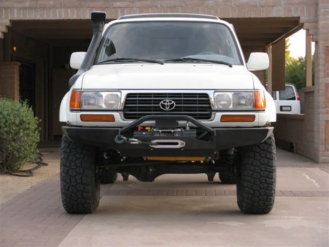

a slee bumper + ARB upper portion for the tail light protection
buy a slee bumper, take it and a picture of an arb bumper to a local shop and have them bend up some 1/4" thick pipe to match the taillight protection of an ARB
done
:cheers:
Even though I think that looks really good, The upper tubes form an integral part of the design and adds a lot to the strength of the winch. Removing them compromises their strength a lot.

Here's my front. Designed by me and welded by my sister (she's the journeyman in the family).
Not the best pic, but gives the general idea. Can take more if anyones interested....
The wings have stiffner plates on the backside. Weighs about 60 lbs, as is. All 3/16, 3/8 and .120 DOM
Designed for maximum approach angle, winching AND wildlife impact .....
