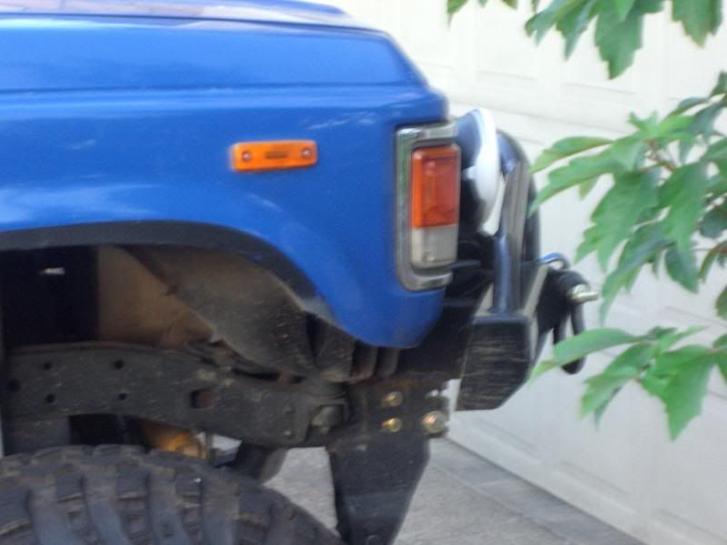

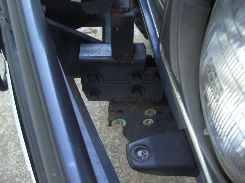

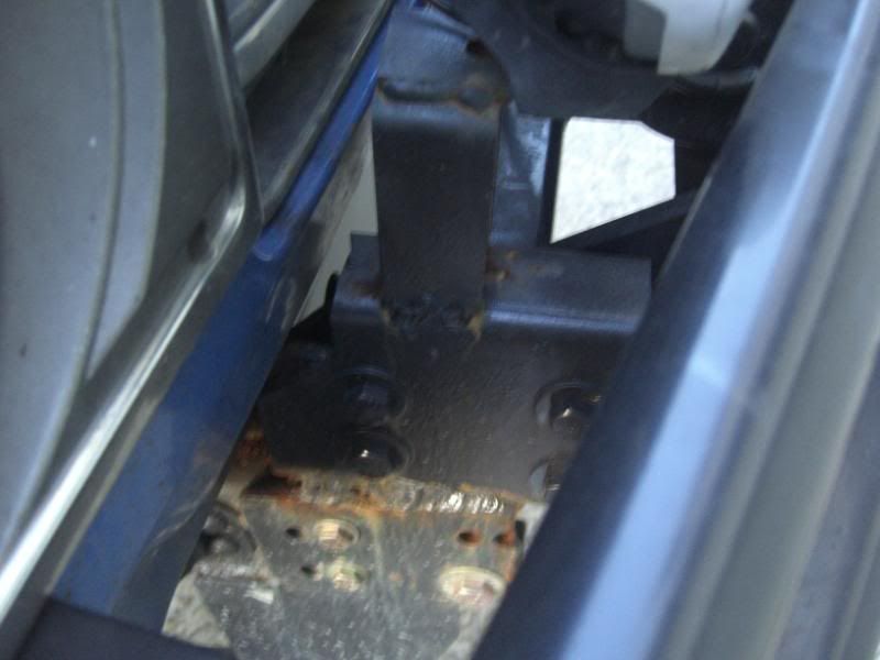

I was comparing my result with 2mbb's results and I think mine is probably like an inch lower than his and I ended up with a gap below the valence. I used 2x5 tube and he used a 2x6 and also offset the tube so that it sits higher. If I had to do it over againthe I would move the bumper up on the D-ring plates.
All in all I'm pretty happy with the outcome for such a low cost...now I just need to fix some body stuff.
I welded some 2x6 to the top of the stock location and made some cuts in it to suck it back and up... Worked great. I'll see if I can dig up the pics.
By the way... great job on the bumper.
