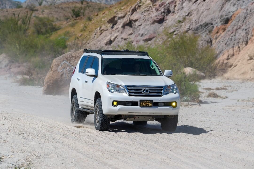

Thinking of adding an ARB Summit front bumper/bullbar and winch to my 460, for a total added weight of ~310lb (more if I add driving spotties). As an Aussie expat I'd style it in "bush Prado" fashion (keep the existing 265/70/17's, bump the lift height a little and add the bullbar).
Would love input from others who have installed one - how much did this affect driving dynamics, braking/handling etc? I previously owned a fully armored (front bar/spotties/rear dual swingouts etc) 100 series LC, but bought it that way and didn't have a chance to compare stock vs bullbar.
Would love some insight from those who've added the 300lb of metal to the nose of their GX - did you have any regrets? I wheel moderately but really love the way my rig currently accelerates/stops/handles during roadtrips. It's currently on 31's and have no plans to change that given how well it drives.
Thanks in advance and photo for reference.
