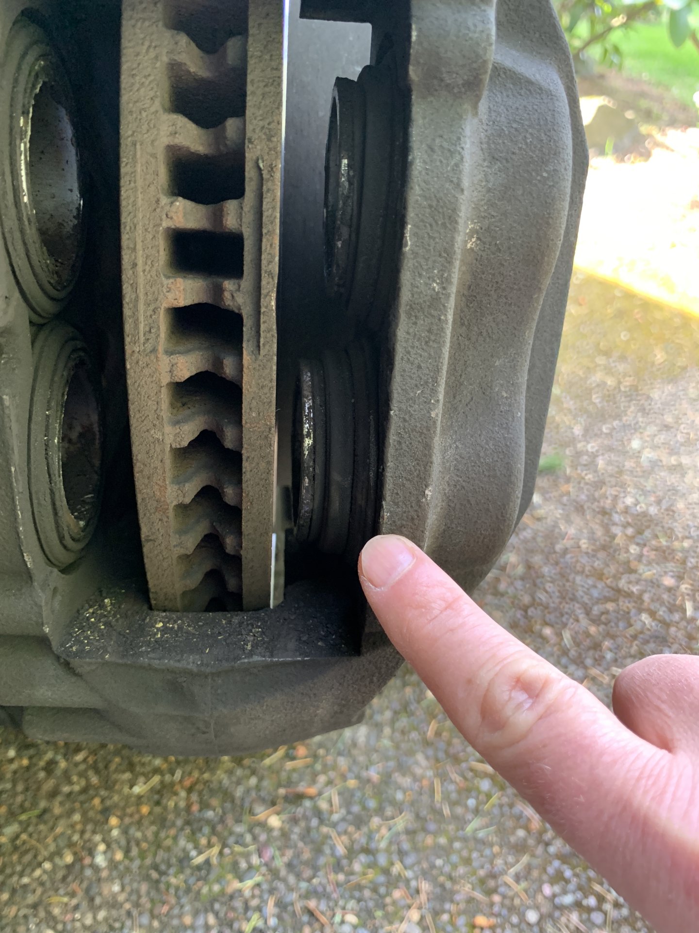

Working on a break pad and rotor swap and this piston won't compress. Does anyone have thoughts on how to resolve this? Was the piston pushed too far out of It's track? Thanks!

Hmm....it looks like you got 3 of the 4 to move back. I wonder if when you pushed the others in that one came out too far and is now stuck on the back side of the piston? It looks really close to the rotor. It's also not uncommon for pistons to get frozen in calipers from corrosion. If that' the case, it's new caliper time anyway. Any unusual wear on the pads that would indicate a stuck piston?

At issue is your lack of space between the piston and rotor. You may need to allow the rotor to tilt away from the piston you are working on.. if it is corroded/bonded to the hub face loosen it up with a dead-blow hammer, leave the caliper in place. That should give you more room between the rotor and piston face to work.
This could also be the case. But, our brakes are designed to keep the pistons well in place even when the brakes are worn down to just the backing material, which is quite thin. I personally don’t think the piston is out too far, yet.. though it may have pushed further than the others increasing the odds of tilting and binding.
It’s good our calipers and pistons are steel.. that fact gives you some protection against forcing a piston that is binding from damaging the bore. @LXGus I’m pretty sure you don’t need any more parts or to go through the effort of opening and rebuilding anything just yet.. just a change in technique should get this thing moving.
Edit: looking again the rotor slot in the caliper won’t allow the rotor to tilt. Try prying evenly on two sides of the piston with flat head screwdrivers and see whether it will move. Just attempt to make them as close to 180° apart and the prying forces as even as possible.
