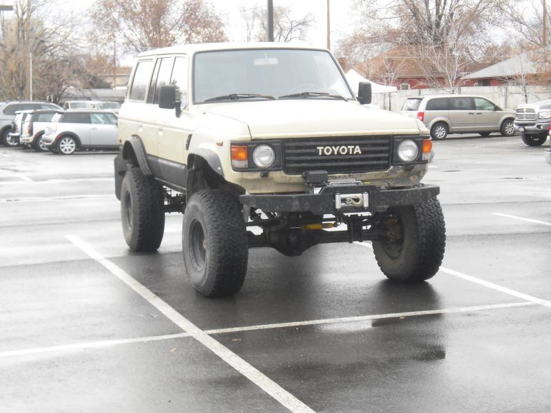

Front axle stretch
Some better pics with less snow.
your axle turned out great mike! it was nice to see you were driving your 60 around today haha
Yeah I like the fenders to and I need to get some soon
The front fender flares are cut from some Jeep flares I picked up. I mounted aluminum angle brackets directly to the fender with well nuts and used stainless allen bolts to hold the flare to the brackets. On the rear, that's another story. Its a lot of aluminum plate, lots of seam seal and about 700 (I'm not exagerating) pop rivets toped off with Herculiner. The flares are mounted to some 1/8" ABS sheeting that I bent into a 90 degree piece using a heat gun and a vice. I cut reliefs into the side that mounts to the Cruiser to facilitate the curve of the fender and riveted that directy to the body and a separate piece to the door. Then I riveted some 3" rubber flares that I got from J.C. Whitney to that ABS flange. The original lip that went around the rear fender is entirely gone; it was all rust. The bottom of the rear quarter panel is also gone, replaced with the same aluminum plate, seam seal, rivets and Herculiner. I welded some nerf bars to the frame beneath the quarter panel to protect my work and hung a mud flap from that. I'm all done with body work. If it rusts in two, I'm headed to Phoenix to get another rig.
