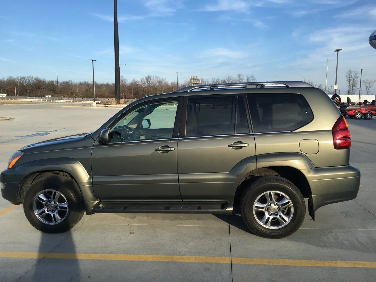

Ok, with help from this forum, I bought a 2006 GX Sport a few weeks back as a 2-for-1 work 4x4 and family wagon. I've done a few small things already and have a long list of things to come, mainly limited by my time.

OK, with my previous truck still not sold, my better half has co-opted the GX as the family DD. I got a Yakima aerobar setup on the roof for when I "borrow" MY truck for a trip coming up. I picked up a mini-hitch off a wrecked 4Runner to install at some point if I don't find a stock 3-point hitch. A buddy and I replaced a leaking CV seal and I changed the diff fluids to Mobil 1. During the differential job, we noticed that both front OEM shocks are leaking and the driver's rear is a rusty mess. I'm not pleased with the ride in the truck at all, it's rough even on the softest setting. Then I saw it sitting unevenly and spent an hour messing with the air adjustment sensors to get it to even out. Passenger side setting is set as low as it will go and driver side as high as it will go without touching the tie-rod style parts of the adjusters. I figure a suspension overhaul is in order ASAP but funds are tight: I've already put lots into the truck and my previous one is still sitting around. I like the idea of the adjustable damping but I have never used the stiffer setttings due to the already rough ride. I care less for the self-leveling airbags. It's a KDSS truck and I have no plans to lift it (I have it as a family hauler and sandy or muddy terrain work vehicle).
I need to come up with a plan and parts list. My goal is a balance of solid comfort and handling on the highway with durability and OEM or better performance offroad. For the moment I'm thinking about three shock/strut options: scraping to get new OEM adjustable shocks (about $1200 in parts), OEM FJ Cruiser or 4Runner shocks, or Bilsteins. 2004 GX470 - Replace AHC without lift?. After that I might go with a Metaltech airbag delete/coil conversion at stock height GX470 Rear Coil Conversion Complete Kit, which doesn't include the springs themselves. I'd appreciate any feedback. Thanks,
