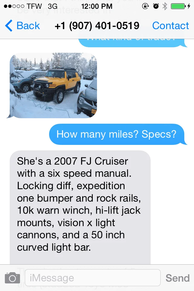

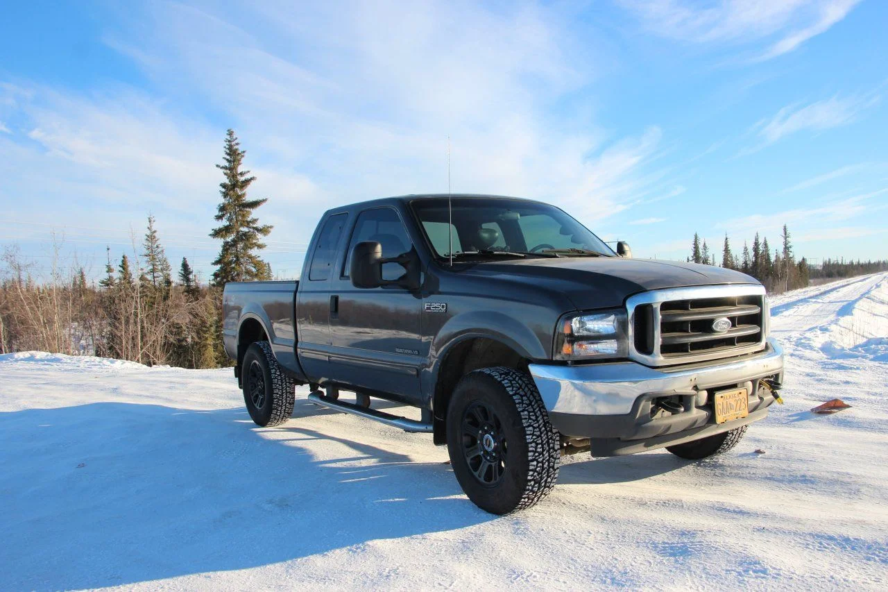

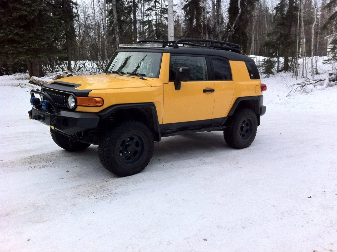

Fast forward to a few weeks ago and I was trying to sell my old 2002 7.3 diesel Ford, a guy texts me a pic out of the blue of his 2007 FJC with some tasty goodies and said he wanted to trade his for mine. I thought it might be too good to be true as his was worth several thousand dollars more than mine. We ended up meeting up and buttoning up the trade the next morning.
Pics of my old 7.3 and the first pic he sent of the FJC.

Now to the good stuff. The specs and mods done to the FJ before I got it.
-six speed manual
-All three packages offered for the FJC in 2007
-Everything blacked out
-Two set of rims and tires
-rear backup camera
-rear LED reverse light bars not hooked up
-50" ebay curved light bar
-Highlift jack and mounts
-Expedition One Front bumper
-Warn VR10,0000 winch with synthetic line
-Vision X and PIAA lights on front bumper (only the Vision X's work)
-Weird blingy front grill (OEM was included)
-Expedition One sliders
-Professionally applied Rhino Liner to the roof and front "unibrow"
-Homemade dual battery setup done nicely
-Kenwood double din head unit
-Big sub and amp that took up the ENTIRE trunk space
-Springtail MPAC pet barrier
-Springtail rear hatch rack
-Toytec Coilover lift

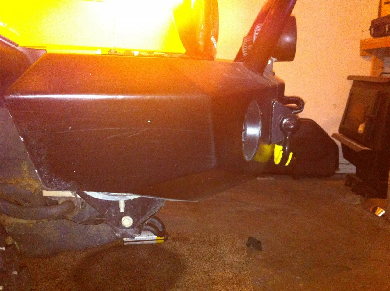

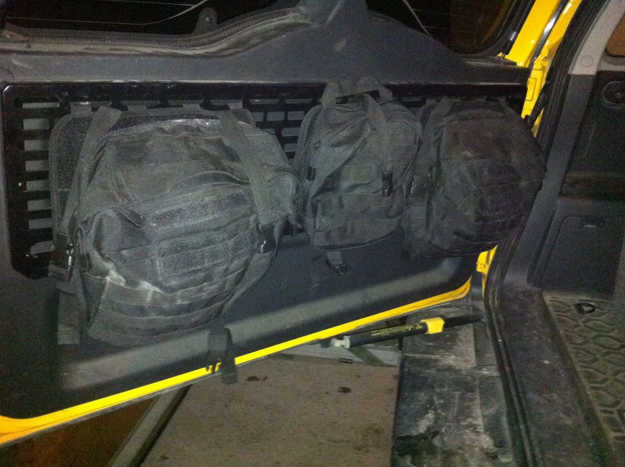

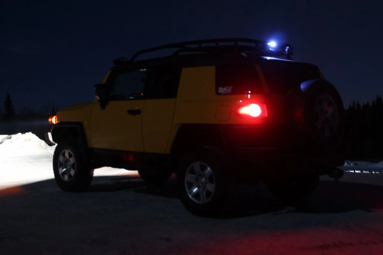

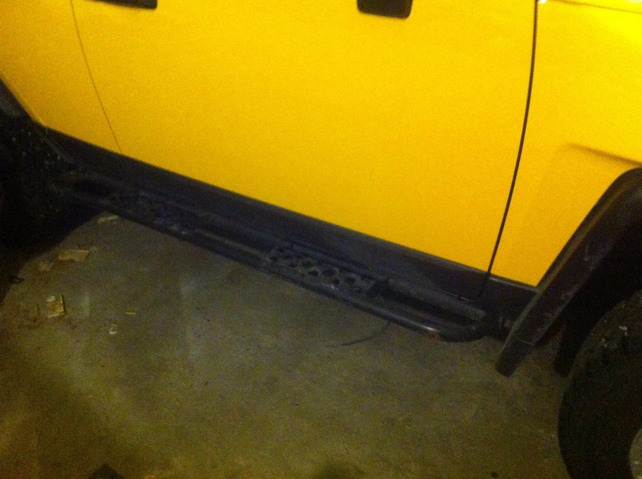

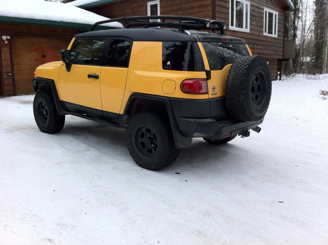

You can see why this thing piqued my interest! Quite a bit of the stuff I would do to it had already been done. All of this and it had just under 100,000 miles! Here's a few pics of how it was when I got it home.

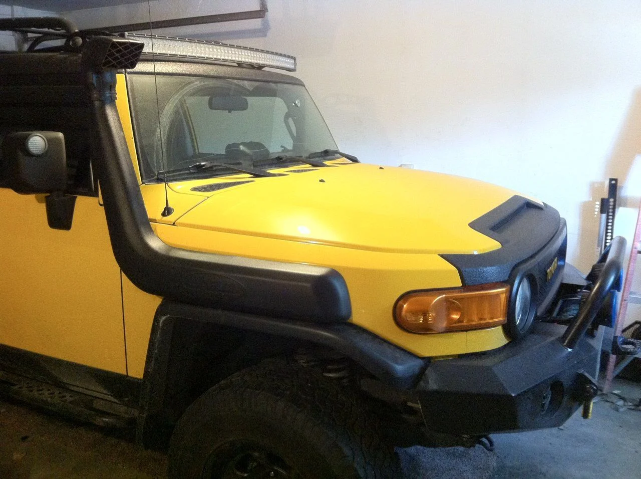

After selling the stupid and poorly wired sub/amp combo I decided to pick up Pfrans FJ Cruiser LED kit with the reverse lights as well as a Safari Snorkel. These installs have been done a million times so I won't do a blow by blow analysis, but that LED kit is THE best thing you can do for an older FJ. The interior is so much easier to see in at night.
The Safari Snorkel was purchased for the times that I do take this thing hunting. To get to our cabin we have three stream crossings. Some years there is 6" of water in the creek bed, other years there is 4'+ of water. We hydrolocked two rigs going back there over the past 10 years or so. It's not happening to mine.
More pics.

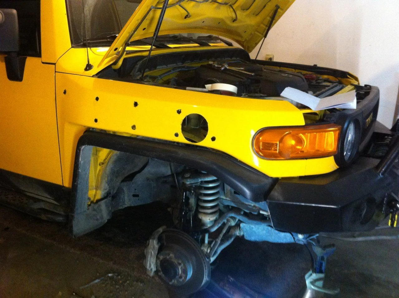

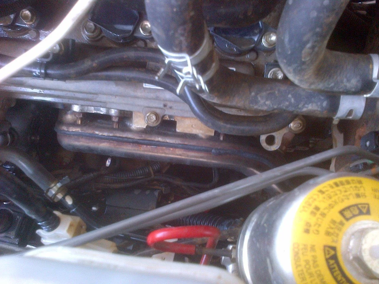

I changed out my exhaust manifolds when my primary cats went bad (same codes). Don't bother changing out the O2 sensors hoping your problem will go away (an unnecessary cost and ultimately not the problem). It's a bit of a hassle, but you'll save yourself some serious $$$ if you do it yourself.
The old ones:

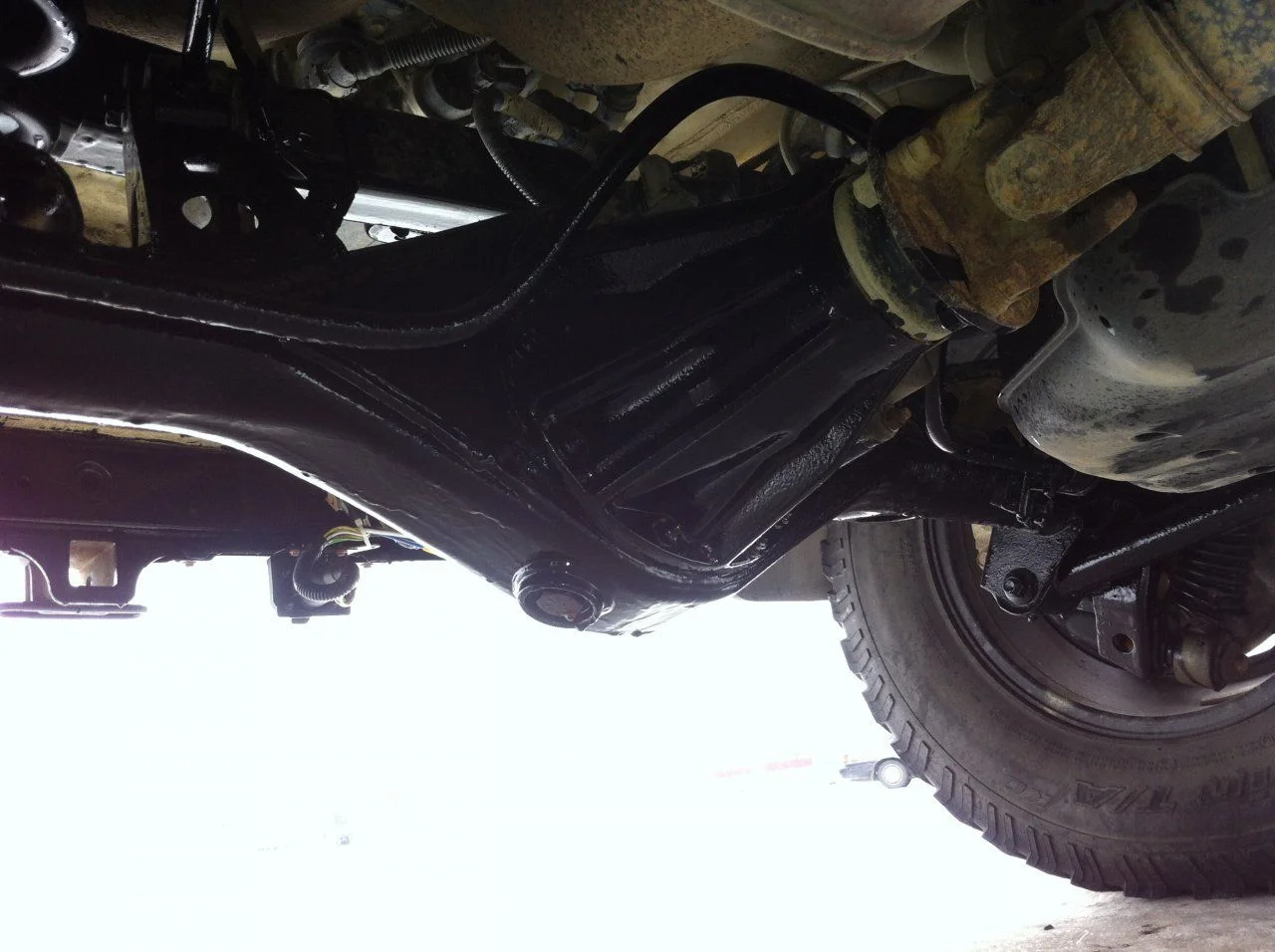

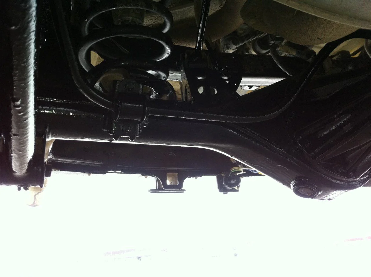

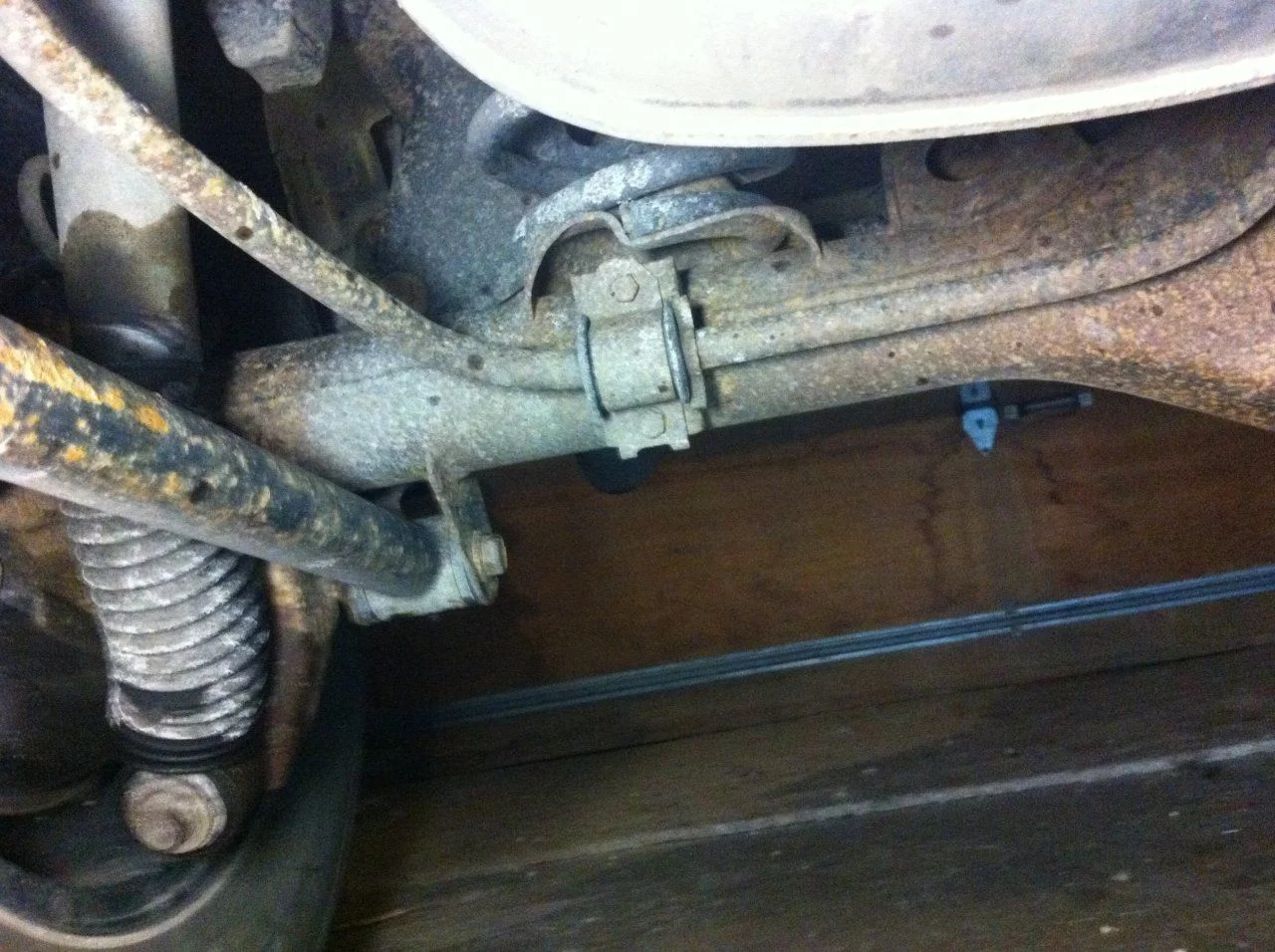

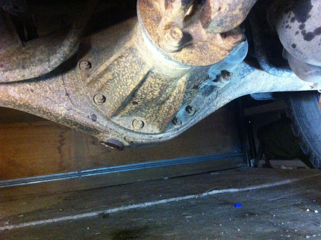

I got the frame and axles completely POR15'd today! Not fun, but worth it as most of the rear axle and rear part of the frame was exposed metal. It's slowly coming along.
A buddy and I went out and watched the Aurora's for a while last night, so here's some pics to keep you entertained.
TK
Here's a few before and after of the undercarriage. The rear axle and rear frame were the worst. I obviously applyed the POR15 thick and used three coats. It layed down very nicely with a foam brush. This FJ has been down quite a few gravel roads judging by the lack of any uncarriage paint on the rear axle/frame. There's just something "right" about a nice, fresh coat of undercarriage paint.
