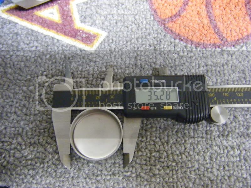

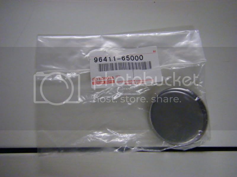

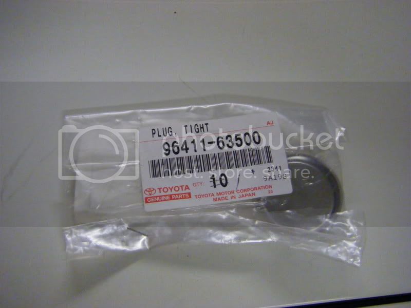

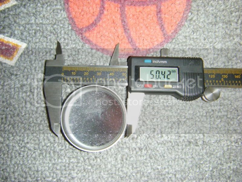

Here's your answer..and then some. I have both in stock so I shot pics of the large one as well:
Large:
Small (the one you need):
The plugs are slightly tapered. They could be 35.4mm toward the top edge.
Anyone know how many 96411-65000 & 96411-63500 I need to change out the entire block? (Its at the machine shop or Id count)? Any other sizes besides these two on the block?
Much appreciated! Oil pump bushing is on the list. Wasnt aware of the galley bulls and plugs 'cause I'm in way over my head at this point....
Yeah, your machine shop should pull the balls/plugs and clean out the oil passages with a bore brush, because just running the block through a hot tank won't clean them out. years of oil sludge and build up and recent machine work shavings will collect in the passages and then work their way throughout the engine once its running... not good for the bearings.
