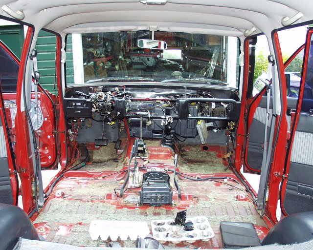

I hate that "while I'm in here..." condition, what started as a radio installation in my Lux turned into a gutted interior/dash, box removed rust repair and reassemble gong-show. Still haven't even started on the radio wiring yet either!
LOL... I get it bad. Many years ago I decided to install some new speakers in the doors of my FJ62, next thing you know I was looking at this:
I'll see if I have a picture someone... I went as far as entire dash assembly out, heater box and evaporator removed, cleaned out all the vents and even took the pedals out so I could clean the carpet on the firewall..... That picture there looks like my current state on reassembly lol
