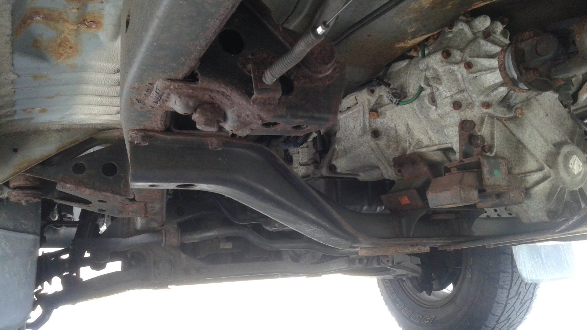

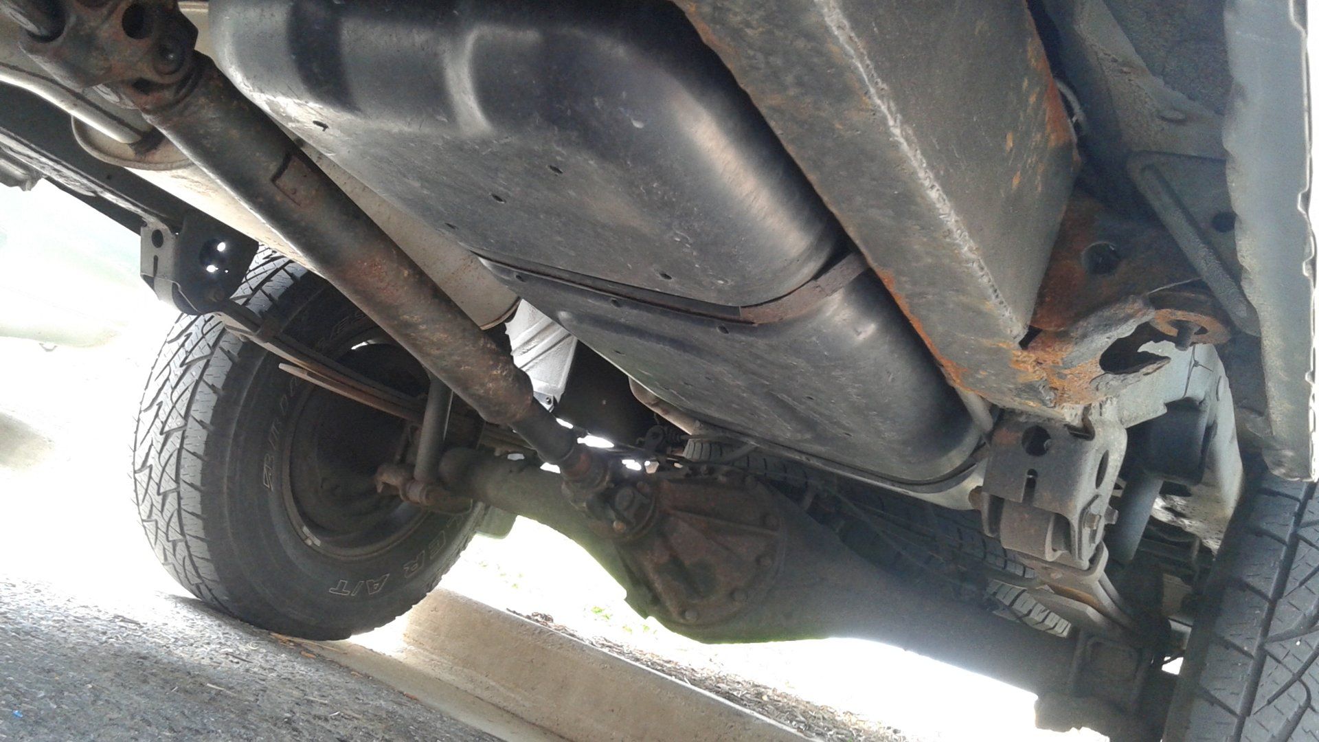

Considering a low mile T100, it seems to have some frame rust and just wondering what y'all think. The price is good. Curious how bad this is and how hard to fix. I have attached some photos
Thanks
That doesn't look too terrible.
You can alway clean it with a wire brush and such. Then apply an undercoating yourself (there are plenty of YouTube DIY's). It's a lot of work and a PITA but it can be worth it. Or you can always find an undercoating company in your area and they'll do the same thing. Just depends how much $$$ you want you spend.
For the future of the truck just make sure you use anti-seize on almost everything to keep the hardware from corroding and giving you problems.
