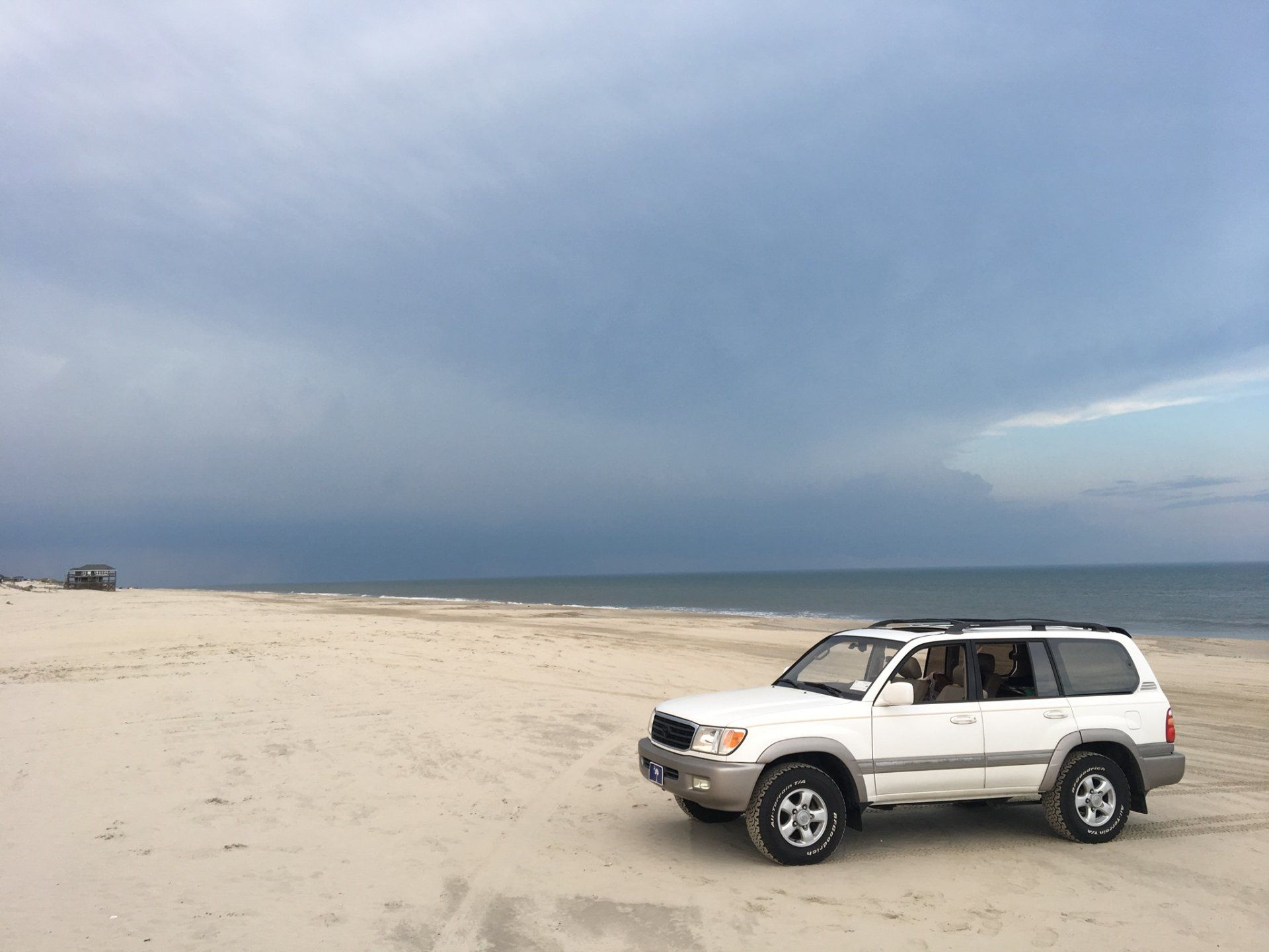

Just bought a 1 owner 2002 with 150,000 miles. I know the original owner and finally talked him into letting it go! It's a non-nav, auto climate control model. Serviced every 5k religiously. It's so nice I hated to mess with it but that's no fun. Took it straight to the shop after talking to Slee for some pointers.
Here is what I've done so far;
Replaced rattling door speakers, new Kenwood touch screen with Bluetooth all through the factory amp etc.
Tint
OME 865 rear, turned factory torsion bars front, new factory shocks all around, and Slee diff drop. added BFG 295/75/16 KO2s
Removed running boards and installed oem front mud guards.
Here are a few before and after. Still a work in progress.
Damn, that truck is CLEAN. good buy.
Sweet man, that's a clean 100 right there.
I love the silver ones the best, well maybe second best as my 00 is white, lol...
Super clean, Yeah I would have jumped all over that one also.
