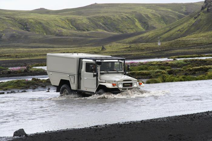

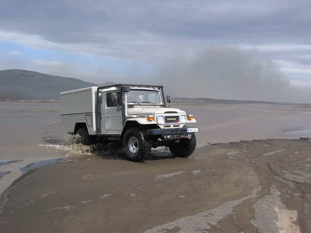

I found pictures, which show the effect of speed in the water.
Here in a hurry, although the water is shallow a lot of spray and the bow wave might get the engine bay wet

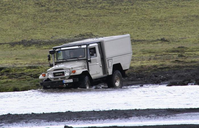

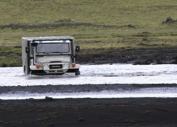

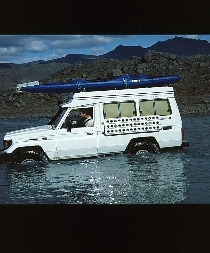

here we go slowly (as usual:D) first gear low, you see nothing gets overflowed even though the water is deeper, about 80cm.

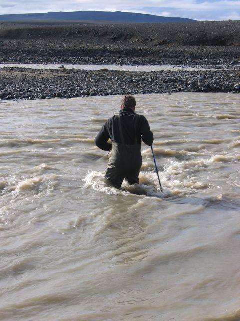

When the current isn´t strong and the water isn´t to deep best is to find out where to cross and where the stones and quick sands are:

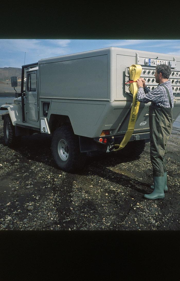

when the current is stronger I dress with dry suit, life-line and life jacket.
But crossing with a (modified) car will be still possible when walking through gets very risky or even impossible.
You have to be able to read the water while driving through the ford to do so...I have been afraid to learn the hard way :eek: so far...

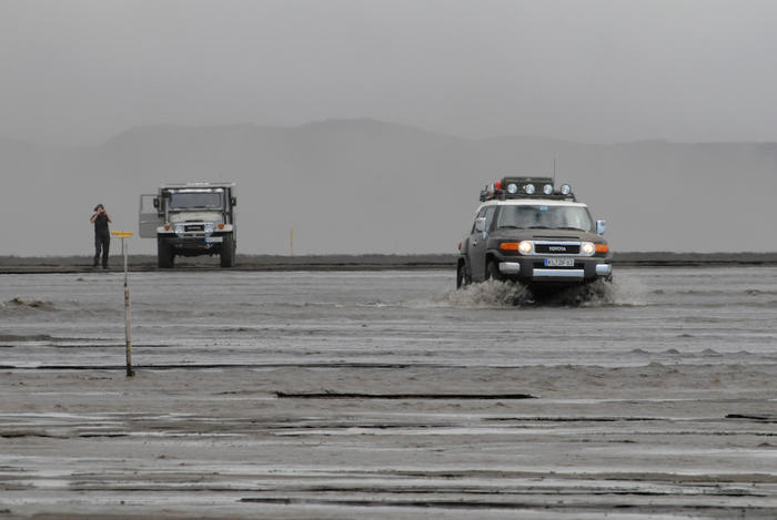

here a so called Sander, wich can be overflown by glacier rivers

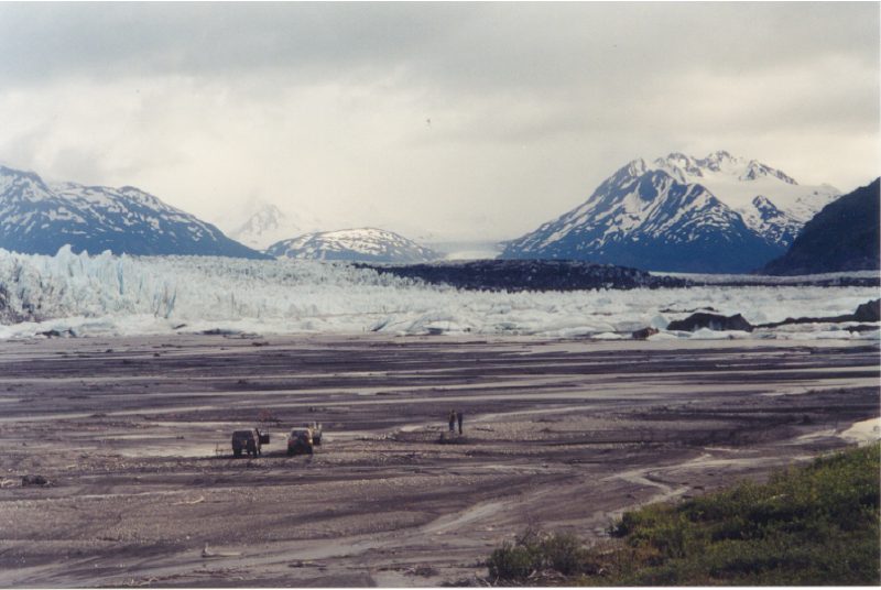

alasca cruiser trek

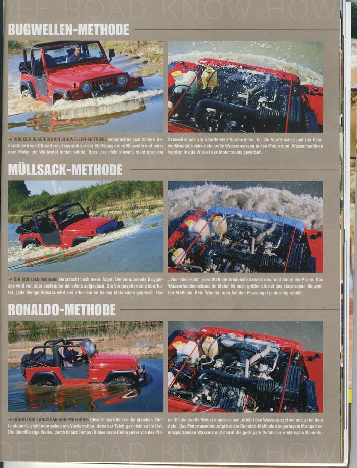

still the way of crossing rivers differ from what i´ve heard or practiced.
I would always go with the stream ( in Iceland 2 one way fords are used crossing the big rivers with the current each direction )
and I go a lot slower, trying to make no waves / wake
A german off-road magazin just published pics taken from the engine bay with different speeds in the same ford...
first pics are with speed for the bow wave
second line is with cover in front of the radiator
third is just slow:cheers:

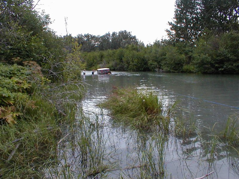

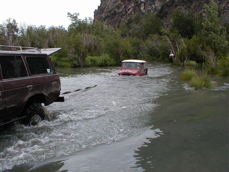

Sometimes it's amazing how far you can go....
before water in the engine, water in the fuel tank,
Time for a tow to some dry ground...

...Due to the current and the
depth, getting a line on the front of the rig was out of the question,....
when the crossing might become difficult I try not to forget to fix the cable before entering the ford...very simple but hurts when forgotten
