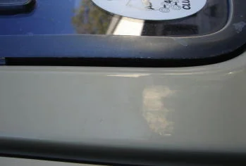

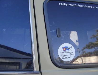

Dan, the best install I've seen was on wagoneer5's truck. He used buytel tape on the edge of the body seam then pressed his window on. It leaves a gap around the outside edge of the window frame for water to flow out. I used the polyurathane window goop that you can buy at the body shop supply store. Heat it up with a heat gun a little bit and it squezes pretty easy. I filled in that gap all the way around the edge of the window and tried my best to smooth out the urathane glue to make it smooth before it dried. It looks like crap up close, but from 15' it looks fine and it doesn't leak.
If I was going to do it again I'd get some beutle tape from the body shop supply store and stick them in with that.
LMK if you want pictures of mine.
HTH

I used butyl tape in one, and to this day I'm seeing its effect. My 6 year old, now 8 yo likes to pick it (it doesn't harden) and tease his sisters with it, flinging little balls of it. On the other side, I used urethane (also from the glass shop) and it was soo much easier and less mess to clean up. But I wanted to do it like the FSM said to do it, so I did. Neither side leaks, side with tape bulges out from window recess about 1/8" more than side with urethane bead. Nothing really keeps the window from "falling", besides the welting, that is the same stuff as that found in the door perimeter.
Crawl -
Both the butyl & the urethane are preventing the windows from falling out, not just the welting. The bulging on the butyl side is from improper size and/or placement of the butyl.
