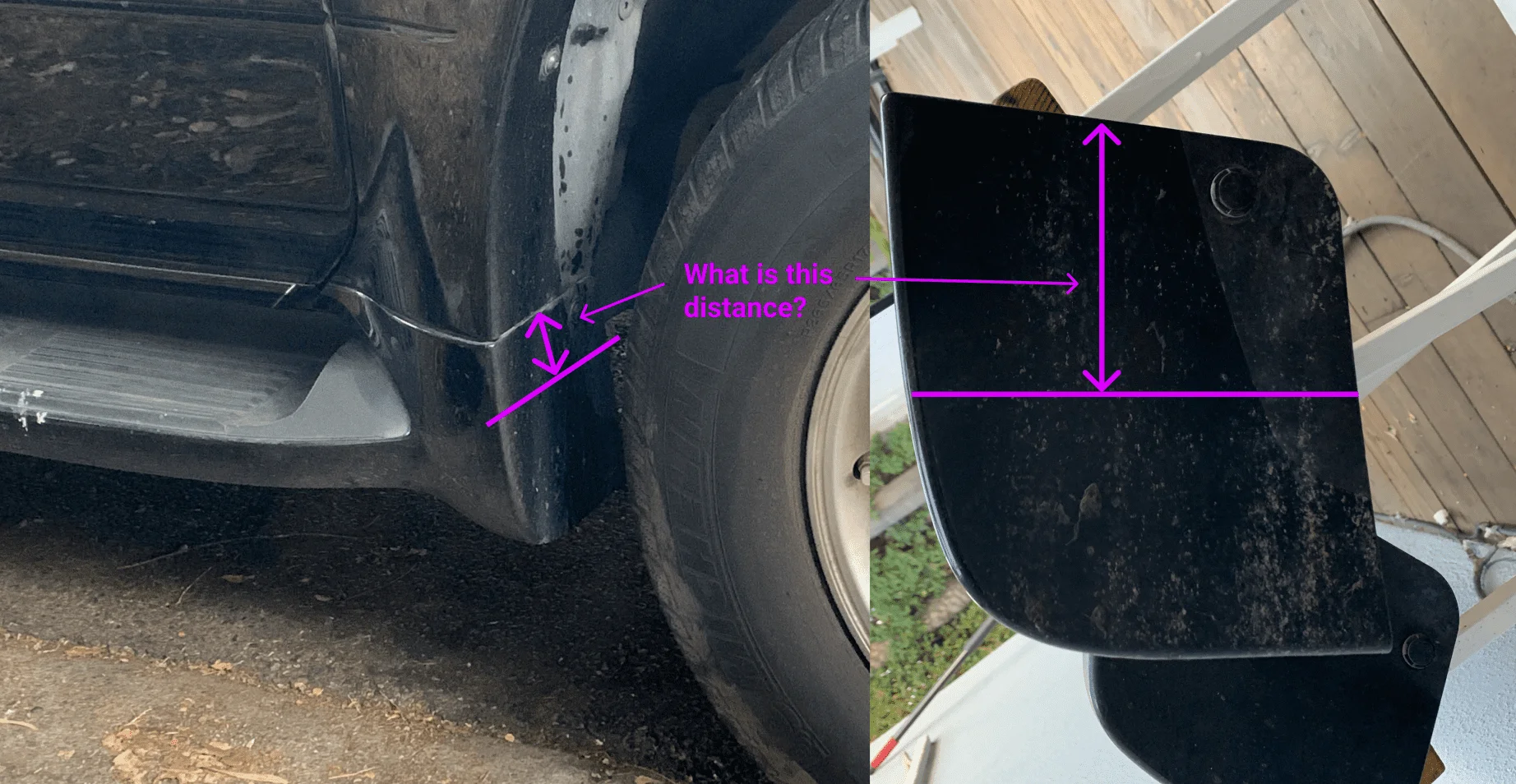

I pulled my running boards and cut the trim section off. The back end is all set, but I still need to trim the portion behind the front wheels. I'm looking for ideas on what measurements folks have used that allows for sliders to be installed and still covers the ugly mounting point behind the front wheels. See the image below. Could anyone share what this measurement is after you've trimmed?

It depends on what sliders you get. If you get GX specific sliders then you might wanna leave the trimming until after you get sliders to get exact fitment. If you get 4runner sliders (fits gx because same wheel base but actually a little shorter) then the sliders most likely won't impede with that trimming. I went a tad more than the width of the masking tape. You can always trim more if need once the sliders are on, but you can add trim lol.

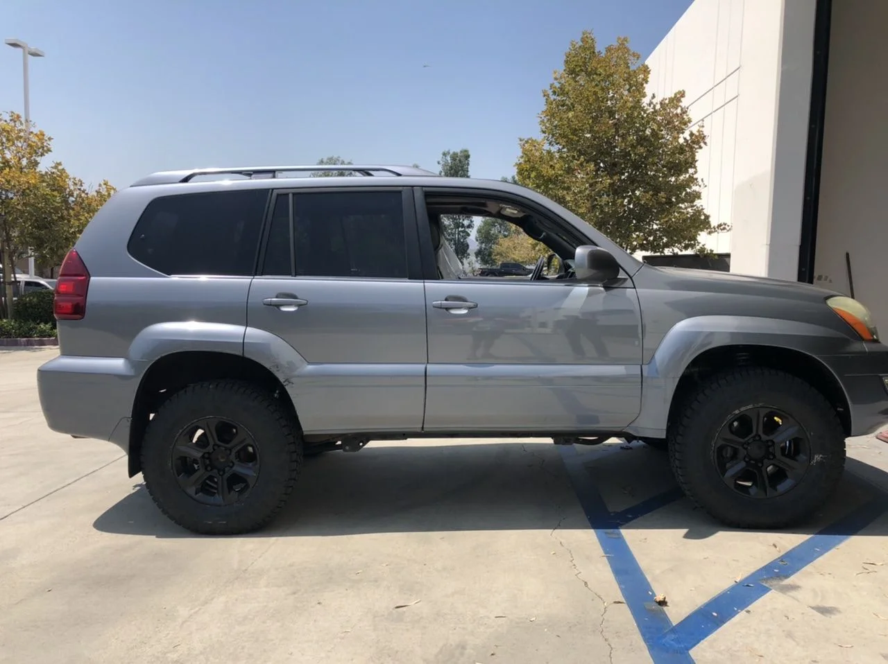

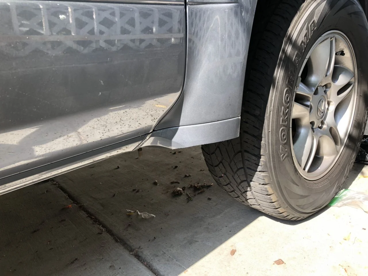

The white knuckle sliders stop before that trimmed piece anyway. so even if you left several inches up front, the white knuckles wouldnt come in contact. I cut mine way high so it sits flush with the rest of the bottom of the door lines if that makes sense. I did this because i liked the lines and i simply wanted to cover back up the exposed clip holes to make it look clean.

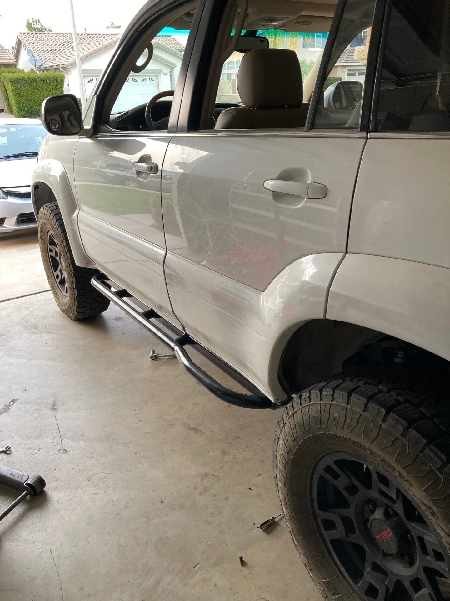

not the best photo but you can see where the white knuckles end. Ive seen guys leave several inches on the plastic fronts with white knuckles and no issues.
Makes perfect sense @Tanner H — any chance you could share a measurement from the top seam to the cut edge? That looks really clean.

Yes, I'm well aware. I'm just trying to get a couple of measurements from folks who have done so in order to get an idea of where to start.
I went through this process and determined that I needed 1-3/4” measured from the top. This will give you just the right clearance so you don’t cut through the clip holders on the back of the trim that hold the plastic push clips. I‘ll see if I have any pictures.
It also helps if you have a steady hand or someone that does to get a good line.

Thanks. I already trimmed mine to 3" — figured there's more to cut back if I decide to.
What brand/model are these sliders? Very clean 👌
