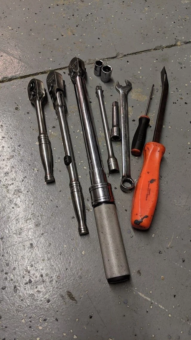

Heres a bunch-o-pics. Its a 200 but basically the same:
