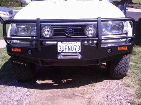

I have seen quite a few posts asking about this and decided to share my experience.
I was looking for a clear fog light that would mount into the turn signal light location in my ARB bumper. I knew that they would be too high for fog use and was only looking for a light that would illuminate wider than my low beams for negotiating in tight places seeing around corners and spotting that deer abut to jump out of the bushes.
After searching for a quality light the right size and not finding any I settled for the Shucks XT850 Xtreme fog light mainly because it is the right size and it had a wide flat fog light pattern.
The result is definately not a fog light. On top of being too high and the bulb being weak, in order to mount the light flush with the bumper the alighnment is extreemly towed out due to the angle of the bumper. But all this works to give me a light that allows me to see about 25 feet at a right angle to the bumper. That means that when driving down a two lane road they light the ditch on both sides at a right angle to the bumper while not annoing the oncomming traffic due to the flat low pattern. I have been running these for about 4 months and never been flashed by oncoming drivers.
In order to mount I just made a 3/4 inch spacer mounted under the top of the bumper with carrage bolts and bolted the light to the spacer. For alighnment I center the light in the hole and pushed it snug up against the ARB turn sighnal mounting tabs after taking out the plastic mounting thingys that the original light screws into.
Looking up from under at the spacer and mounting.
From the top looking at the carrage bolts.
Hope this helps I am pretty happy with the looks and fuctionality right now but will probably look for some better bulbs in the future.
