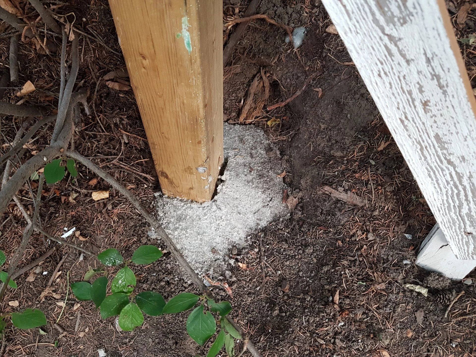

My neighbour used this product instead of concrete to set his fence posts several years ago. The 25' long, 6' high fence is still straight and solid.
So I thought I'd try it on a couple of posts that needed replacing in my yard.
The package advertises that one pack can do two 4x4 posts.
In theory.

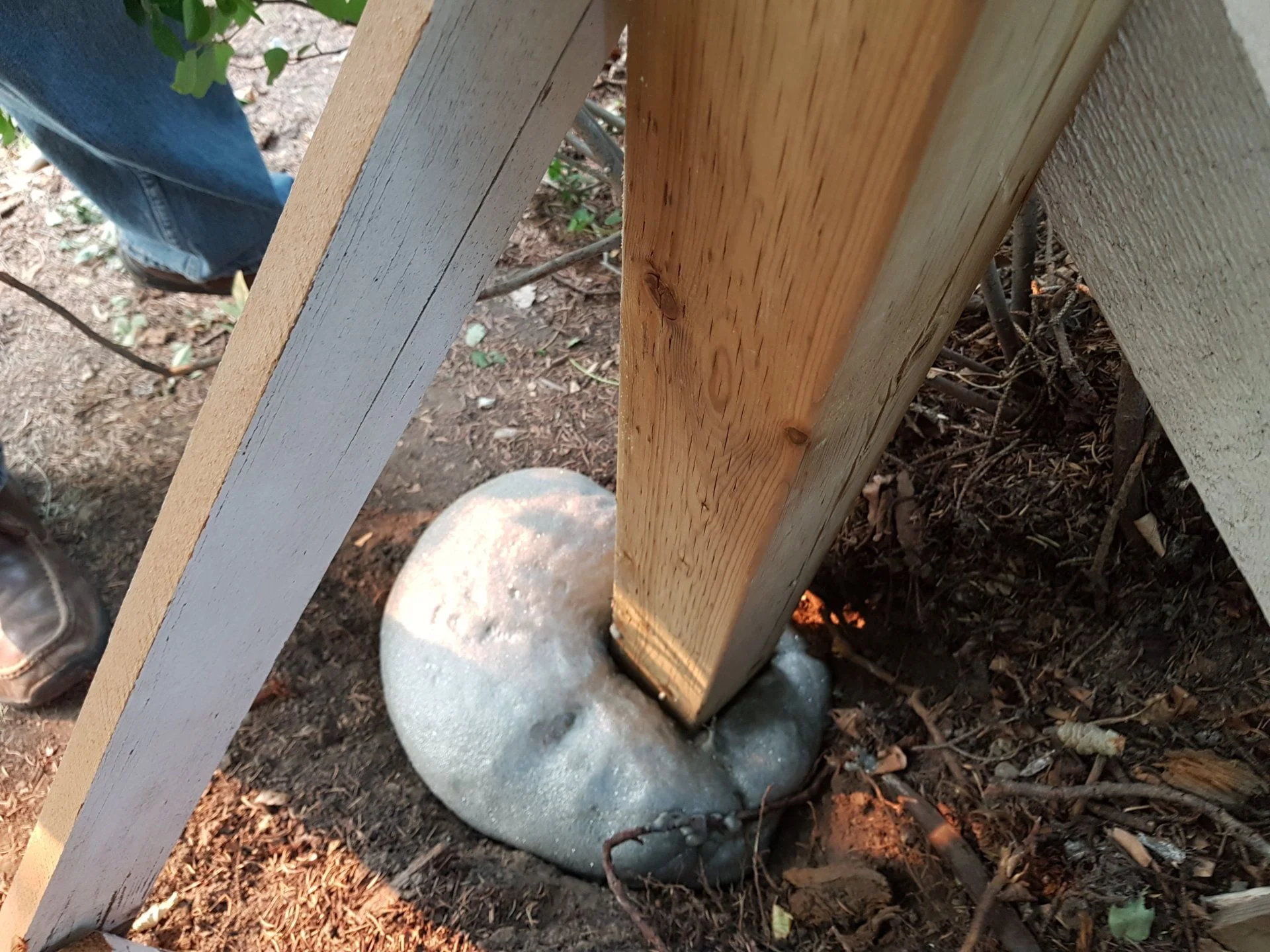

I mixed the two parts together for the suggested 20 seconds and the bag got hot and swelled up so when I opened the corner it streamed out like a shook up beer. All over the ground and trees and plants. I managed to get enough in post hole only.
I got a second package for the remaining post and it worked out great. I didn't mix it as long and as soon as the pack started getting warm I cut the corner and poured it in to the hole. It was too much and I had to trim the mushroom off so to speak.
Seems like a good substitute to concrete. Same or less price. Lots less work. Sets in a 1/2 hour.
Your posts have to be set exactly as you want them because there is literally only a few seconds before the foam starts to set and adjusting the post becomes impossible without ruining the foam.

So, what failed? One potential issue I'd see would be UV resistance - many of the foams aren't. I also see in Kevin's photo a crack around the top of the post in the foam that would let water down in - which could deteriorate both the post and the foam. I could see it possibly loosening up over time with that.
I looked at that and considered cutting the "mushroom" down further until I got to a spot where the foam was tight against the post. I don't expect that to be a problem though I will be watching it.

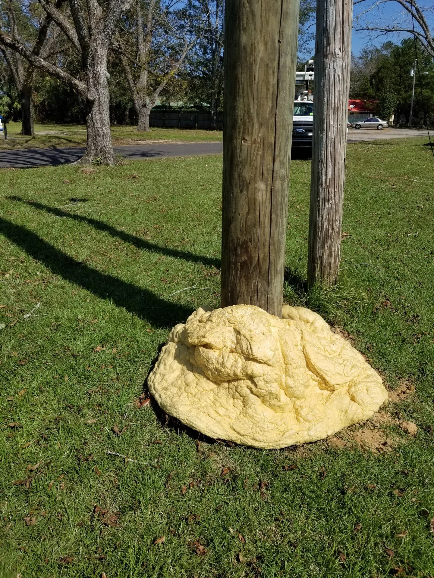

I have seen foam used to install telephone poles after storms tear them down. After they left a mushroom of foam kept oozing out of the hole, but it is still solid to this day.

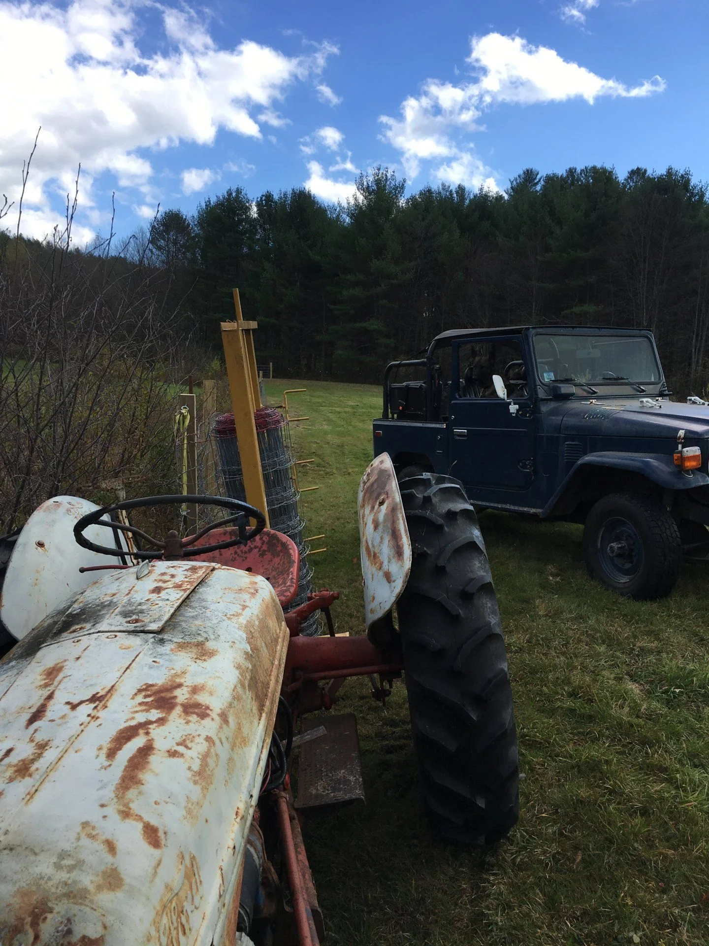

Yep, I've done the same thing with 6 x 6 posts on my property, and they've held up great. Some of the 6x's have gates on them (with our friends kids climbing on them like ladders), and others are anchor points for long runs of horse fencing that I tensioned pretty tightly. I'd be a little nervous about using foam in a situation like that.
Some pics of when I was installing the posts and fencing. Luckily, a buddy with a tractor and auger helped dig the holes out for me, about 3' deep.
