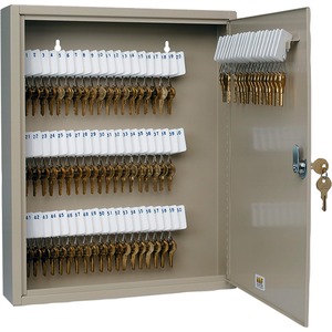

~Basically something like this with the edges not folded in but around so it can either be tig'd or riveted into place..
or this..then maybe just make the flange??
