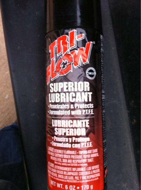

Make sure you keep those heims lubed! I use motorcycle chain lube
TriFlow.
Only lubricant that immediately dries, yet still keeps them quiet, but, personally, I wouldn't use until they complain.
I emailed Dan at RS and asked if these heims need to be lubed as they are teflon lined. He said they don't need it. Are you guys saying to lube them anyway?
Every link or UCA I've ran stipulated the same, that they need no lubrication, but they've all eventually squeaked.
"Race car parts make race car noises" was the typical reply to others queries regarding the squeaks, but I don't care much for sounding like the Clampett's, nor enjoy hearing, so I threw caution to the wind and sprayed with Tri-Flow to quieten them down.
TriFlow is typically found at high end mountain, or road race bike shops . I used on a dune quad, since it dries rapidly and leaves no residue, the sand wouldn't stink to the chain, nor the control arm joints ( which were also noisy ), and carry in the FJC, so that I can immediately quieten the complaining when necessary and during routine service intervals.
In your case, wait until they squeak, in keeping with RuffStuff's recommendation, and know that when they do, there's a product that'll shut them up.
Ain't broke, don't fix it, methodology.
Thanks Chris! Having ridden both mountain and road bikes for the last dozen years, I am very familiar with Tri-flow and have some on the shelf. Since I am in SoCal with a dry climate, the Tri-flow makes the most sense, plus it's not a "dirt magnet". If it doesn't hurt, then it sounds like there is no reason to wait for squeaks.
