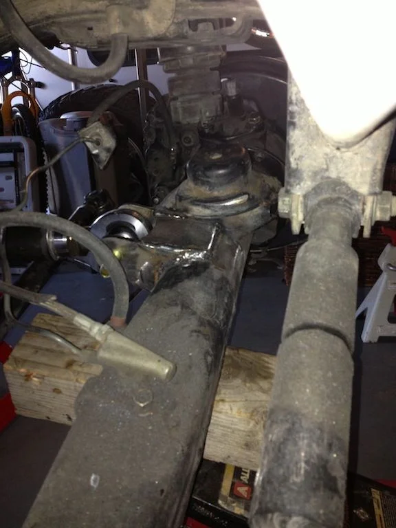

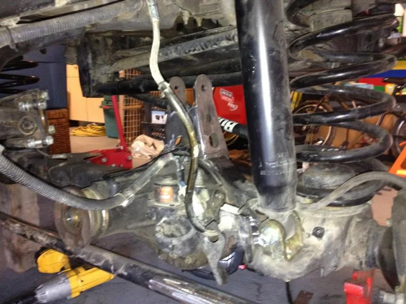

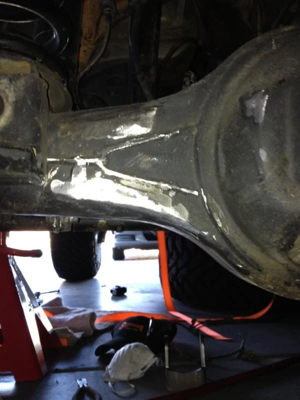

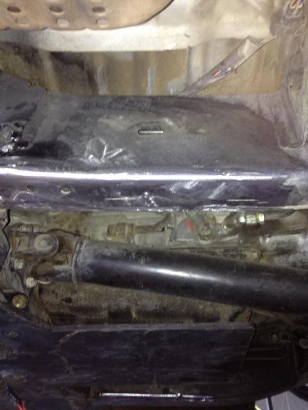

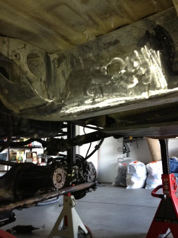

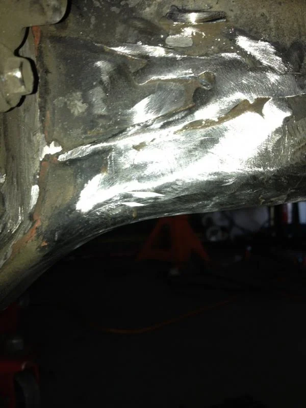

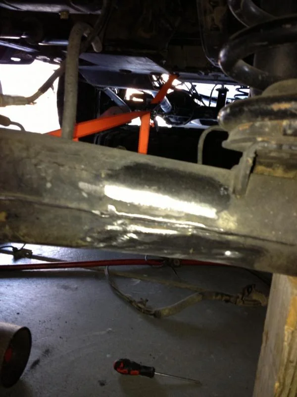

Got the rig set up after work one night last week and got a head start by removing the radius arms. Today, the goal was to remove the radius arm brackets at the axle and the frame and grind smooth as prep for the new mounts. A lot more work than expected, took me six hours with a grinder W/cut-off wheel and sawzall. I cleaned things up with the grinder and die-grinder with sanding disc. Man this kicked my A$$! I must be getting old :D

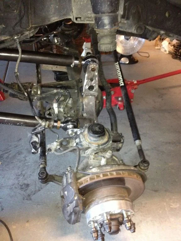

Here are the results of today's hard work:
More pics of today's progress:
Are you seeing need to reinforce the housing simcha the stress points will change?
Right now I don't plan on it as I haven't see it on any of the many threads I've been looking at. But I am going to be open minded and be willing to take suggestions as I build this up. Once I get all the mounts and links ready to weld up, I will just tack in place and take lots of pics so I can post up. If anyone sees anything drastically wrong, I hope to hear about it.

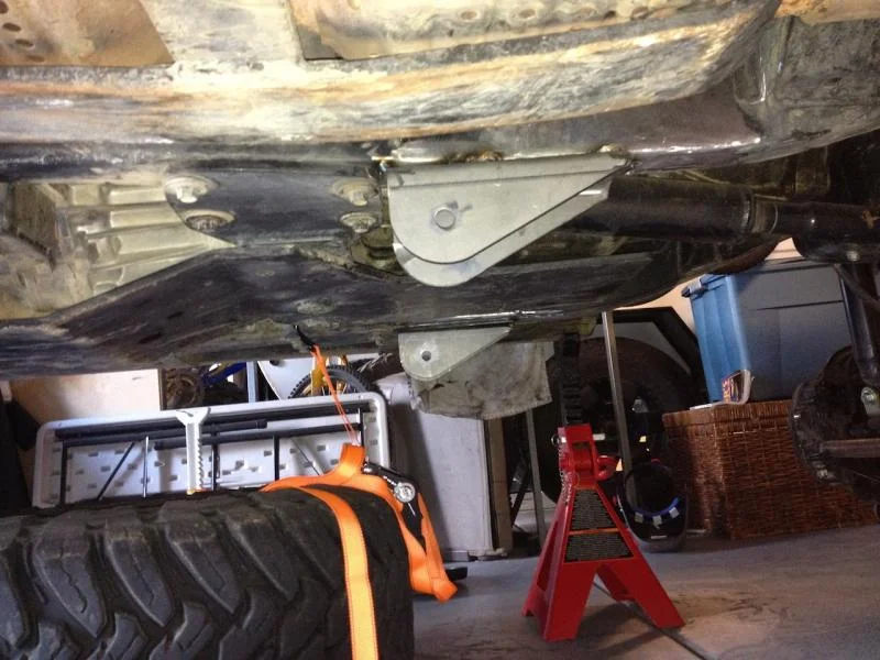

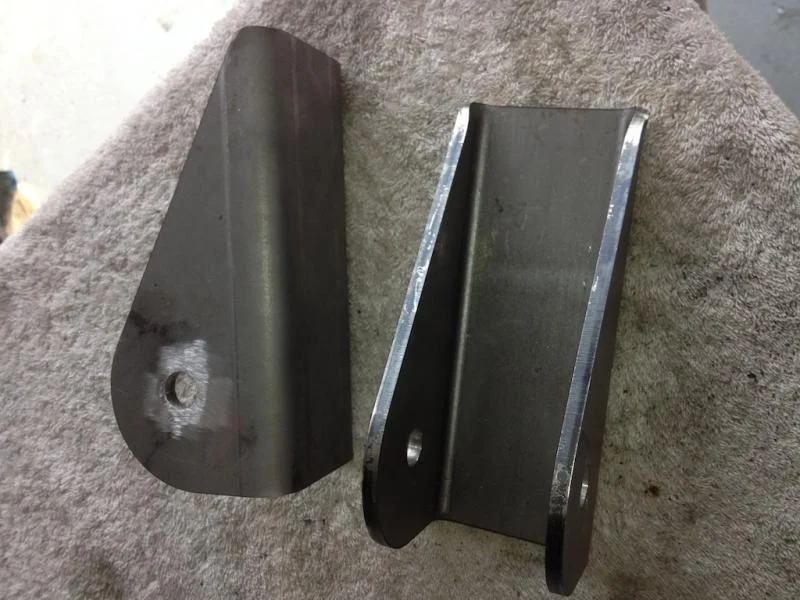

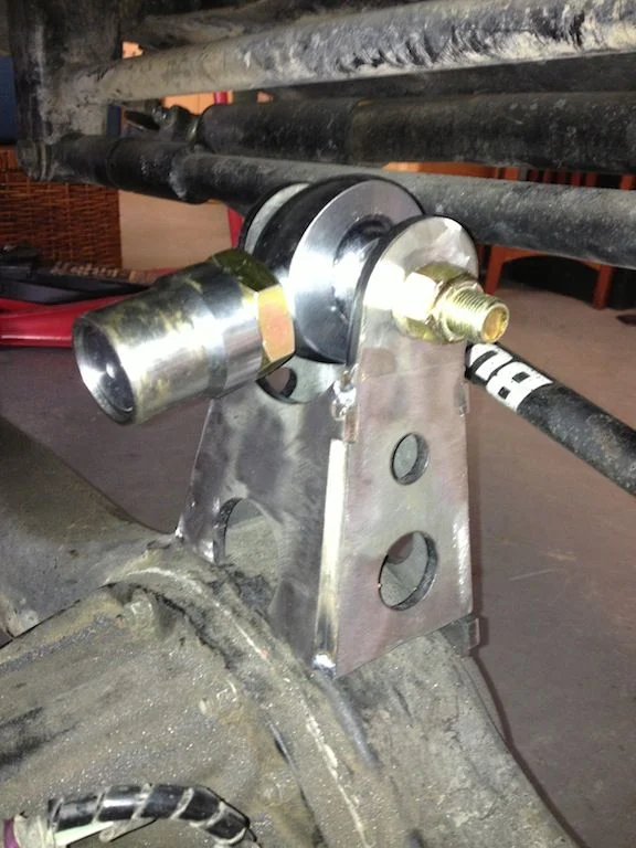

Yes, I am using the 3-Link Kit from RuffStuff. A slight modification is required for a good fit on the axle mounts and link tower. Here are pics of the 3rd link tower just tacked up and being test fitted and the frame mounts for the lower links.

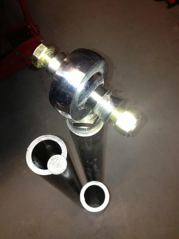

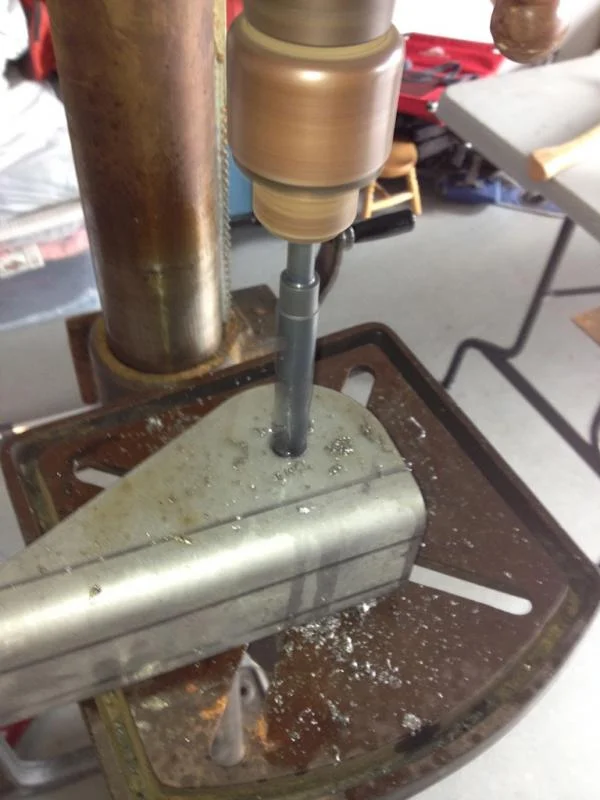

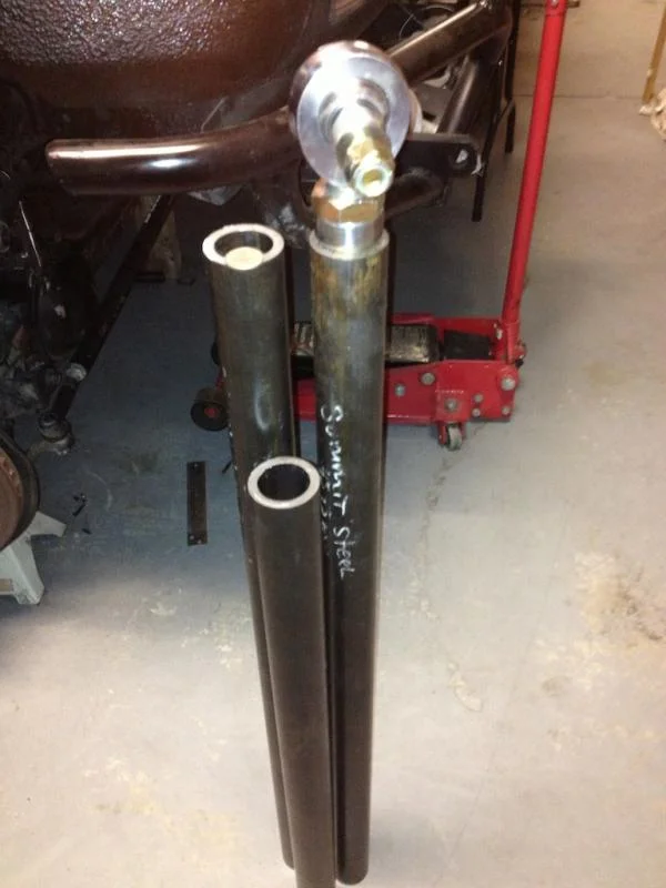

When I purchased this 3-Link kit, I upgraded the hardware from 9/16" to 5/8" so I had to drill out all the holes. Also picked up my .250 wall 2" DOM. Man this stuff is heavy duty.
Well, I didn't quite get as far today as I had hoped. Started with drilling out all the bolt holes for the upgraded 5/8" hardware. Then, after welding together the 3rd link tower, getting it to fit nicely was quite a chore. Finished the day welding it on and tacking on the lower link frame mounts.

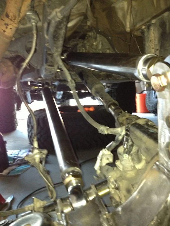

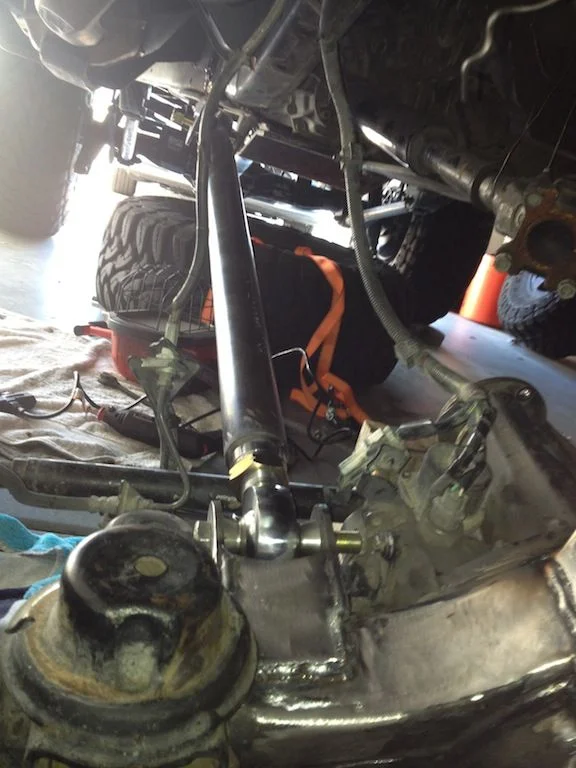

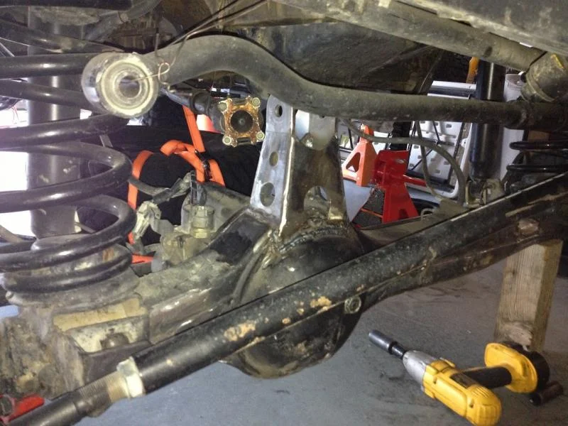

So yesterday I finished up the welding, starting with the lower link axle mounts. The PS mount is a tight fit. Even with the mount welded tightly against the OEM shock mount, the bolt would hit the front locker actuator, so I had to trim about a half inch off of it. The DS axle mount has plenty of room, just had to pull the hard brake lines out of the way. Then I moved on to the upper link frame mount. I temporarily attached the driveshaft and links to test out the flex to make sure there was plenty of room and no binding. Everything looked good. Pulled off the links and finished the night welding the bungs to the tube.
Today, I will prep and paint and hopefully get it all together so I can post up some flex shots. Here's a few pics of the progress:
