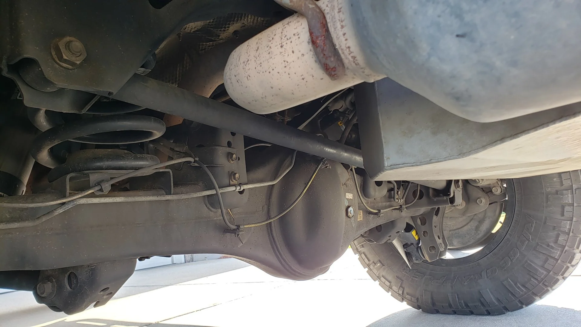

@mbennett22 how much total lift are you at in the rear?
Edit: also, can you measure the angle of your panhard rod from horizontal?
@bloc Honestly I'm not sure, I think I got the 2 inch lift however the 2724 coils say they are .75 inch lift. As for the panhard bar I'd have to figure out how to measure angle haha. I find it odd that more people are complaining about the rear sway. It is pretty significant.

You can get a digital angle gauge for pretty cheap online. Just zero it to the ground you are parked on then set it on the panhard.
Looks like more than 2” to me, but I’m not there with a tape measure and maybe you are referring to loaded when the pic isn’t.
I will say that the angle to lift relationship isn’t linear. 1”, not much change. 2”, more than 2x as much. If you are at say 4”… very significant change in angle. As for how much angle is too much.. maybe a good question for the people developing brackets.

@bloc what do you think about this angle?

@bloc what do you think about this angle?View attachment 2956559

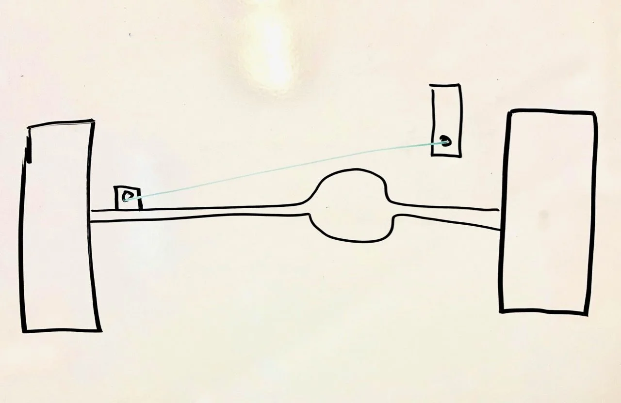

Also, here's a thread about the "wiggle" that the 80 folks have fixed with a bracket and explains how that helps. (Check it out if you haven't seen it yet.) And the embedded youtube video is really good and helping visualize the issues with the geometry.

Watch this video for an explanation of the issue. I’m not totally sure the exact angle that presents problems but as the video makes clear the further you are from totally level the worse the problem will be, and it doesn’t take much.
Adjustable panhard, or one bent on the ends, makes no difference for this issue. The only fix is to have the ends as close to level as possible.
