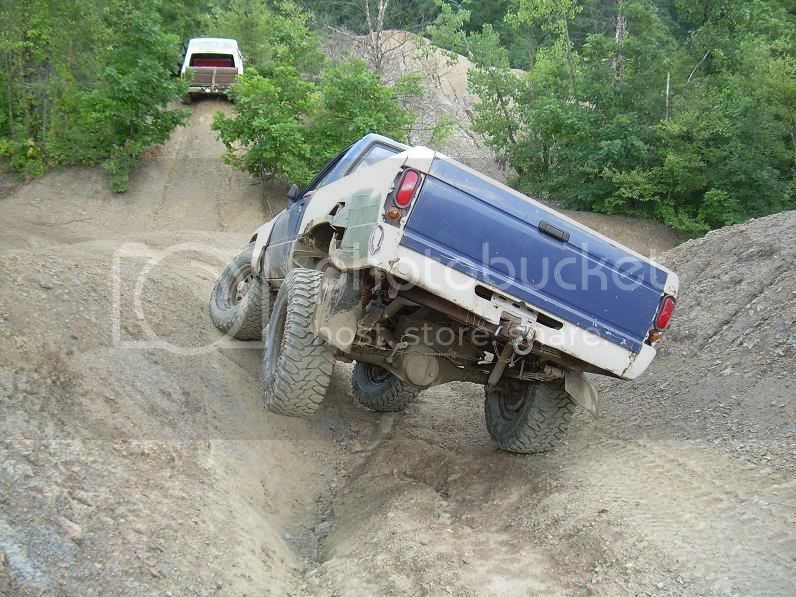

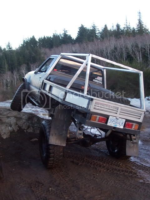

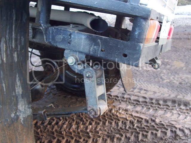

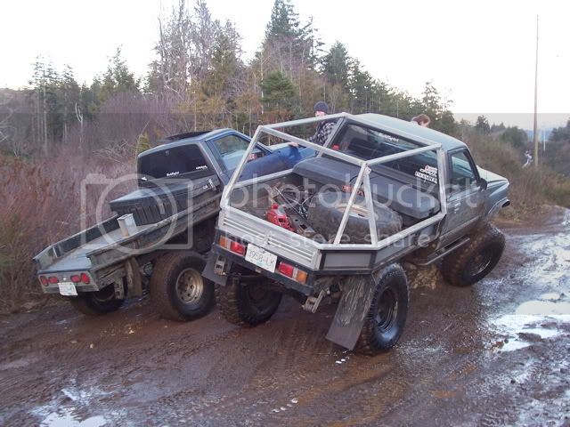

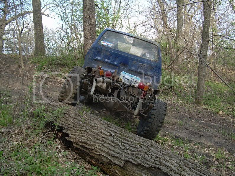

these are the best pic's I could come up with. They actually work MUCH better since I have moved my shocks inward, the way the stock shocks bolt up are really bad for flex
