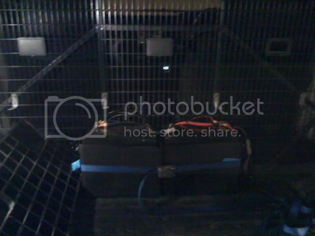

Here is my 24V battery senario:
I reckon my battery system is reliable however there is something NQR about it. Symptoms:
1. Battery occassionally spills it guts/water used in a few of the cells. Usually the ones closest to the terminals.
2. Charge voltage fluctuates between 26.5 to 28.5 volts depending on the engine load.
The RedArc battery isolater does what its spose to. Switches over to charge both batteries at around 27 volts. One thing I find interesting is that when I start the BJ74 for the first time in the day the cruiser will start and then the volts will drop. They slowly go down to maybe 17 or 18 volts. If its at night the headlights and dash will be dim and the dash volt meter will slowly fall aswell. Then after idling for a minute or two the volts will suddenly rise to 25 and slowly charge to 27 when the islotater kicks in. Do any other 24V cruisers drop volts on start up?
I monitor my battery system on this dual voltmeter:
This is what it reads with the ignition off.

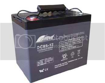

I will now also go with a deep cycle for my 12V needs.. I am using lead acid batteries.. is that ok? should be yeah? they are definitely not AGM's
So, i took the 'faulty' battery (the one that was shorting out my charger) into the store yesterday and it failed, ca-put.. so they replaced it thankfully.

Hi Iain,
If you look at my wiring diagram in my first post you will see I'm not running anything off my starters
except what Mr Toyota wired in when he built my cruiser. I have two 24V battery banks. One to start
and one for accessories. Redarc make a battery isolator that is for 24V vehicles (SBI24) this is wired
between the banks and acts like any other battery isolator. My system is exactly like a regular 12V
setup except that its 24V (two batteries each side). Two wet cells to start two Fullriver 85 AMP AGM's
for fridge and acc. No probs with this setup after 18 months, just that the starters were damaged by
the PO. I think I saved them but I want to up grade the starters now causes there not 100%.
Here's the wiring diagram:
Here are the aux batteries the starters are under the bonnet:
Two of these bad boys:
