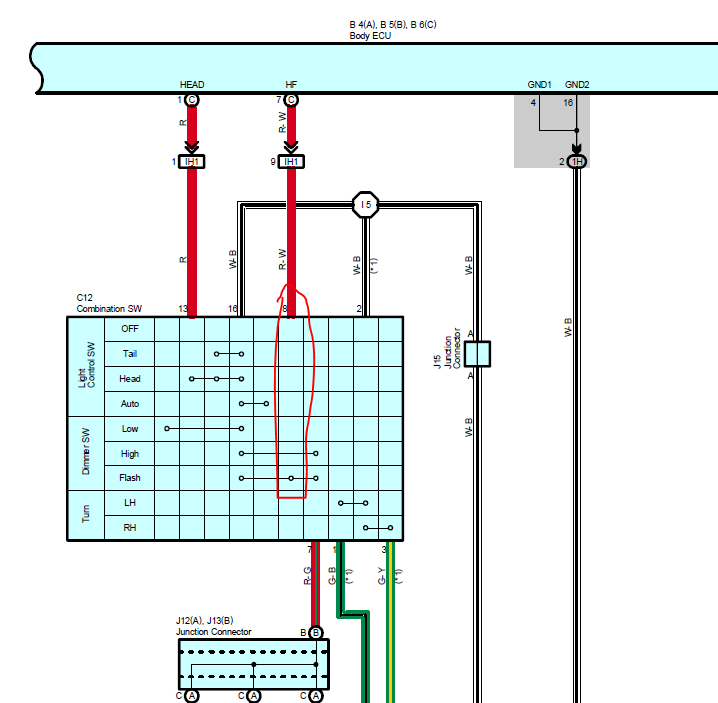

Strange thing happening on my '03 - high beams don't work when you push the stalk forward. When you pull it rearward the flash to pass high beams + low beams work like normal.
I do have one issue that is currently unresolved and that is that my dome light fuse keeps blowing. I looked at the EWD diagram but wasn't able to figure out the connection between dome light fuse and high beam.
As you can see from the EWD, flash to pass connects the terminal HF from the body ECU. I need to understand what is HF as it is not in the abbreviation list.
