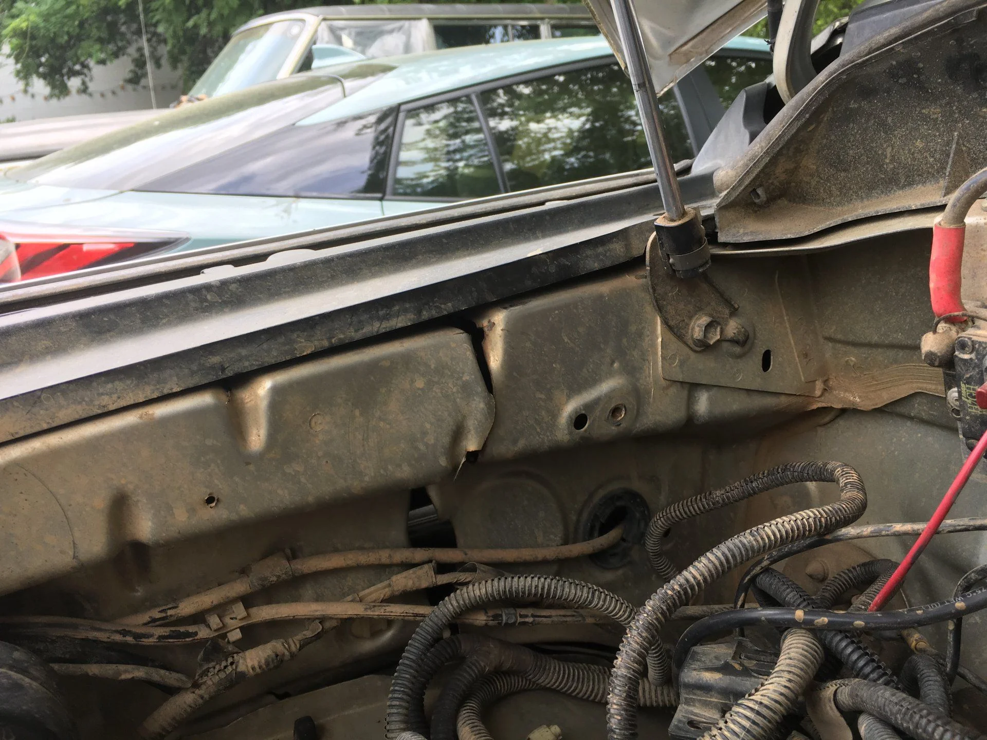

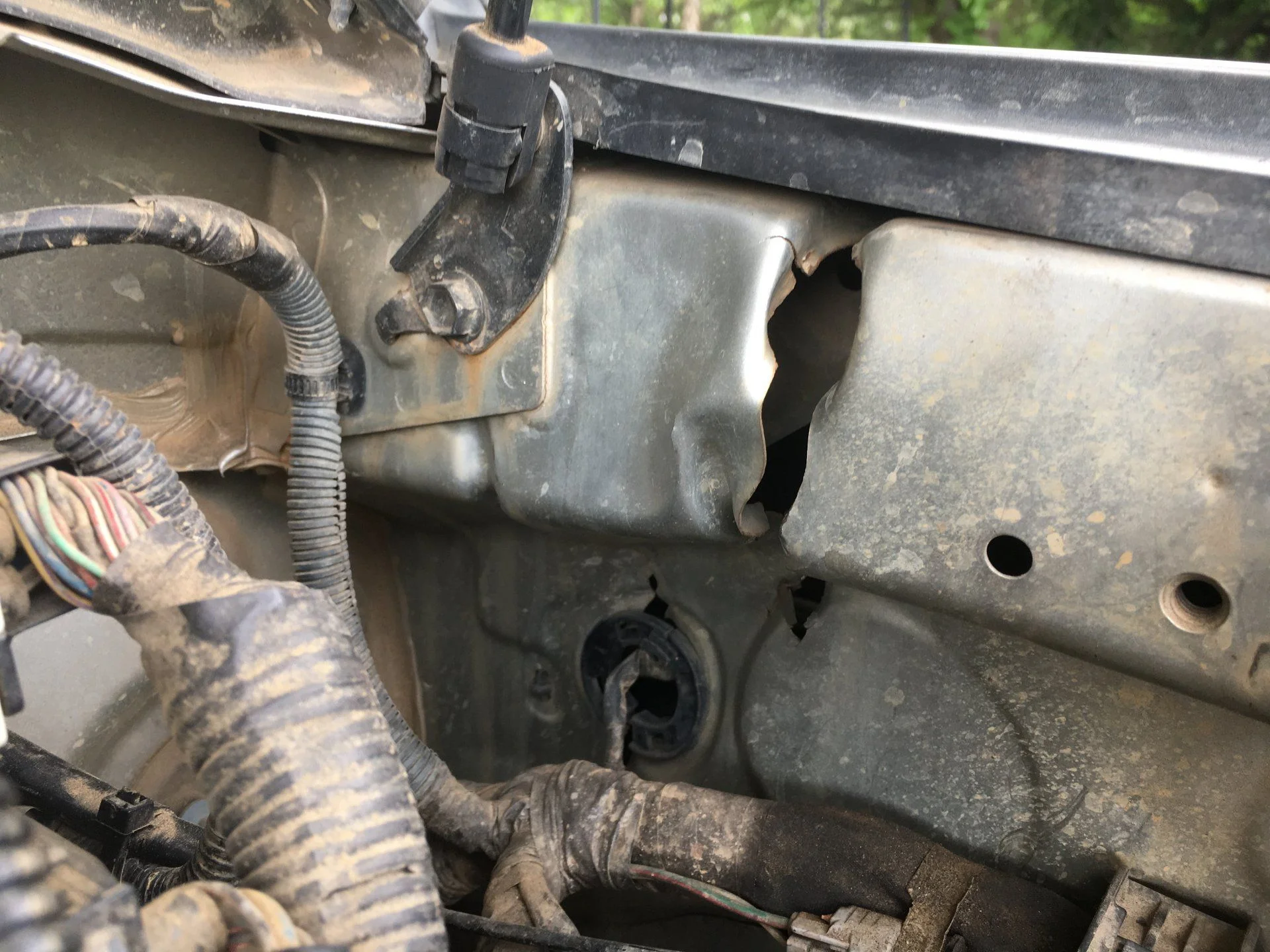

I had the bulges within the first year of owning (build date 06/2006, purchased 07/2006). They got worse with my rig being a dual purpose DD and weekend warrior. I always said I would just drive it until the fenders fell off... the rips had gone all the way to the wheel well. Well, earlier this spring I had to do something about it, and I paid to have inner fenders and front apron replaced. The front end had dropped enough that latching the hood was a concern.

so 12 years and 170K miles ( i think you said thats how many miles you were at on another thread) later you finally did something about it? don't think its worth loseing sleep over...:meh:
Mine was made June of 2006, has around 82K on it, and zero cracks.
Lotta weight too up front with two batteries, AB bumper, Hi-Lift on the bumper, Warn XD9000, no cracks for me.
