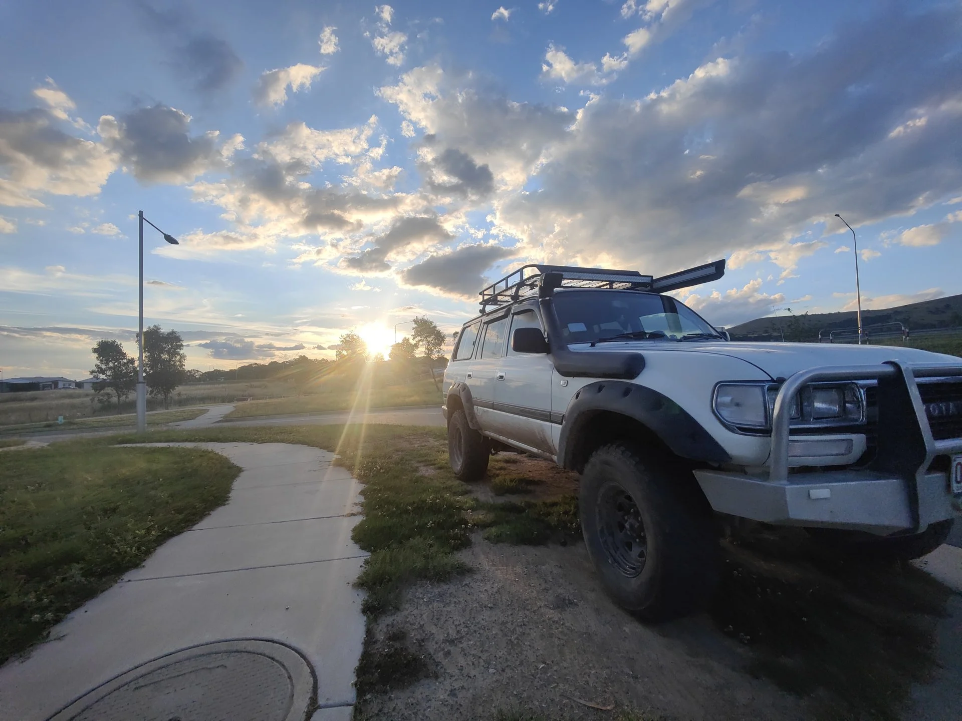

Does anyone have any ideas about replacing my 3fe exhaust all the way through cannot find anywhere that sell anything for them only 3f ? Am I better just getting full custom exhaust ideas please sick of the cruiser sounding like it's straight out the manifold also my exhaust is rooted cats are rusted and all bolts
