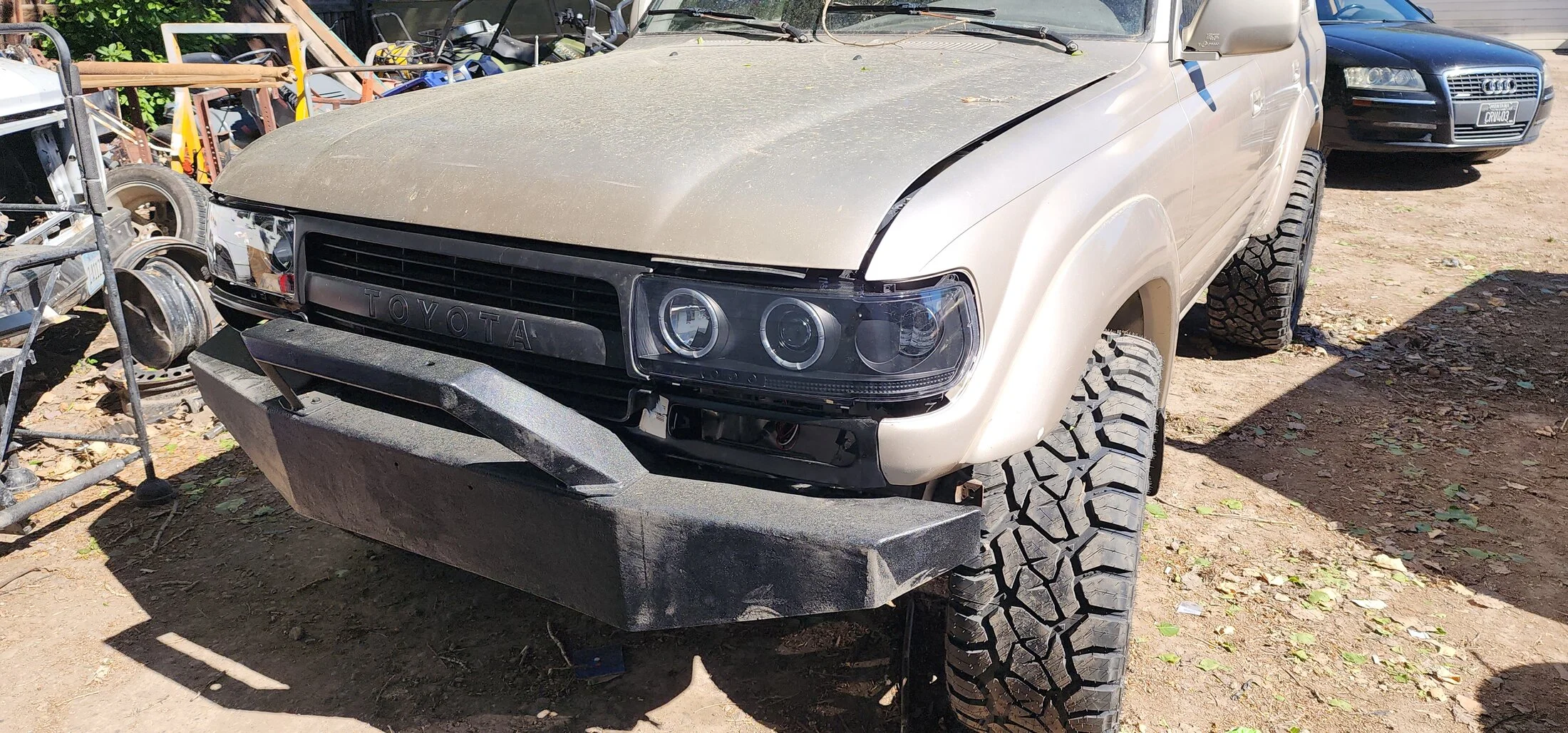

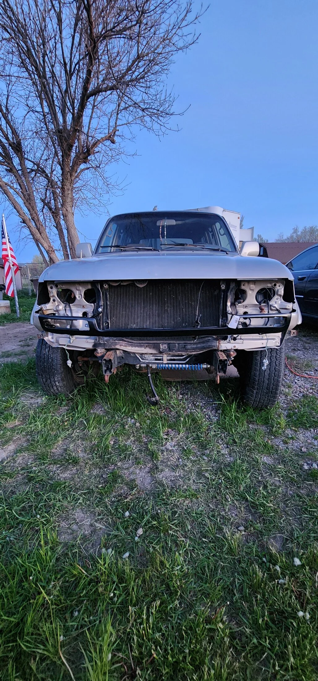

Hi all.. trying to finish the 1st phase of my '92 FJ80 deer hit build.. pulled the rad out of my '91 that I rolled.. got it in today & got it filled up only to detect a waterfall at the upper inner seam leak.. ugh.. I need a new rad + shroud + pulley... I don't want to go with plastic rad.. any sources for aluminum?? Also any suggestions for a "package" of rad / shroud / electric fan?? I see them for the FZJ80... will these work in a FJ80??
Cheers & thanks in advance

Maybe consider having the existing radiator rebuilt?
It will be about $500, with new core, existing tanks. Assuming it's a metal radiator already there....
A 1FZFE radiator/shroud/fan/fan clutch will not work for the 3FE.
If you search this forum, there are several aftermarket radiators that will work, but some are better than others.
Fans/shrouds have been discontinued by Toyota, but are available from some of the Land Cruiser specialty shops you can find on here.
The OEM Aisin green hub fan clutch can be found on Amazon and several others. Do not use a different manufacturer for the fan clutch. An Aisin FCT-049 is what you want.
