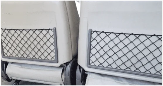

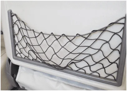

This:
1946190
TO THIS:
1946191
Please see the attached PDF file for complete details:

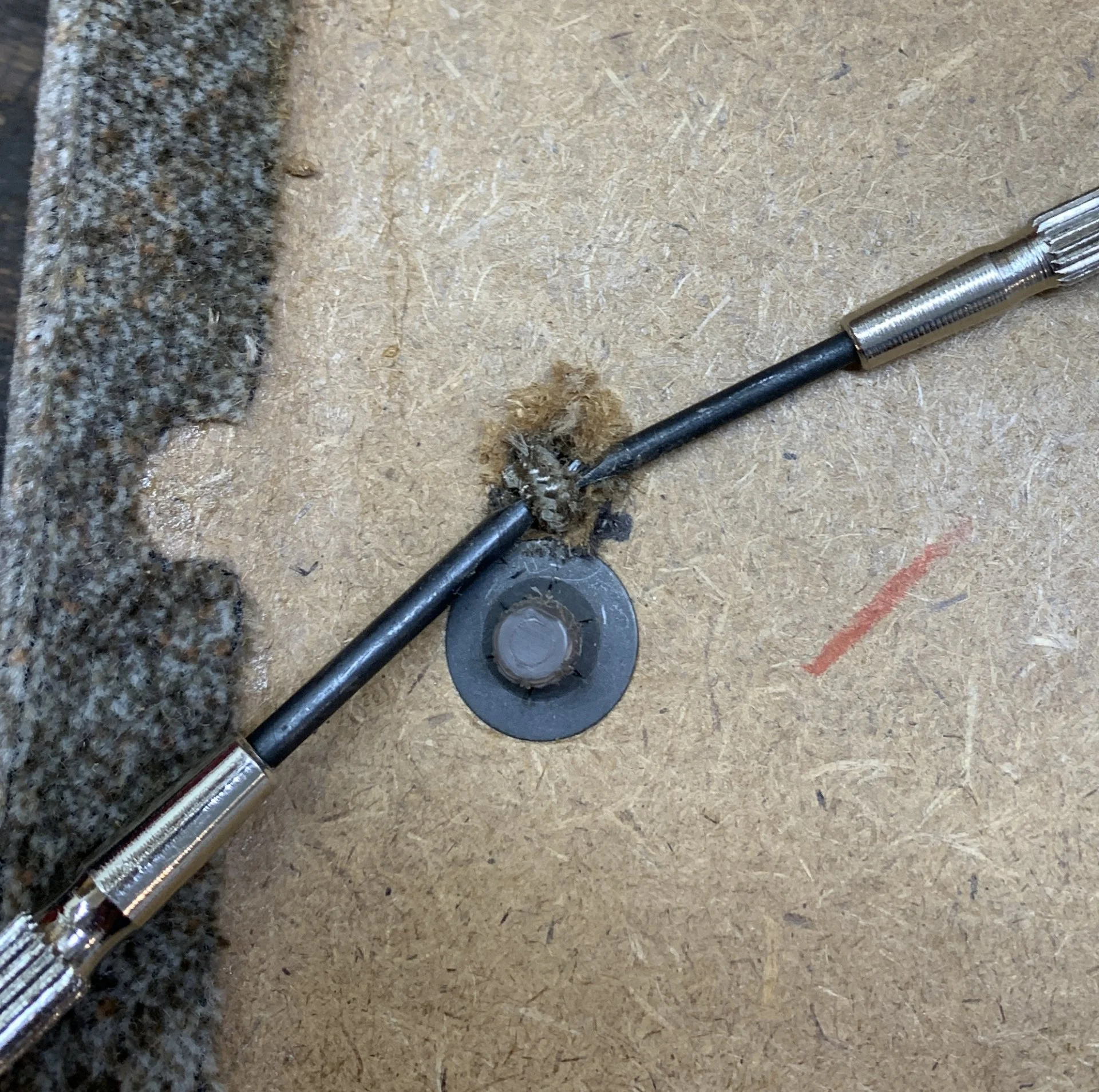

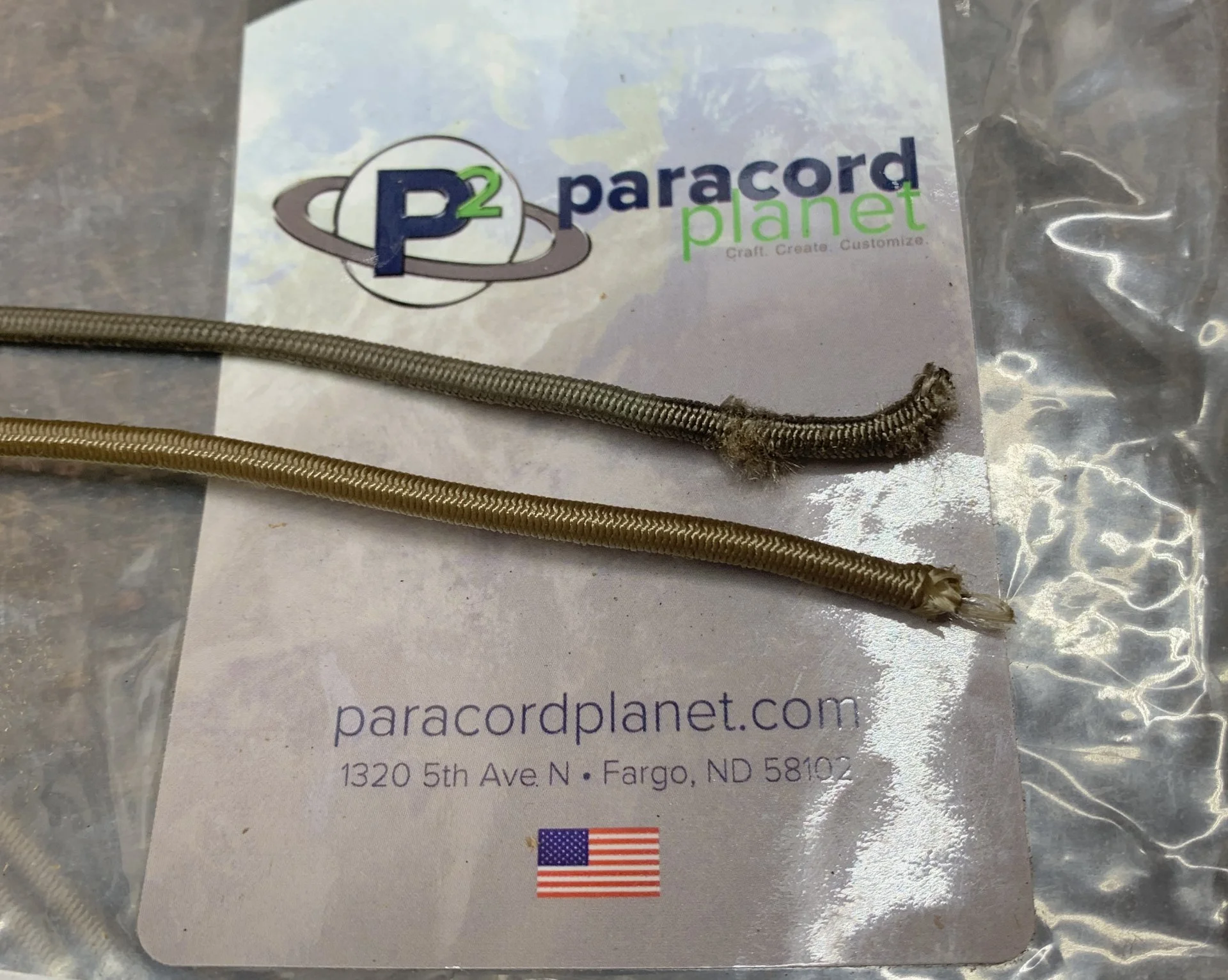

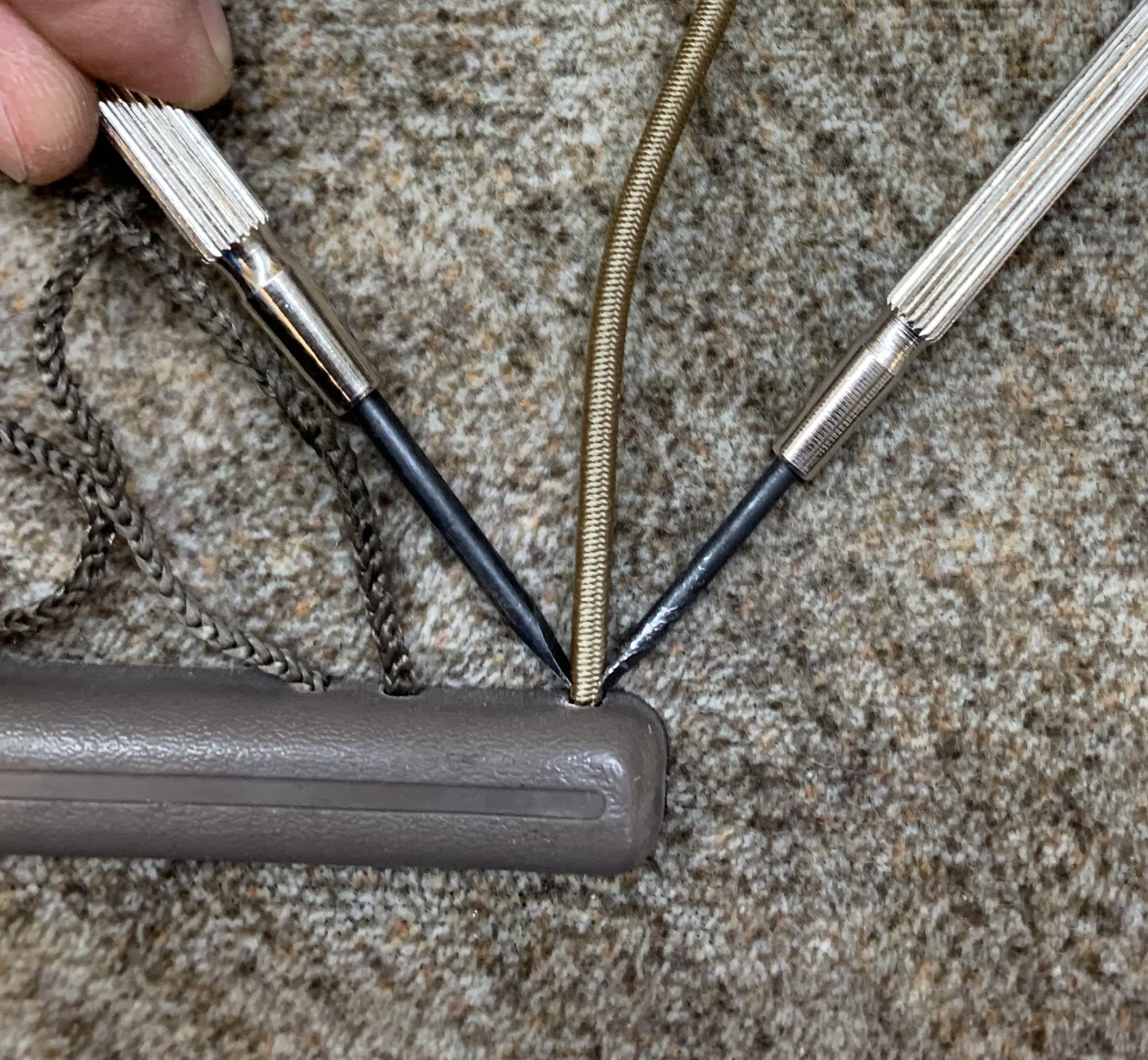

I have a 1995 which has a different seat back design.
To remove the seat back, there are two screws near the top under plastic caps. Pop the caps off, remove the screws, and lift off the back. I drilled a 3/16 hole above the top push nuts and was able to pry out the end of the old cord with two small screwdrivers.
Then I inserted the new cord through the outside hole and pryed it up the same way as the old cord.
Put a washer over it and tie it off. Repeat for the other side and done!
I found some brown bungee cord on Amazon for $10. Close enough for my multi-brown interior.
