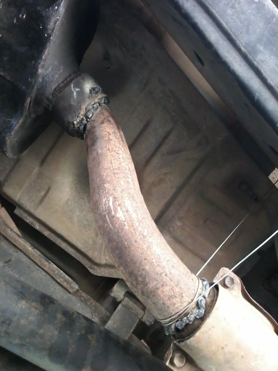

Hey guys just welded a used Flowmaster and deleted cats on the stock 3FE pipes. Sounds pretty quiet. Stock muffler blew out.
