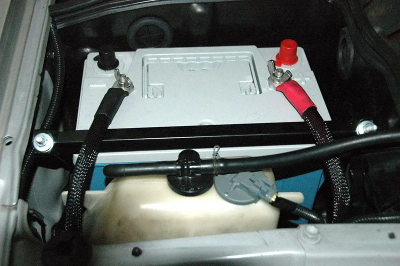

So it's been like 2 years since I've had my 80 and I never noticed the battery had not tie down until now... :doh:
I was looking and I don't see any holes where J hooks would go to hold down the battery. Am I blind and missing something? How should the battery be held down on a stock FJ80?

Yes, u are blind; no , just kidding. There is a angle that fits the front (front of cruiser) of the battery and two j-bolts; one to the right fastening to the battery box and one to the left fastening to the left front fender.
here ya go
attachment.php
here ya go
Thanks! Exactly what I was looking for. :clap:
Did you source that from toyota or did you just make some brackets from the local hardware store?
