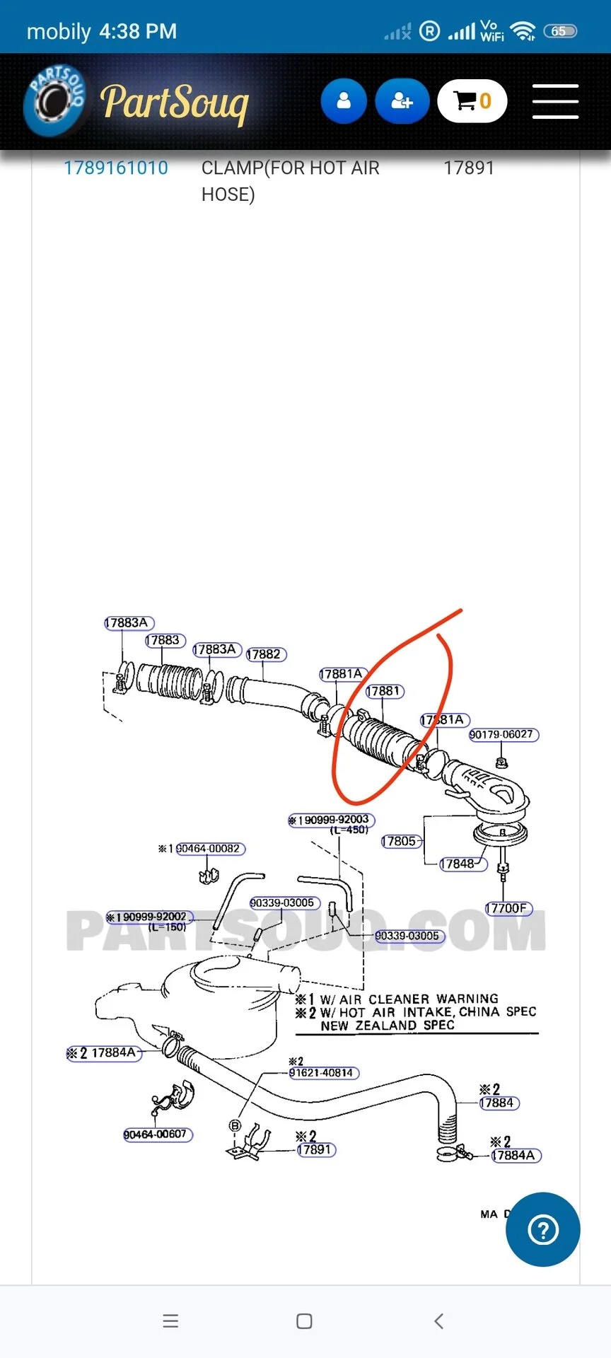

Thanks, I saw that one, but the part numbers don't match up and it says for 3FE engine... Will that make a difference? I'm super newb at this and nervous to jump and buy a part that won't fit...Search is your friend

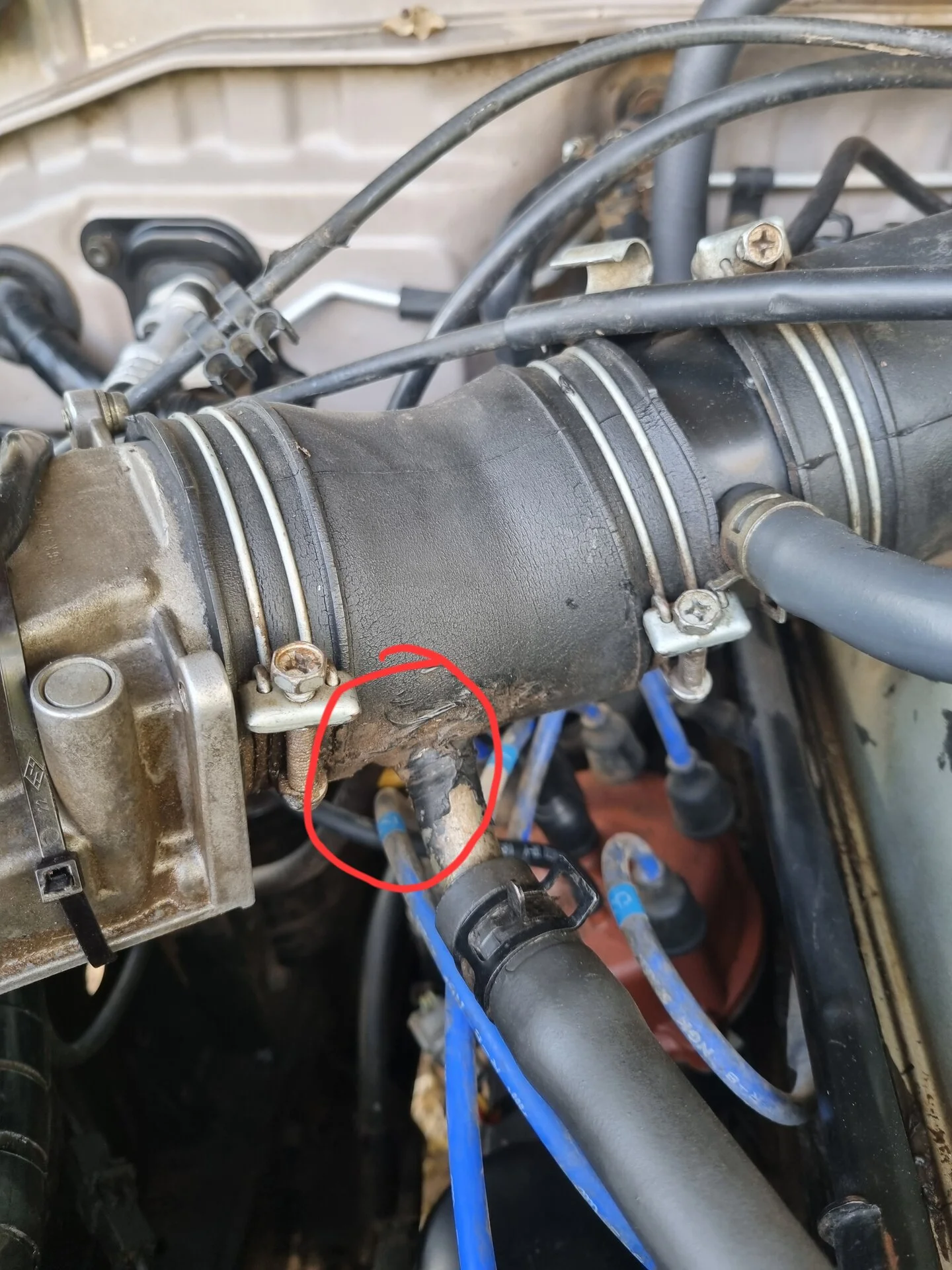

cracked hose, 3fe air intake
hi guys, noticed this crack[was glued once] see pic, i think ill just glue/seal it back as i dont think its super critical [ returning gases from the engin i assume]. any suggestions? ----btw-----, is there a place/link where the componants or modules are explained? the manual is not that great...forum.ih8mud.com
I didn't realize you have the 3f engine. I was thinking you had a 3fe... maybe @jonheld would know if the air hose would be interchangeable or made to work between a 3fe and 3f motor.Thanks, I saw that one, but the part numbers don't match up and it says for 3FE engine... Will that make a difference? I'm super newb at this and nervous to jump and buy a part that won't fit...
I'm going to say no. The intakes are different.I didn't realize you have the 3f engine. I was thinking you had a 3fe... maybe @jonheld would know if the air hose would be interchangeable or made to work between a 3fe and 3f motor.
goodluck.
Dang itI'm going to say no. The intakes are different.
Thanks! I'll give it a goi dont see why it wouldnt work, you really dont have anything to lose trying it other than the cost of the hose and your time
Are you in a position to order the other part number, see if it will work, then, if not return the part?Thanks, I saw that one, but the part numbers don't match up and it says for 3FE engine... Will that make a difference? I'm super newb at this and nervous to jump and buy a part that won't fit...
Never did find it.. ended up just using two of the one I could find, they seem to be slightly different lengths but fit well enoughDid you ever find a hose? Has anyone tried the Chinese reproduction versions?
