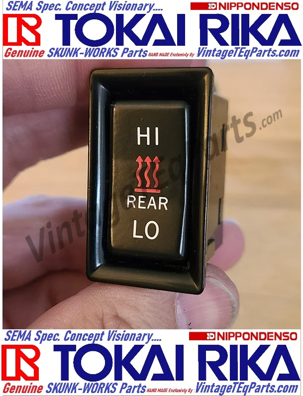

1) What does the rocker switch on the center console control? Any decal on mine is long since faded out so I have no idea what it's meant to do and/or assess if it's working properly;

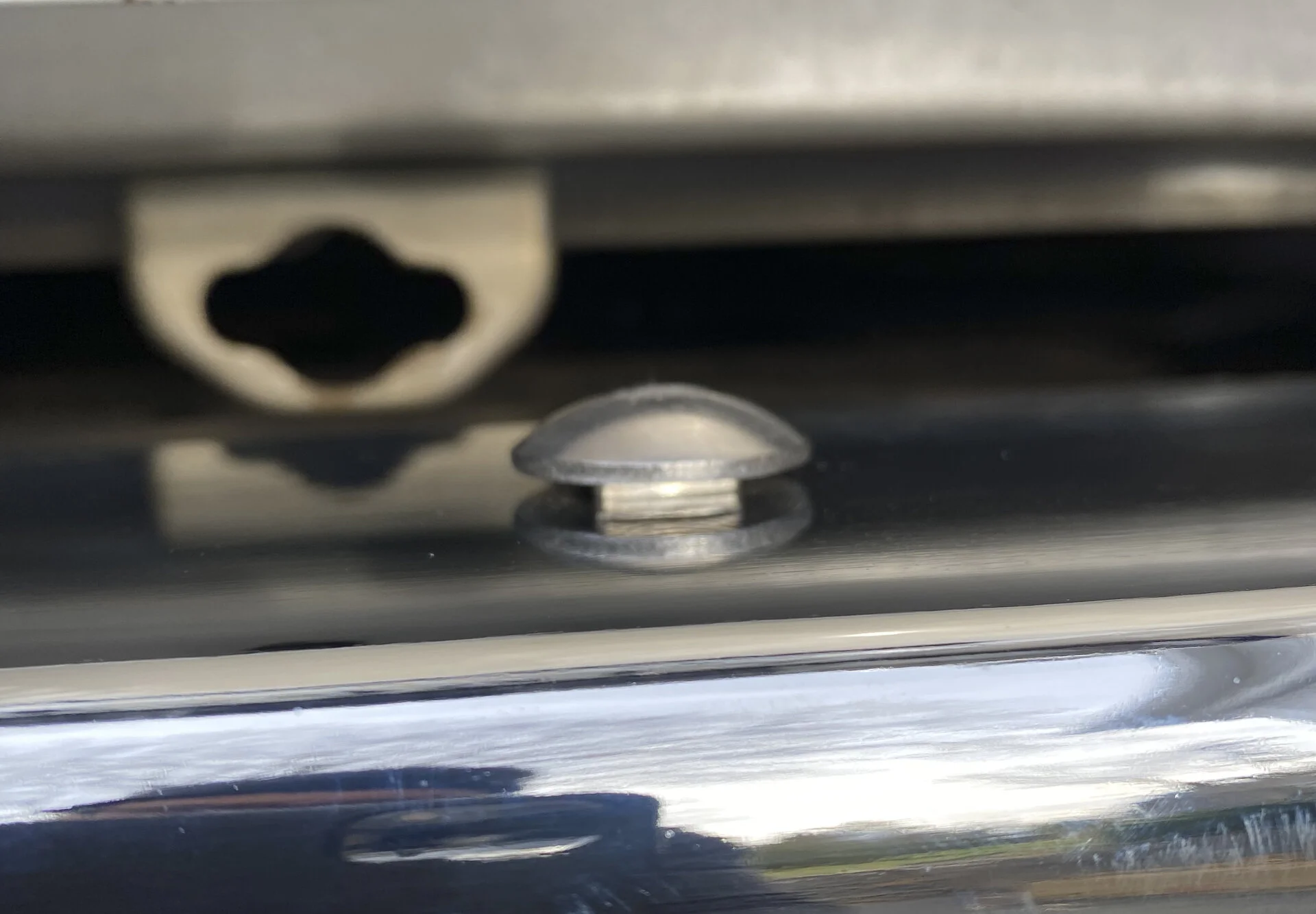

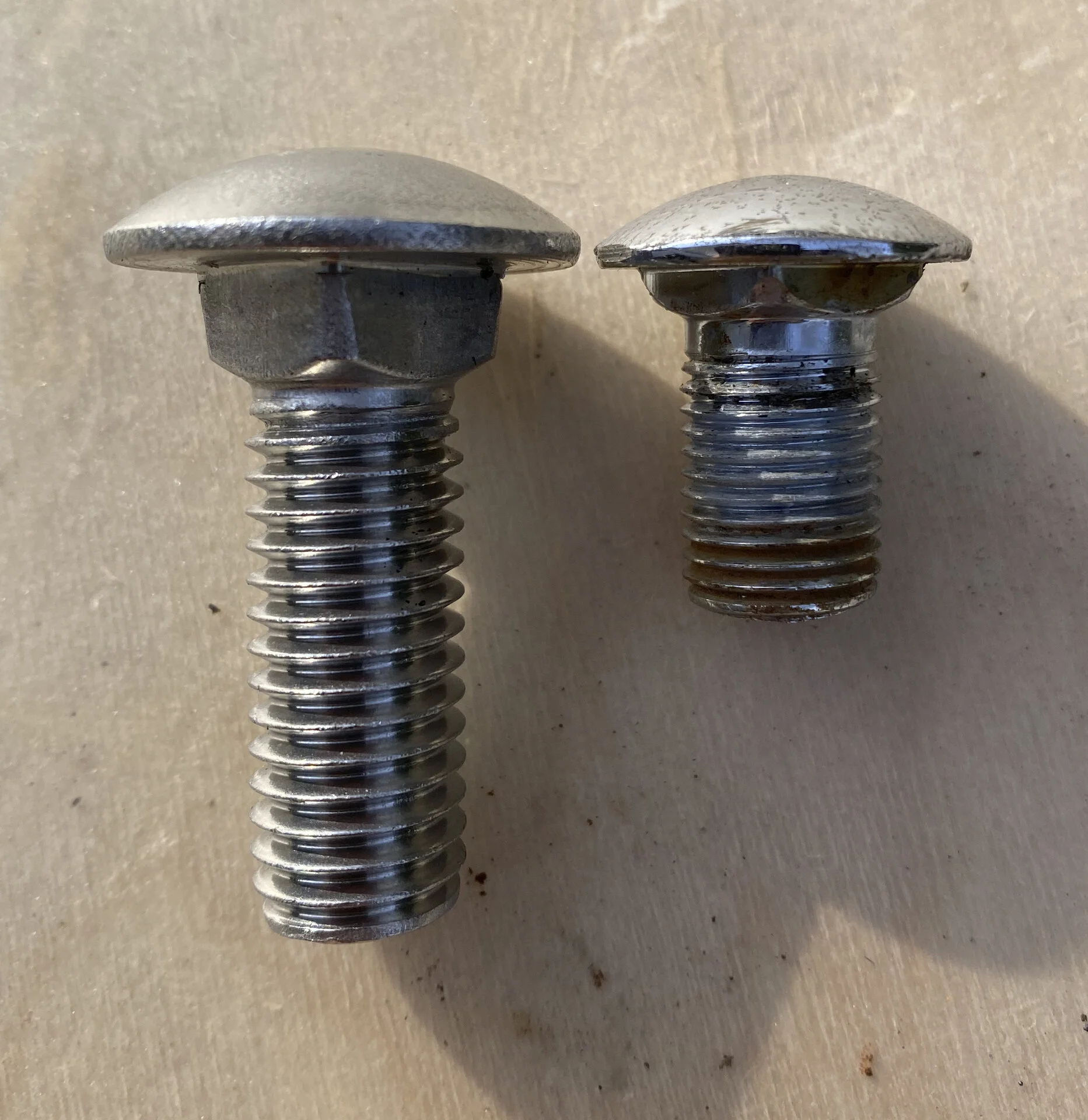

4) Does anyone know of the correct part number for the bolts at the top of the front/rear bumpers? (images below) I recently replaced the seriously dented ones that came with the truck with OEM (yay!). Bad news is that the new bolts I got from Cruiser Corps (I usually like their products but less so in this case) have an underside that is too tall so the bolts sit proud above the bumper by approx. 1/8". Doesn't sound like much but makes the final installation look very JV. The OEM bolts had a very shallow square part immediately under the bolt head. The replacement square part beneath the heads are just too tall;

• New bumper bolts aren’t available anymore
• Just about everything plastic is no longer available new. Also unique bolts & screws are pretty much all gone (like 15 years ago).
The two missing fasteners on your AC/heater ducting are push clips toyota part number 90467-05031-01.
The carriage bolts for the bumpers are toyota part number 90112-12041.
As OSS says these items may not be available.
Thanks OSS/2mbb!
I'll see what I can do to track them down. I can probably modify existing bolts to be a better fit but before I start machining/hacking each bolt, I'll see if I can find them. Same for the retainers - if I can track them down, great. If not, I'll find something that works.

Center console is rear floor heater high/off (neither side pushed down)/low
@ToyotaMatt males a replacement sticker for that rocker switch
i don't offer a sticker of any sort ?
what i do offer is a Professionally Restored and Re-conditioned inside and out FJ62 Rear Heater rocker switch assy ,
i take in your old and tired one as a core / trade-in exchange , just a starter or alternator at the Toyota dealer , same exact concept
i DO NOT simply offer up this switch outright , with out a core trade -in , because i could not continue this needed specialty service with out them
i will try to help someone however , in a PM Communication ONLY special circumstances case by case bases ...................fyi
