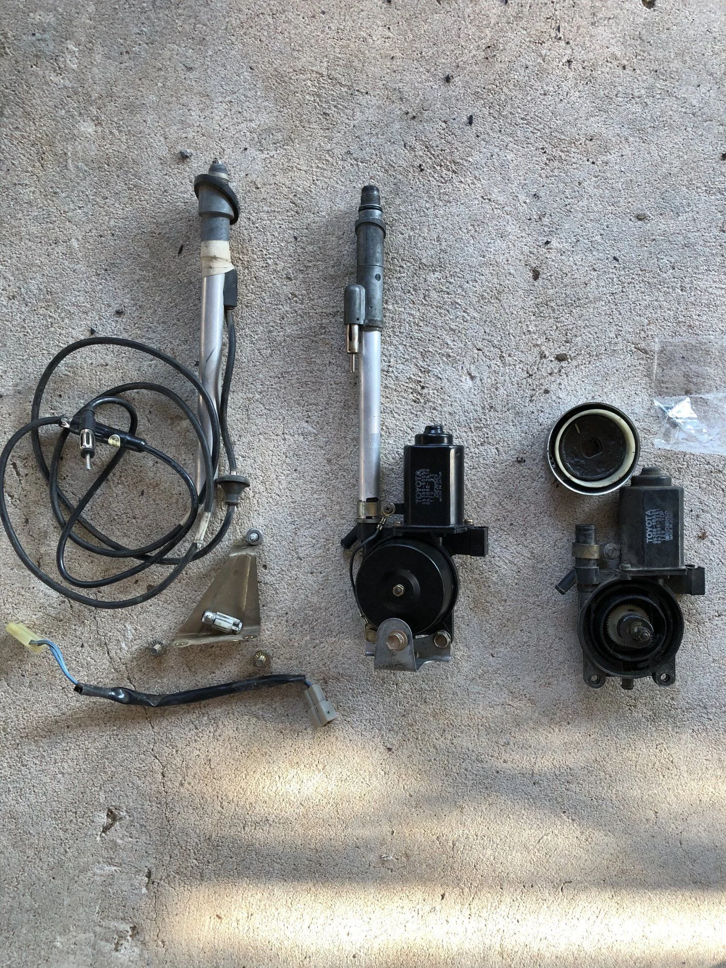

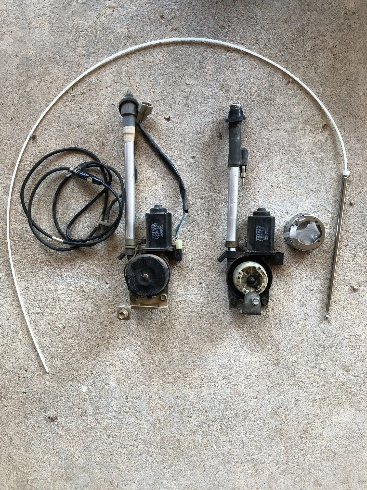

Here is a picture of the two antennas side by side. The FZJ-80 on the left and my FJ-62 on the right, with the new antenna mast kit waiting to be installed.

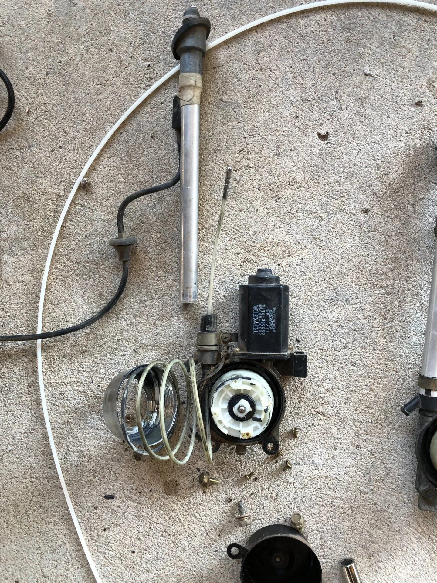

This is the FZJ-80 antenna body open to remove the old antenna and clean/prep for the FJ-62 antenna mast kit.

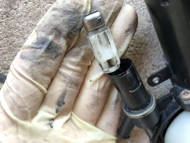

This is the little plastic piece inside the FZJ-80 antenna mast guide that I had to remove. If you don’t remove this, your new antenna mast will not go all the way down. It will end up sticking up about the length of that little plastic piece (sarcasm intended). I still don’t know if that is part of the antenna assembly or just a piece of that old FZJ-80 antenna that was stuck in there.

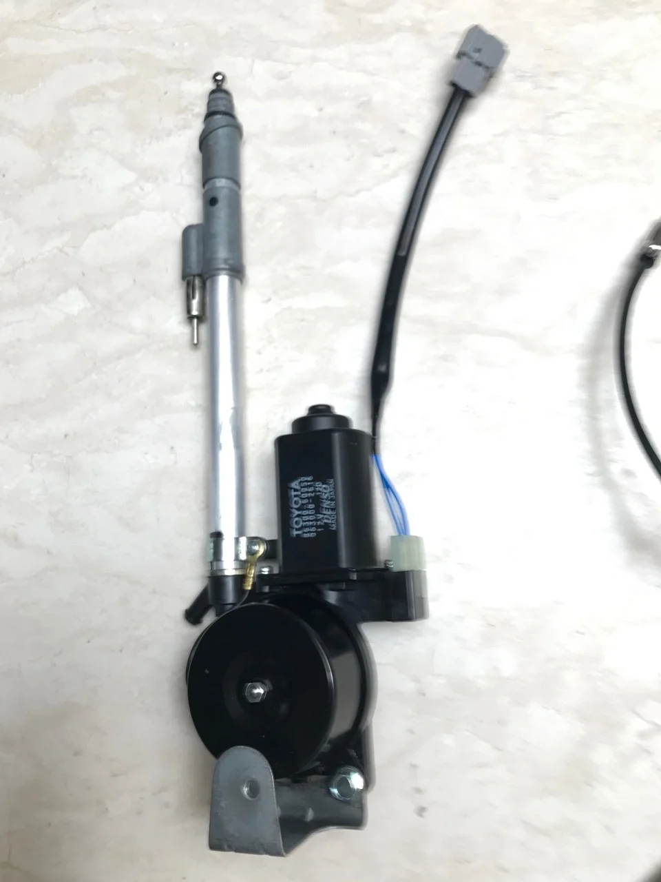

I installed the 80 assembly today which I bought new on eBay. It came with the antenna already installed so I just swapped the bracket and mast like @62Cruiser suggested above. Here's a pic of of the unit ready for install. Even though the FJ62 mast seats all the way to the base of the 80's assembly, it was 1/4" too tall and the mounting bracket didn't line up with the hole. To solve this, I cut the mast 1/4" shorter with a small hack saw and re-installed it again...fit perfectly after that.

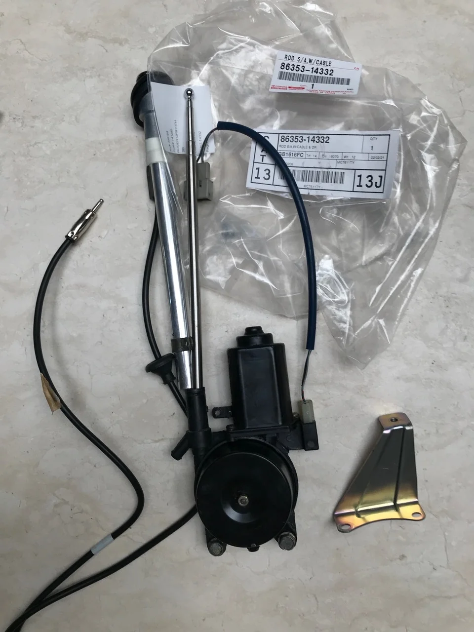

I sold my old parts (picture 2) to MUD member adding a power antenna to his 60.
