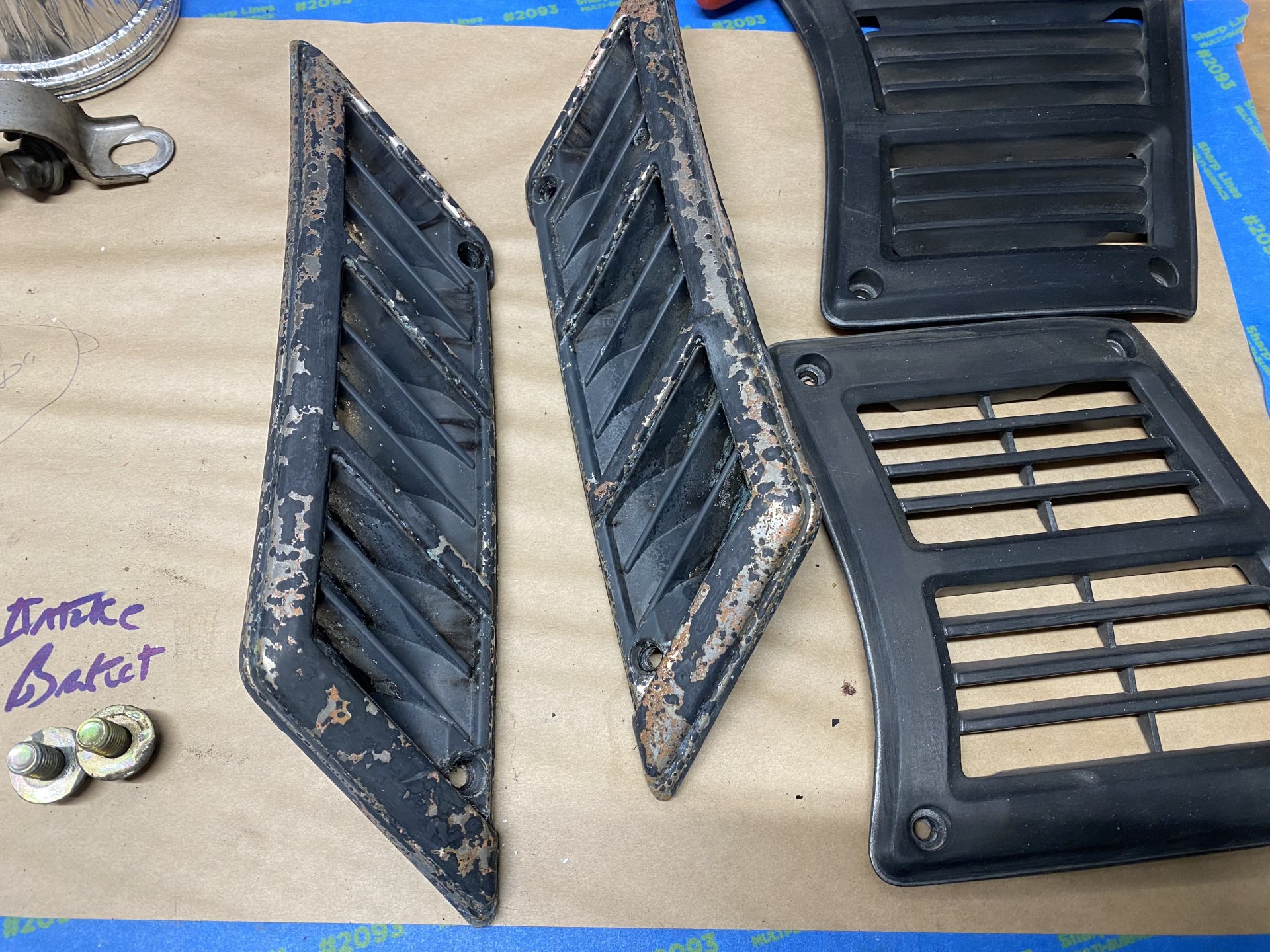

im dechroming all of my pieces, mirrors, fender vents, front headlight bezels to dip in a kevlar finish....
im going to be using muratic acid to eat the chrome away and loosen it up. the big central grill is going to be the hardest part as its large
