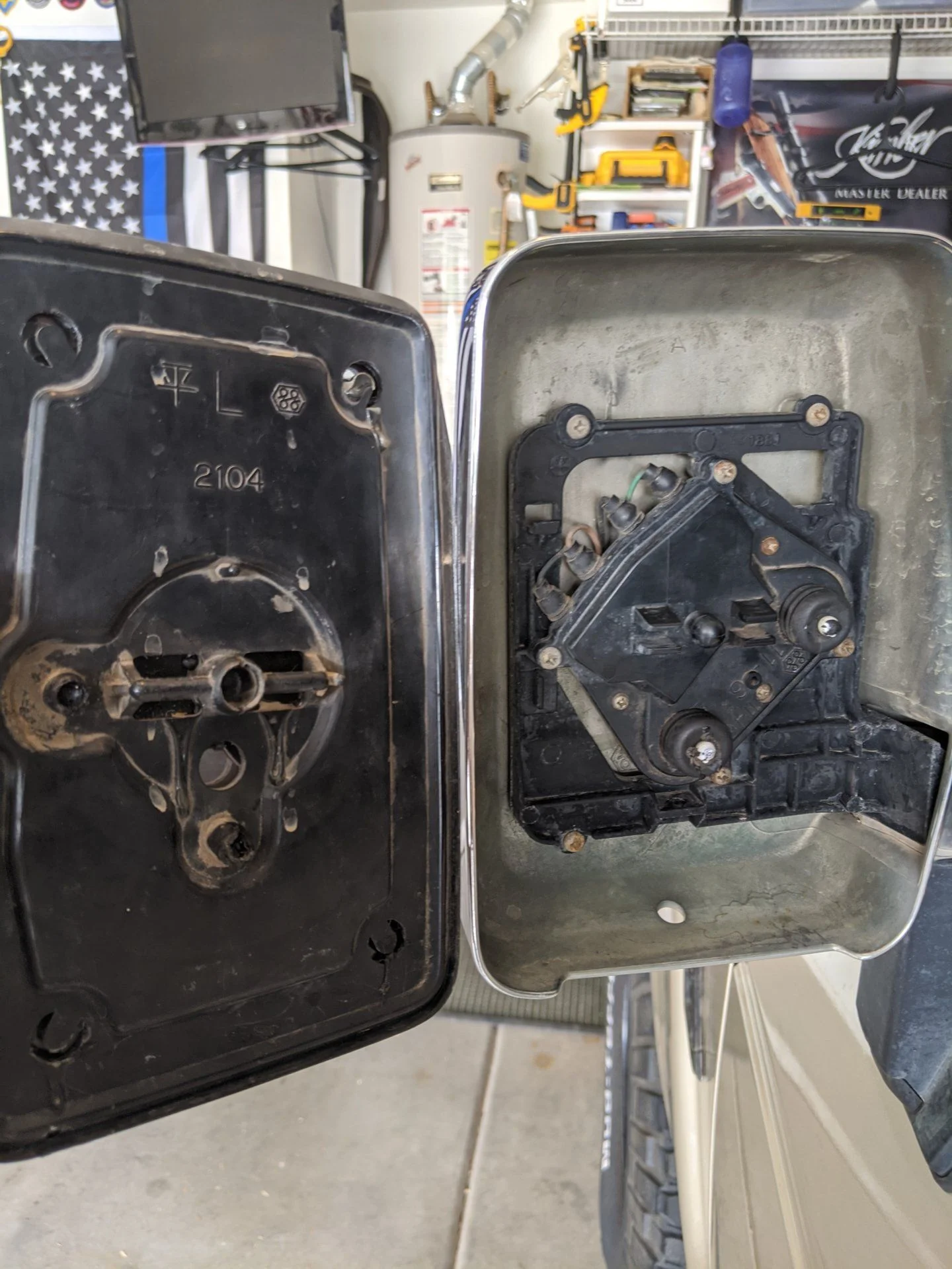

I'm resurrecting this thread because the paint (over the OEM plastic chrome) is peeling bad and I want to strip it completely, dechrome it properly and prep it right before painting it again. I found the Burco replacement glass on Amazon listed as in stock, so I'll order that and just go ahead and shatter the glass that's in there to hopefully access the screws for the motor mechanism. If I have any luck, I'll update. If not, I'll curse a lot and hate my mirrors.
STOP!!! You can pop the pad that the glass is on off the assembly itself. There are 4 balls in sockets that connect the pad to the motor. It's easy to crack the glass, but that can be replaced. The biggest thing is not breaking the pad. I broke the sockets on my driver side mirror, and haven't had a mirror in a long time... Where do I get a new pad??? I'll post pics tomorrow of my mirror
I had actually tried that in the past, but the glass still broke. Once I have replacement glass in hand I'll try it again, but I'm not expecting to avoid breaking it.
If you look at my pad on the left, at least one of those sockets has broken over the years. Hence, the reason I need a new pad... What I want to know is if the aftermarket manual mirrors will work if I drop the guts of the motorized mirror in the aftermarket shell
Gidday team. Thought I would chime in here as Ive just been working on this today and manage successfully to remove the glass without breaking any of the sockets, but I did manage to break one glass. Okay for me as I have a spare.
My question is has anyone got the aftermarket ones and tried to implant the mechanism into these yet? I am apprehensive to try yet as I have concerns the screw holes wont be in the same place...
Any help is greatly appreciated.
