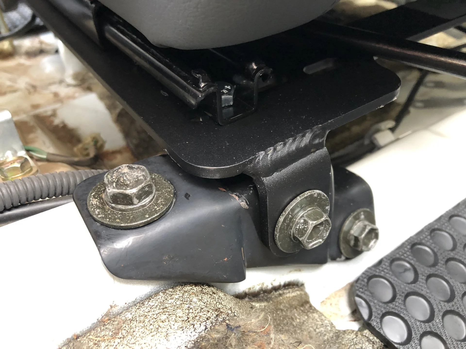

but also seem to be the same as the paint color for the seat bracket to floor as well as others throughout

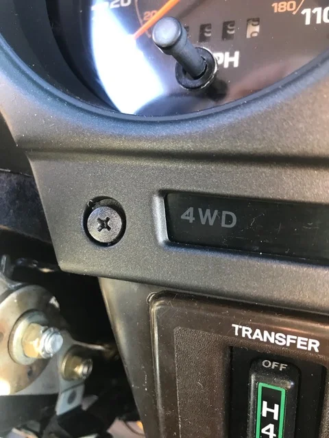

I’ve only seen three colors of fasteners on a land cruiser: Shiny silver color plated, shiny gold color plated, and black oxide. (Black).
then i guess black it must be...

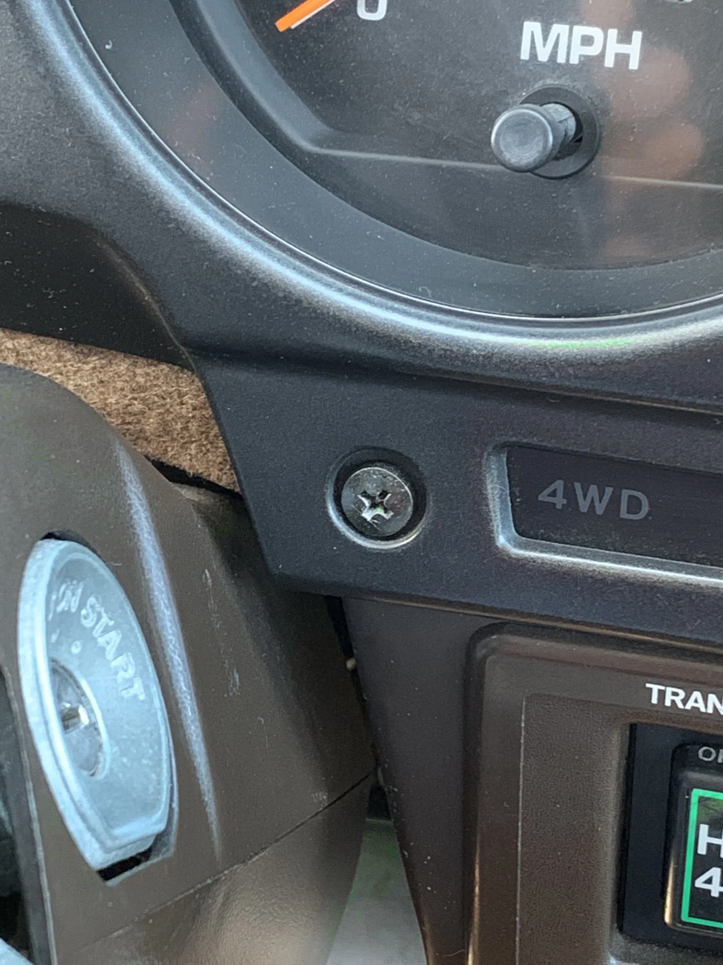

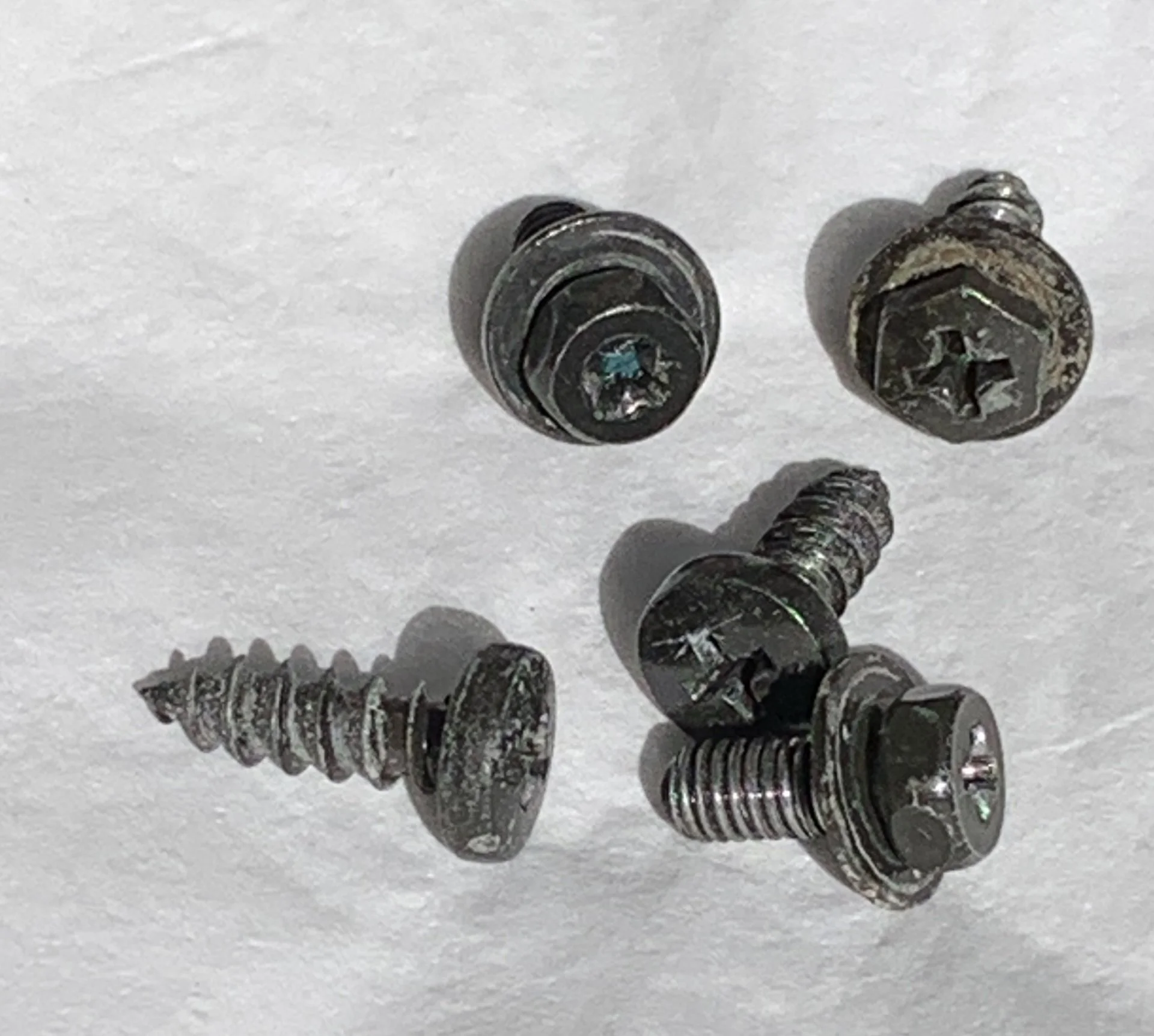

*attached pics this time of dash screw and console screws (and others elsewhere)
Yes those are all black oxide finish.
I wasn’t able to find those big black screws at Toyota anymore. They have a new part number and the new screw is silver and has a blunt tip.
They must still use black screws on some vehicle, but I couldn’t find them. A black sharpie marker pen can make the head of the screw black again and it lasts a long time.

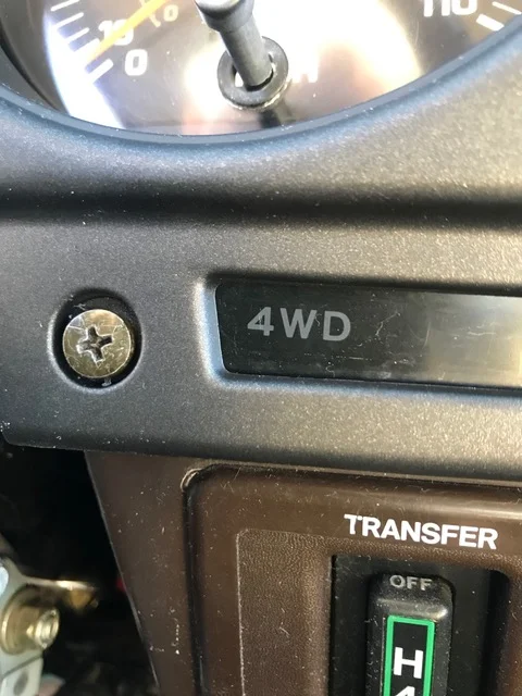

To me the seat bolts look sort of dark olive bronze.
These were cleaned with soapy water before reinstalling. Still could be cleaned up a bit more…

@911nFJ60 is correct...these screws are definitely not black. Here is a picture of my screws (1988 FJ62) adjacent to a brand new OEM instrument bezel before painting and then after painting. It doesn't quite have the same amount of green, but I think the Rustoleum Metallic "Flat Soft Iron" is a pretty close match and is compatible with the bezel color. FYI, the closest match to the bezel color is Rustoleum Metallic "Oil Rubbed Bronze", which is what you should use if you want them to be less conspicuous.
The first two pictures are before painting. The screw on the right is the "flat iron" color. I'll post a later picture in comparison to the original after these dry.
Hmmm...a side by side picture shows the difference between the original (first pic) and newly painted "flat soft iron". No disrespect to father Toyota, but I kinda like my color better.

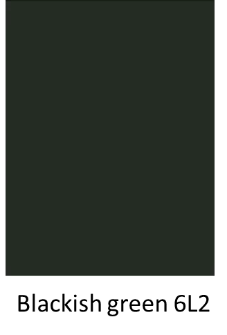

My approach therefore is to go with Toyota "blackish green 6L2" with the black pigment reduced about 10% and the green increased 10%.
(unless Jonathan from TLC4x4 gets back to me and shares his secret restoration knowledge)
***** this color sample does NOT appear on my screen as black as you will likely find on your own on the web*****

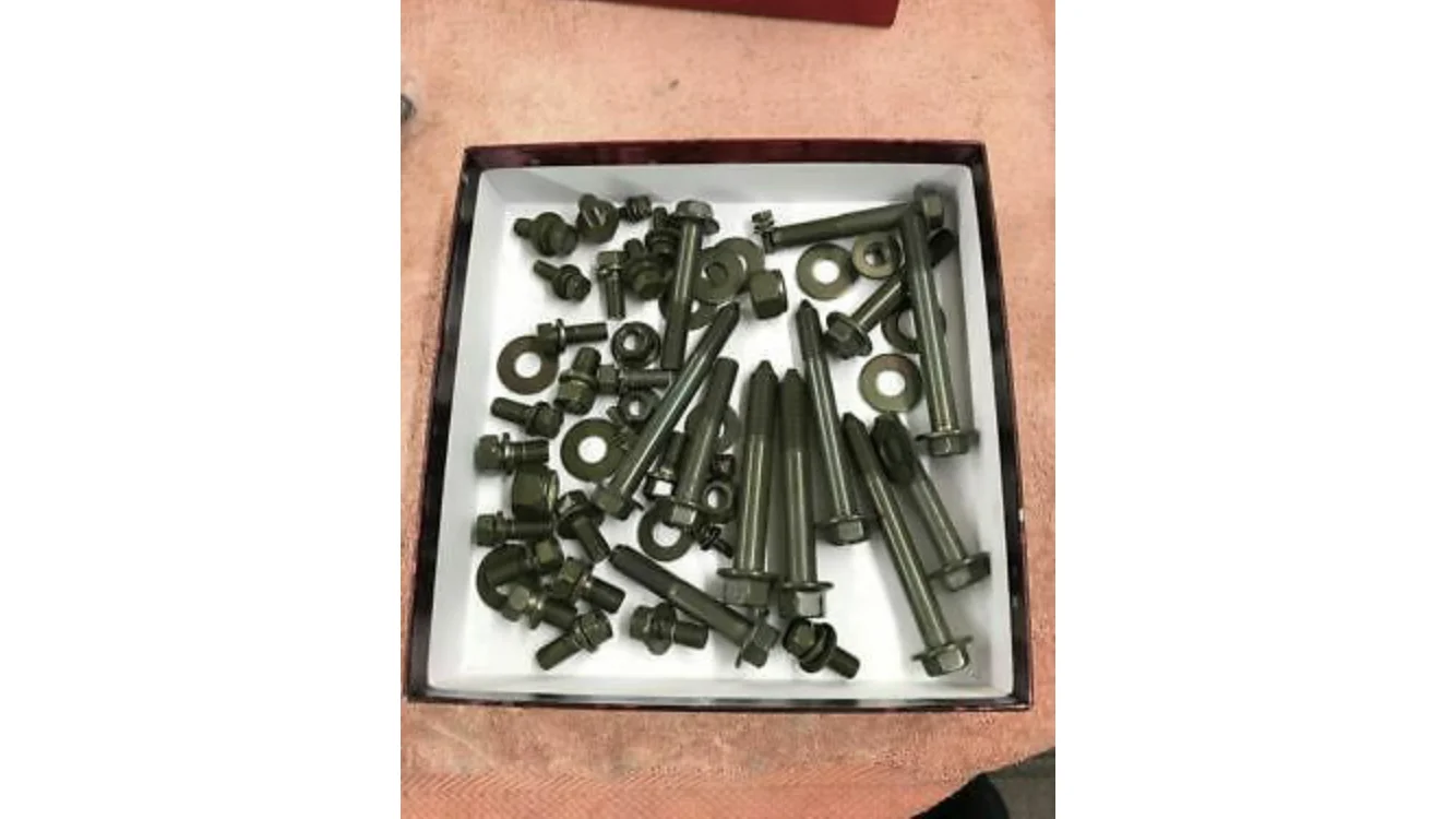

Just dug a little bit into zinc plating. It seems that these may just be a dark olive drab zinc chromate plating. Here’s a kit you can buy to DYI.
Here’s a box full of dark olive zinc bolts. Apparently Yamaha used them on motorcycles too.
Cool info on the olive green plating. Just as it appears that we all have a slightly different shade of green at this point, I'll bet the timing and ratios and other variables involved in the plating process are mind boggling - and knowing when you are dark enough but not too dark is kinda nuts.
Plus, my bolts seem to have some bronze and i'm not convinced that i achieved that yet with the paint, but at least the green is my green. AND, it apparently isn't the right green for 911nFJ60 as his seems much lighter (fade?)
