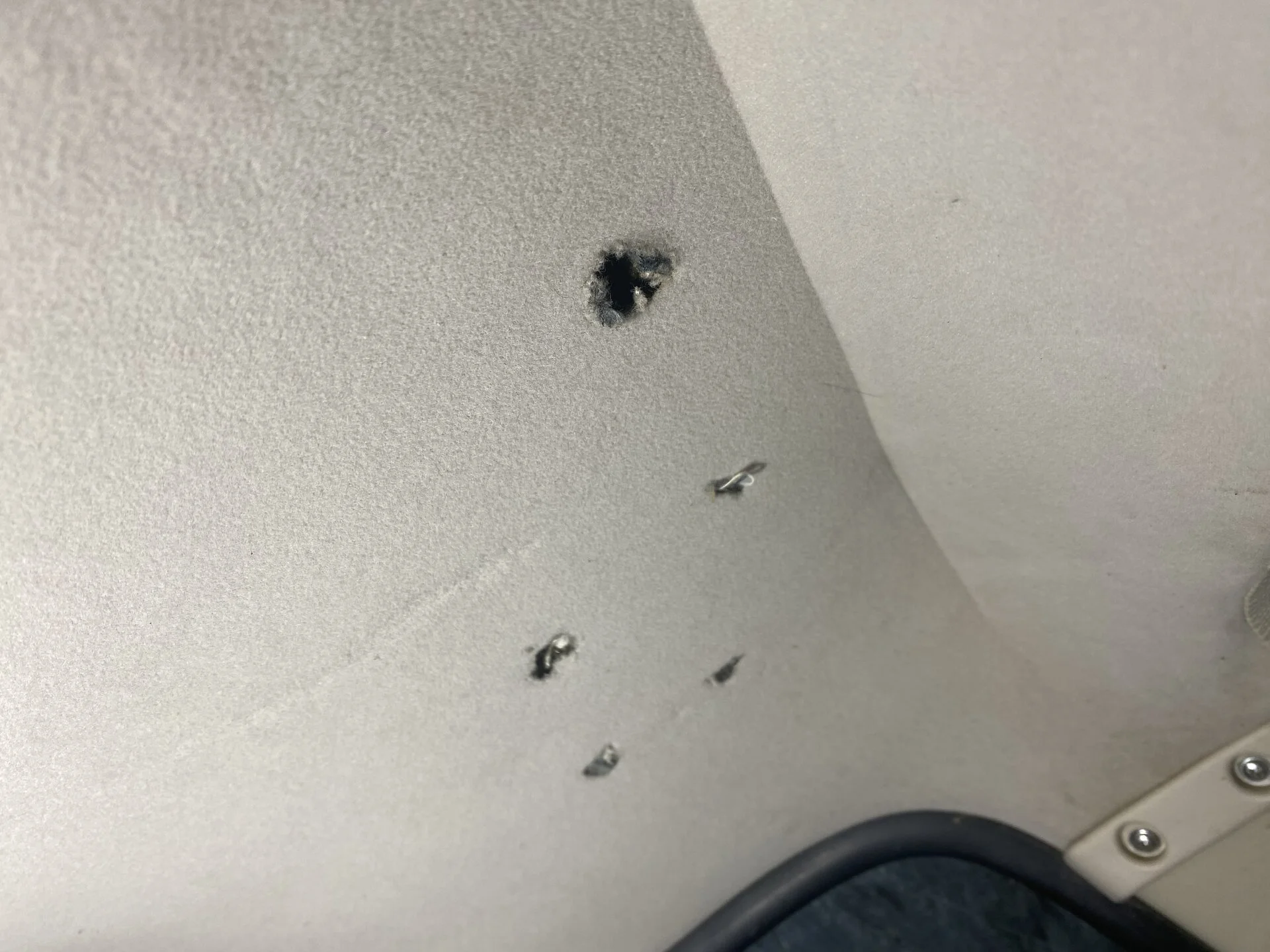

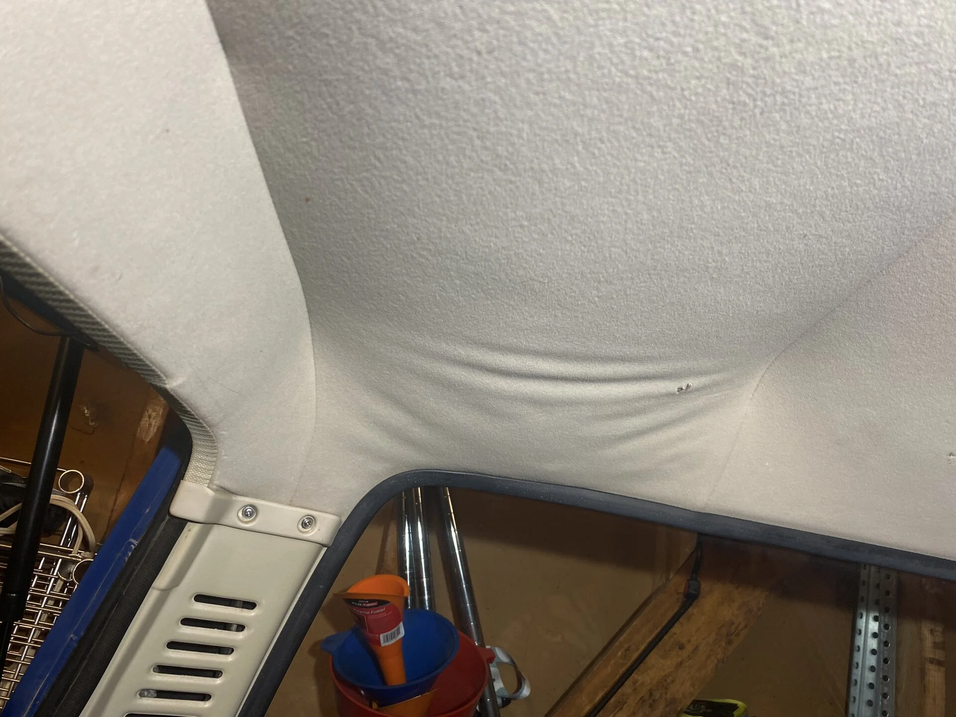

That being said I’ve got a mouse nest on either side of the rear section of my headliner.
Can you remove just the rear section? The two rear most bows. Vacuum out as much as I can and reinstall?

Well well well Montana. That’s where I got her from. There is no staining coming through the liner but it does smell. I thought it was spilled fertilizer or whatnot in the carpet. It was a rural area or came from. All the fluff I pulled out of the hole behind the rear dome light was dry n kinda sunflower shells and mouse poop.
We will see.

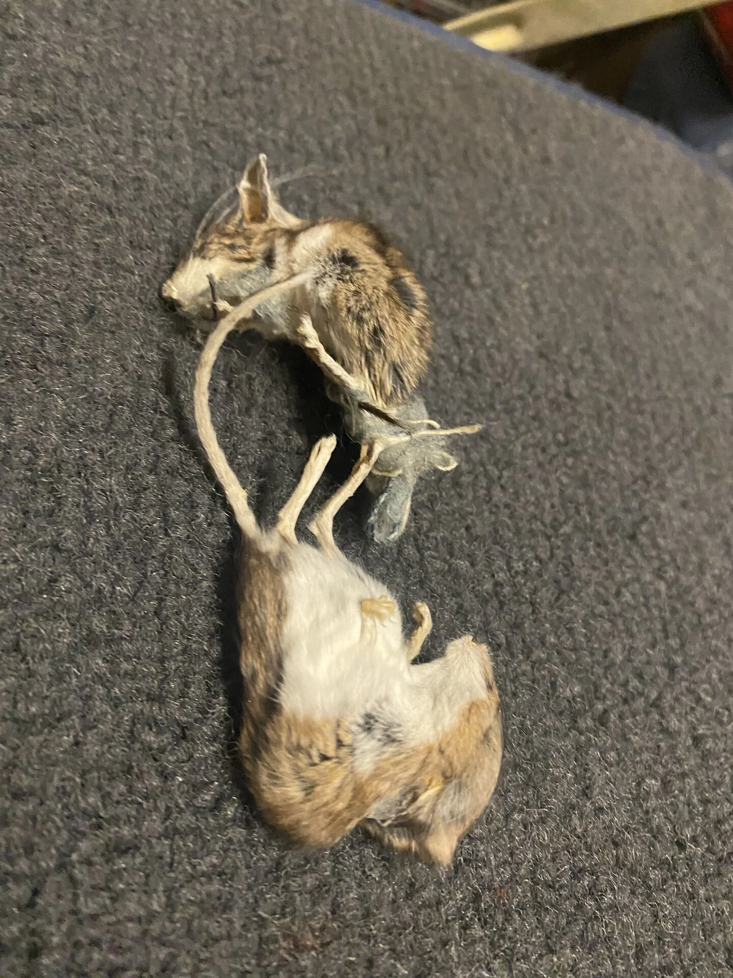

Cut open a small slit on either side and shoved the shop vac in and filled my Rigid 4 gallon three times.
Pulled a couple buddies out that were clogging the nozzle. May have sucked a couple more through that I didn’t see.
Hope this helps with the smell.
