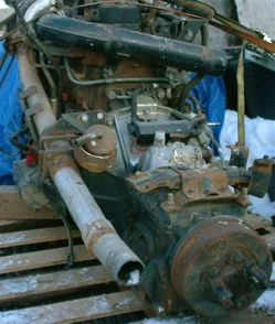

could i do that same set up - bellhousing marriage with an isuzu 4bd1t, and the a440f?
here is the engine and bellhousing of the isuzu

would you have a photo of this bellhousing you crafted?

Didnt take a picture of it out of chassis, I dont see why you wouldnt be able to adapt to your bell housing, need a machine shop and a good welder. The toyo has a bolt on bell housing on the auto so should work. Good luck
