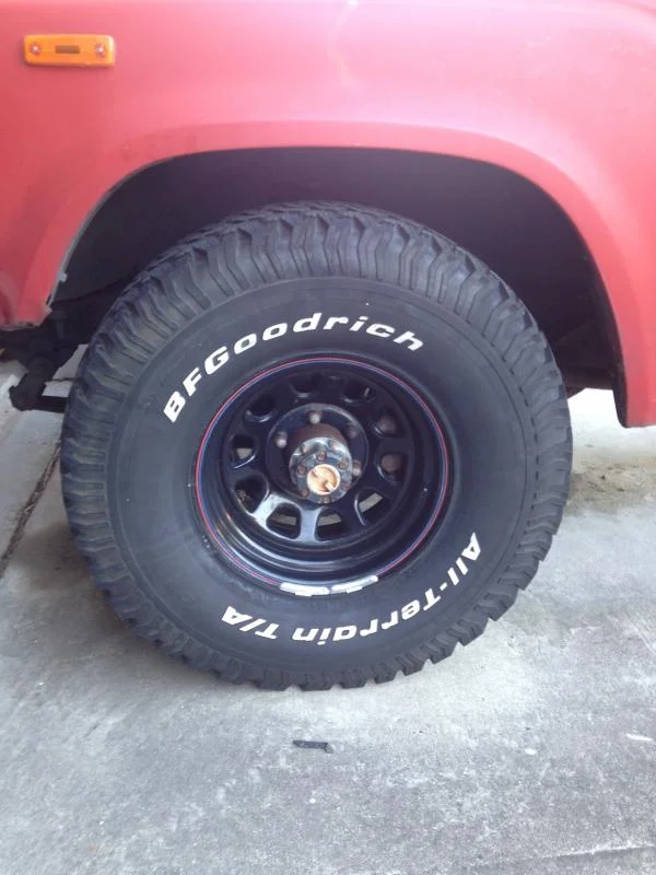

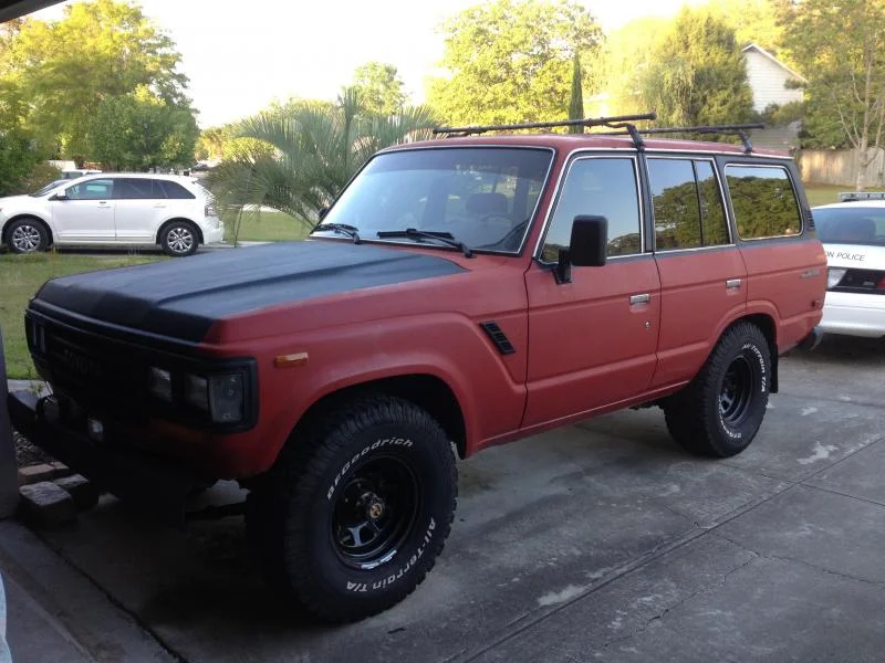

Got the new tires on. 33 12.50 15's on some black 8"
wide steel wheels.
I also got the hood that a fellow member hooked me up with put on. It was blue so I painted it with bedliner to match the bumpers and the other parts I blacked out. Eventually the tops of the fenders will be black once i fix some rust holes.
