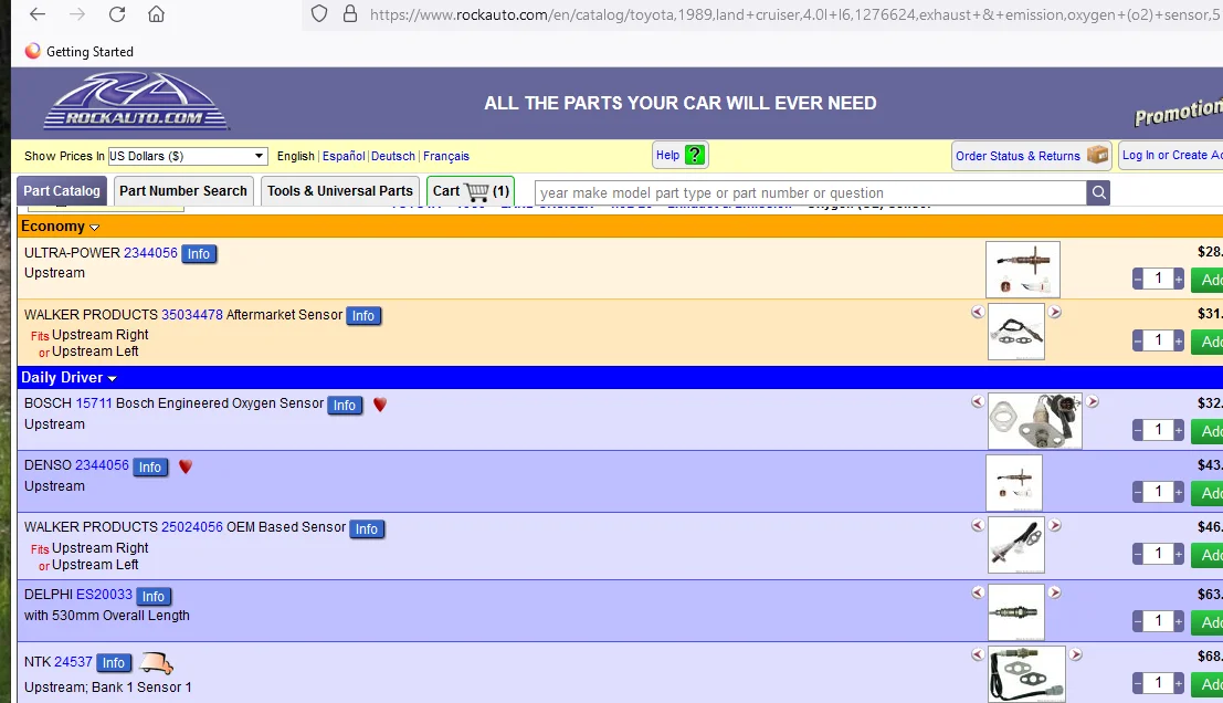

Yeah for sure, I can’t verify if these are original or not but they do seem due to be replaced anyway. I’m not sure if the Denso units from Advance Auto are a direct fit, I think I was reading on here the wires are too short.
If you click on 'info' by the Denso part number, Rock Auto often provides the OEM part number, which allows you to correlate with Toyota. I have purchase all my Denso oxygen sensors there for years.
Looks like they have the sensors and the gaskets, but not the nut. May need to source those from the local hardware store.

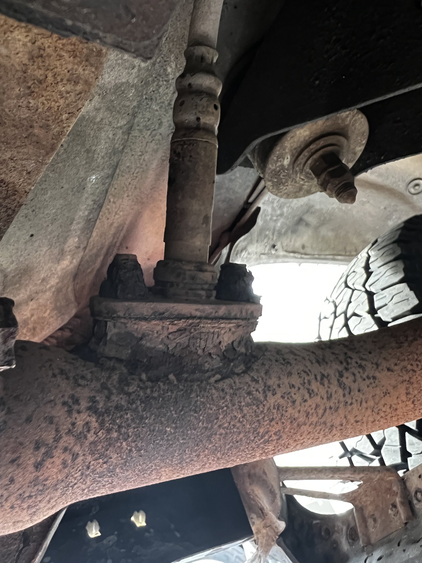

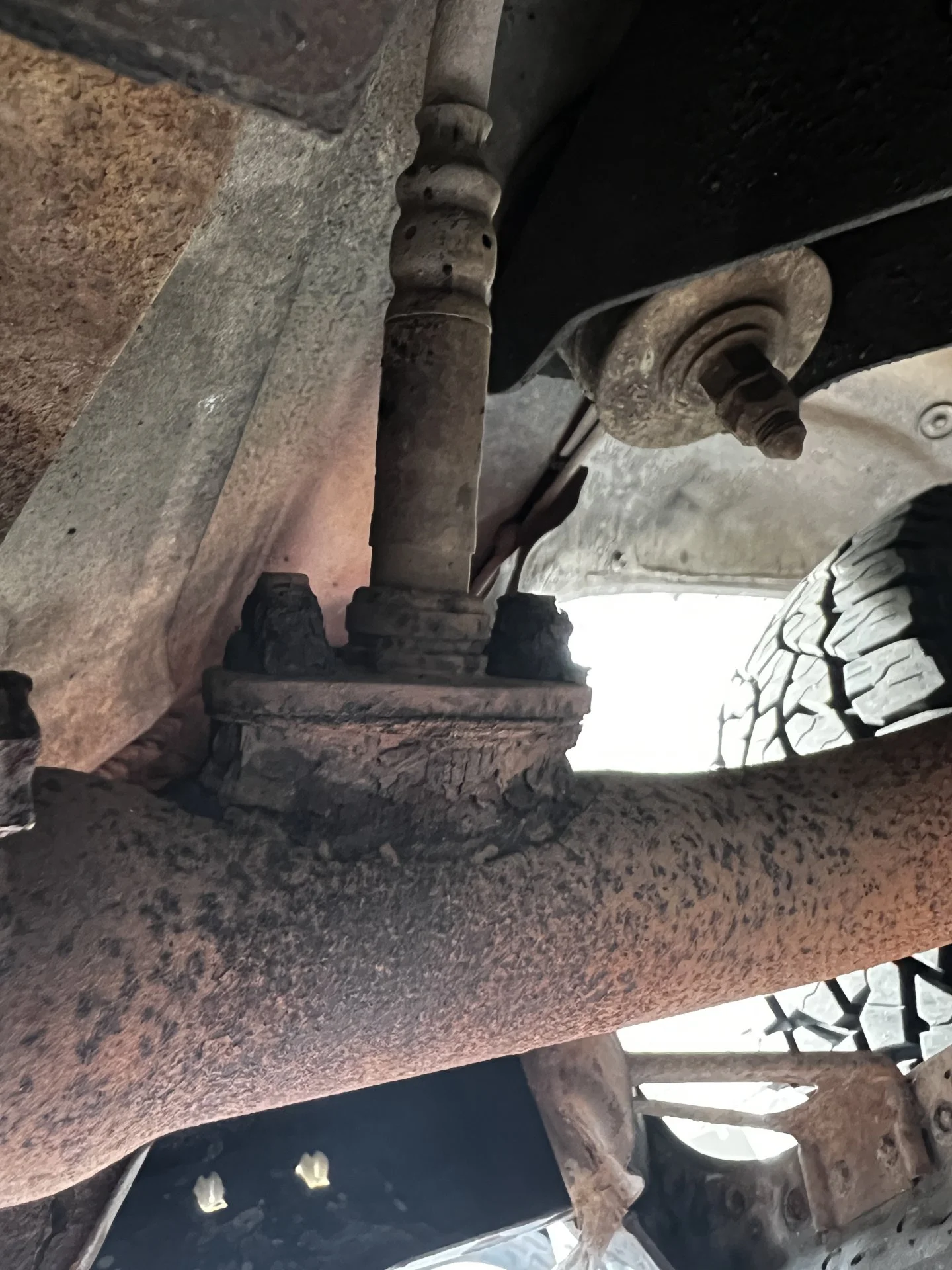

This is the state of the lower O2 sensor attachment point, had it soaking for a few days in PB Blaster. Not much to grab onto, going to try a wrench and maybe a bolt extractor. These down pipes may be beyond saving.
Hmm, yeah this is gonna need to get cut out at the cat and new downpipes installed.
I don’t think I can get my angle grinder to the bolts at the cats without damaging the surrounding area.

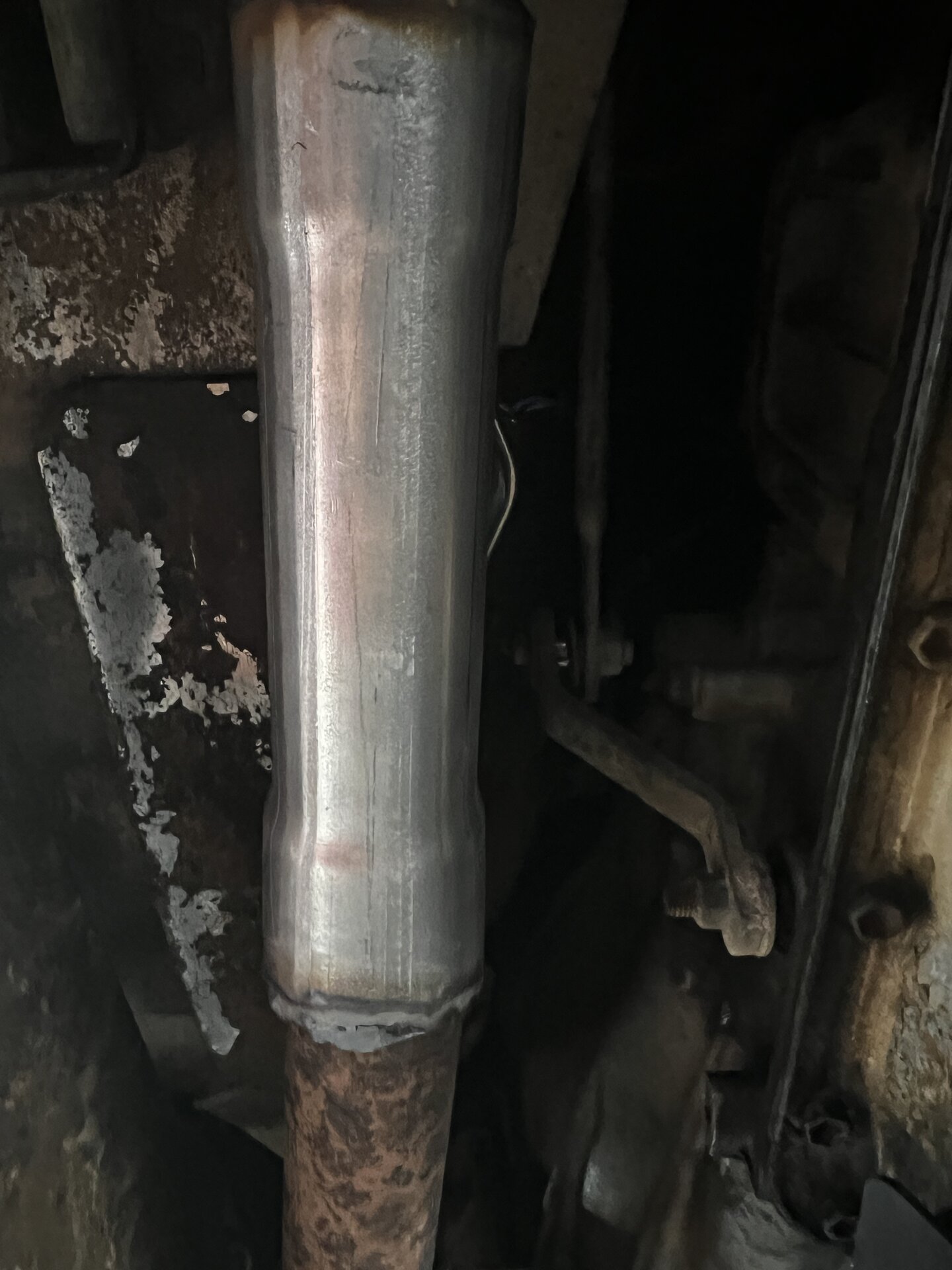

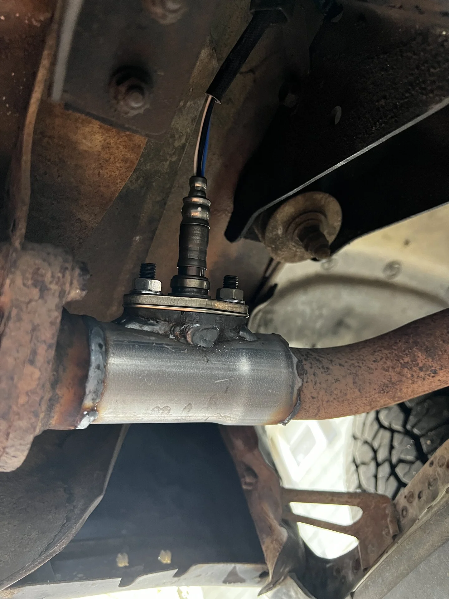

Got the truck back from the muffler shop, turns out we only needed to cut out the old bungs and weld in new pipe. It’s not winning any show awards, but the truck is more steady under power now. Will update if the road-trip CEL returns.
