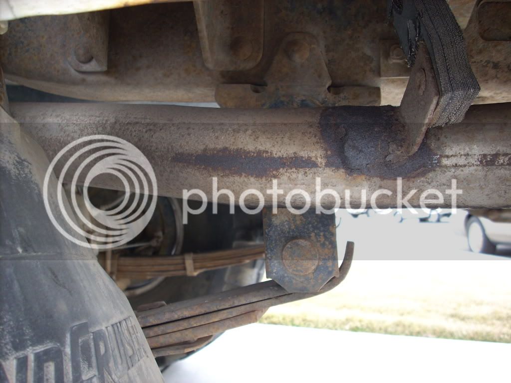

Huuummm I got 75% of the job done then ran into this;
What was the muffler shop thinking?
You can also see the shackle angle is less than optimal with the current set-up.

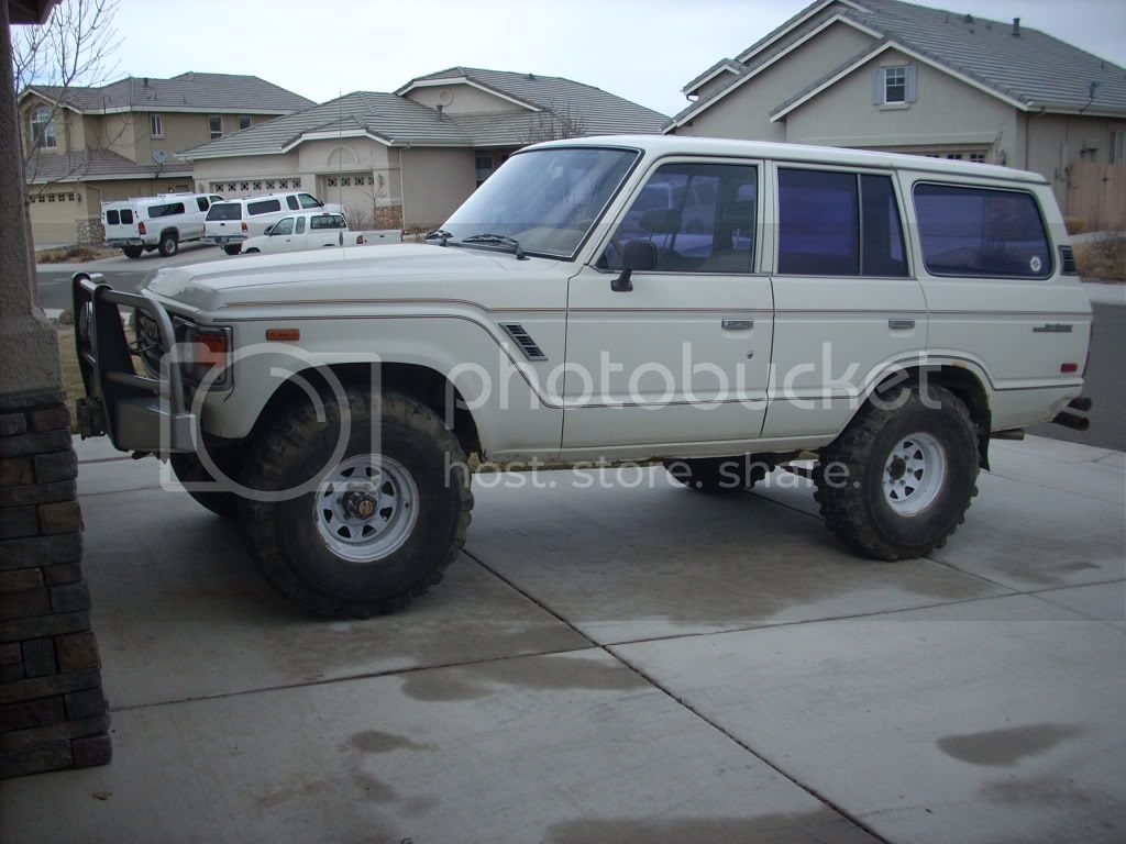

While I had the shoes off I decided to see if 35" tires would fit as it sits. So I tried on my 36" swampers from the 40 which now measure just under 35";
I did a little test drive into the hills and ran the PS tire up on a rock. This thing has as much flex as a grocery cart. :rolleyes:

Unless you are there to tell them or they understand what it is you want, they will do things like that.
The shackle angle and the flex doesn't surprise me. You can't cheat the physics.:D
Time for some true aftermarket springs, not jerry rigged stockers...

Yeah, I had to have the exhaust re-done on the 40 for similar reasons.
Jack
This begs the question; to SOA or not to SOA?
Id say get some lift springs, but that WONT help your articulation AT ALL...You could nix the sways to help get a bit more, but nothing like youre used to.

I just can't remove the shackle without pulling everything up to the cat.:flipoff2:
