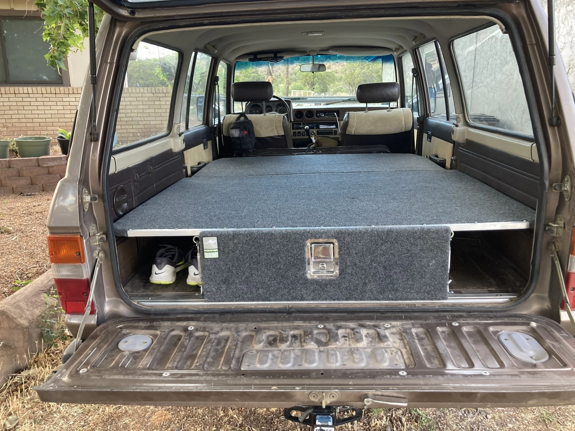

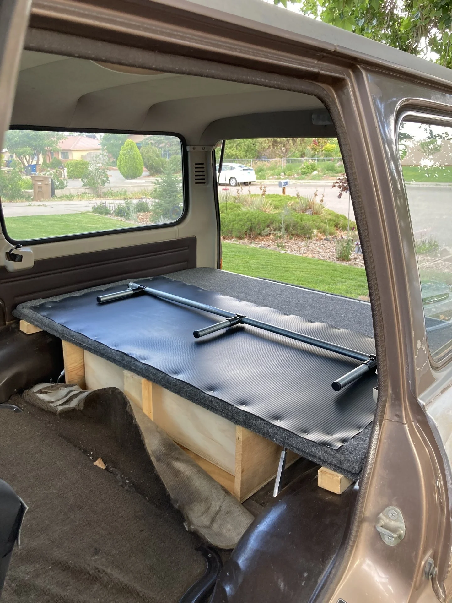

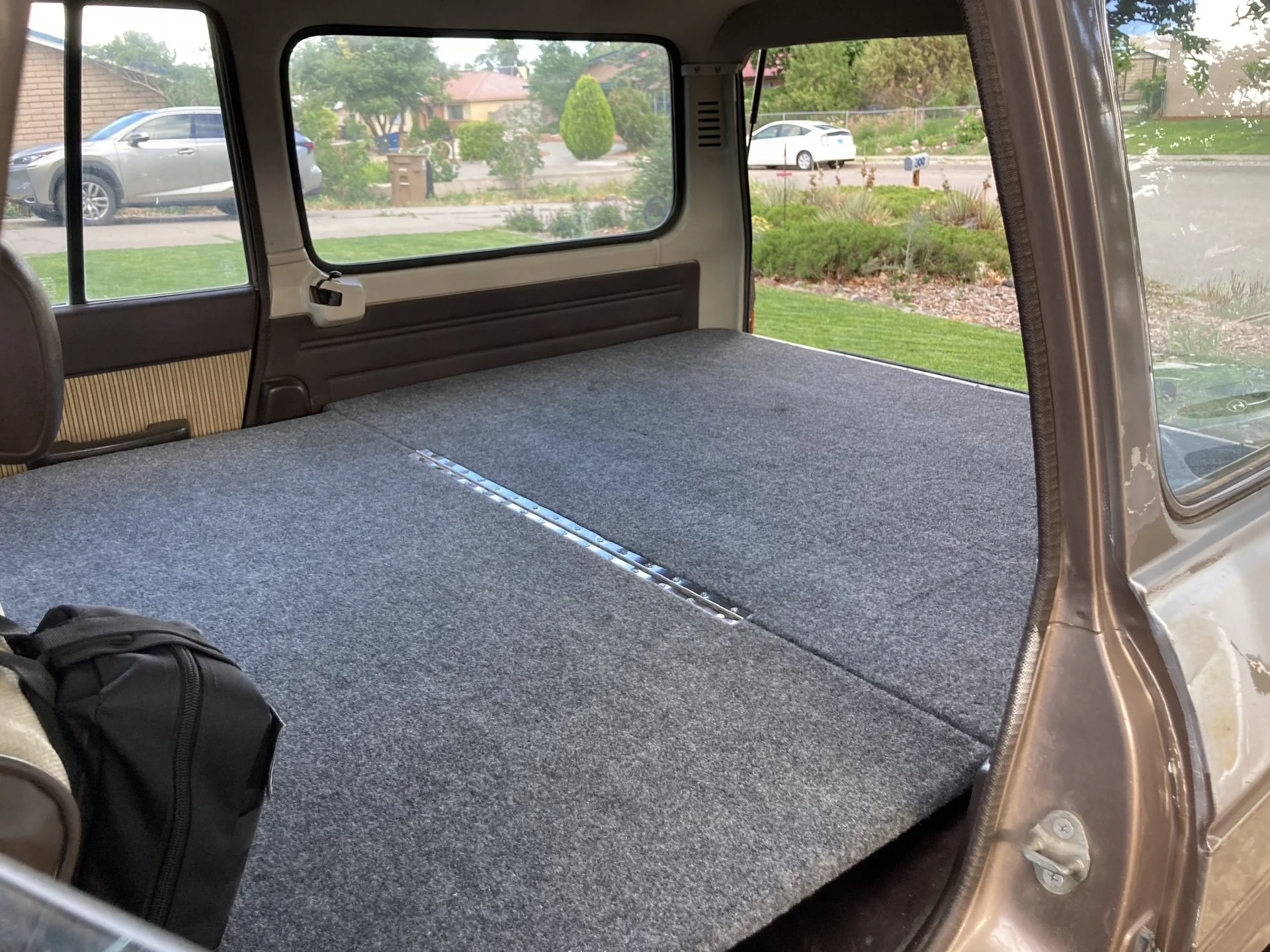

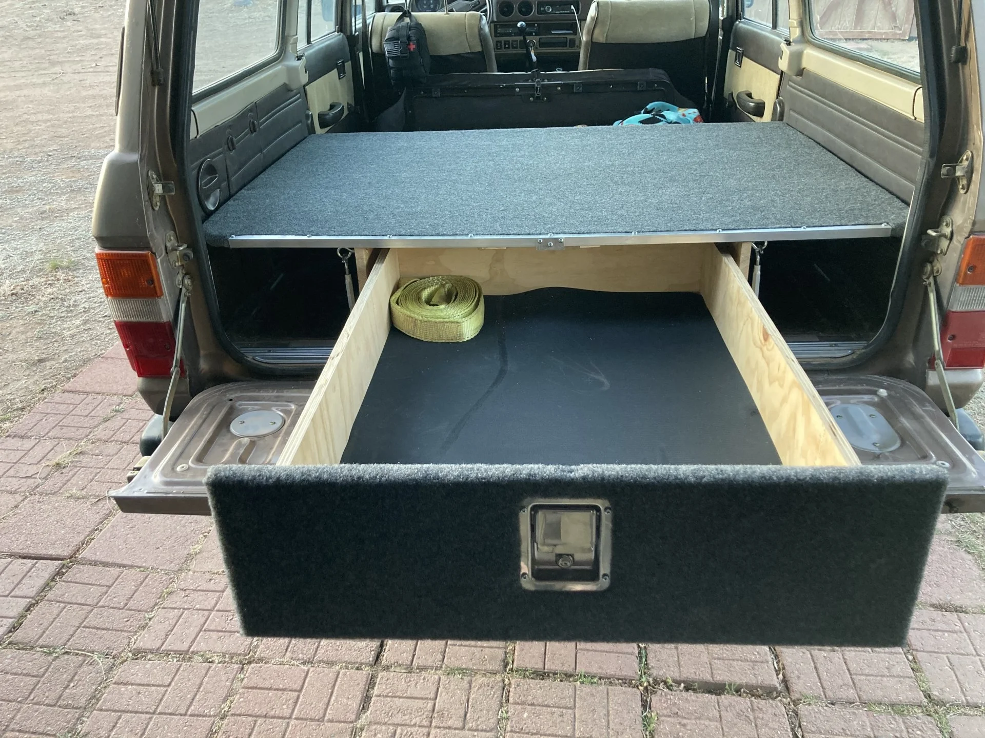

Just wanted to share the sleeping platform/drawer I put together in my 60. All base & drawer were assembled with 3/4”plywood and the top is 1/2”. Not sure if the piano hinge is gonna last, but I’m happy with how the front supports came out with conduit and clamps.
Just wanted to share the sleeping platform/drawer I put together in my 60. All base & drawer were assembled with 3/4”plywood and the top is 1/2”. Not sure if the piano hinge is gonna last, but I’m happy with how the front supports came out with conduit and clamps. View attachment 2720431
nicely done, looks very serviceable. re: the hinges, may i suggest using 4 or 5 door hinges thru bolted with machine screws rather than trusting the 1/2" #6 at most wood screws to hold in 1/2" ply . that's just my 50yrs plus as a carpenter talking. that conduit support dealio is a very simple solution. nicely executed
Thank you! I don’t love the piano hinge, but we will see how it holds up. I like the door hinge idea 👍🏻
