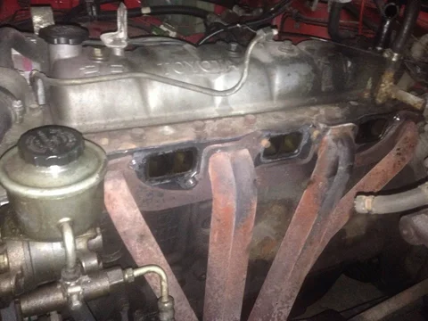

Day 1: Removal of parts- took me about 2 hours including time to wait for penetrating oil on a stuck bolt.
#1: Pictures to help remember where everything goes, could be helpful to someone else as well. Also labeling the hoses when I remove them.

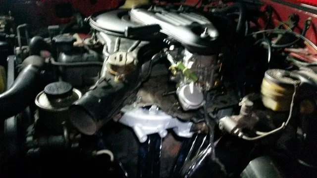

#6. Manifold out and ready to clean before a thorough inspection for cracks and warping
That's where I'l leave it for now.

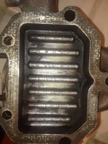

Day 2: Cleaning

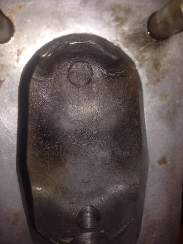

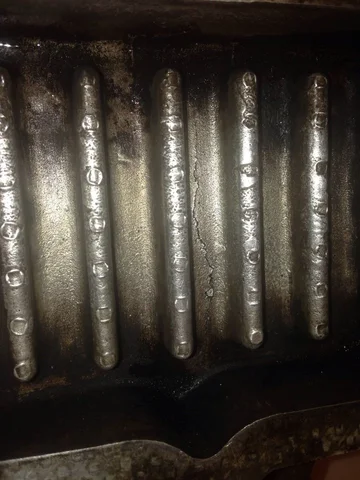

Spent an hour cleaning the manifold and assorted fittings. Just used Dawn, water, and Scotchbrite/ toothbrush. Once all the grease was off I could see a crack on the bottom of the manifold. And sure enough, on a closer look, a hairline crack was just barely visible on the inside surface under the carb as well :( The mating surface looks clean and very straight when checking with a straightedge, although there are a few very shallow scratches on the center intake.
I'm guessing it is weldable and I can probably have it done at whatever machine shop does the resurfacing (still looking for recommendations near Ventura). I'll have to add a block off plate or heat riser before I re-install, there was nothing there when I removed.
Also, if you look at the front edge of the hole for the carb in the last picture, you'll notice that it's a bit rough and pitted. Will that cause any issues? It's not on the surface the carb spacer mates to, rather on the side of the hole parallel to the engine block.

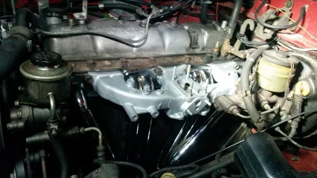

So today was like Christmas. Went by the machine shop to pick up my repaired and resurfaced manifold and headers. Then came home to find this waiting on my doorstep a day early:
I decided to go ahead and get to work. Here's the ports with everything removed:
Started by laying out the sockets I'd need to get the header and manifold on and then copper-coated the exhaust ports.
I did the same to both sides of the gasket and the header surface and then loosely hung the gasket and headers from the center studs and started the end bolts to keep things stable:
I then hung the manifold from the center studs and started the rest of the bolts:
As you can see, in one spot the manifold and the header were not quite level. I had been confused about the "half washers" people were talking about, but once I saw the problem right in front of my face it was fairly easy to figure out. Found a washer of the right thickness, put it in the vice and cut it in half with a hacksaw then used a file to de-bur it before using it as a shim on the header side as pictured:
I then torqued the bolts down in the order from the FSM: starting with the studs then basically working out in a clockwise spiral to the outer bolts. Torqued to 36 ft-lbs for the ones I could get my torque wrench on, and used those to gauge the hand feel for the end bolts that I couldn't. Once it was snugged down, I took a peek from all angles to verify that none of the other bolts needed the half washer trick then mounted the carb insulator:

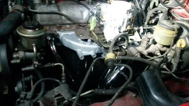

The Trollhole Carb was next and hooked up the throttle linkage and the choke cable. I had to cut the bead off the end of the choke cable and just use the set screw provided with the new carb because for some reason the bead wasn't quite the right size, it looked a little bent out of shape. kept the cover on during the install so I wouldn't accidentally drop anything down there:
I then connected the vac advance from the distributor to the single valve cover side port (replaced the old line with new 3mm tube). I cut the plug off the stock carb, double checked which wire had 12v then connected the plug to the new carb. Then I connected the fuel line:
The hard line coming off the firewall comes from the charcoal canister, there's nowhere to run it on this carb, so I just capped it. There is also no provision for the fuel cutoff on the trollhole, correct? I didn't have the A/C idle up hoked up before, so not going to now unless I run into problems when summer rolls around. Hooked up the drivers side VCV, the two 5 mil lines went to the same places they used to go, the carb insulator hard line and the purge hardline below the brake booster. Port x goes to the air cleaner, and port s is supposed to go to BSV1, but both nipples are broken off on both BSVs- neither was in use before I pulled the carb and with the Trollhole there is nothing to route the other ports to (would go to EGR R port on stock carb?)? Going to have to read up on what it does and if I need it on this install or if I can cap port S:
The passenger's side VCV, no picture sorry: port s was connected to the same fitting that the brake booster line plugs into on the manifold. Port Z was connected to the distributor cap, Port X was connected to the same line via a t fitting. Finally port Y will go to the passenger side of the air cleaner lid. Already mentioned the vac advance line goes to the single port on the valve cover side of the carb, and the HAC is capped. The only other Vac line here was also replaced, the vent from the distributor cap to the firewall.
While I was in there I changed out the PCV valve and grommet, as well as the fuel filter. The PCV breather line was badly cracked so I'll have to get a new one. Finally I switched the lines on the charcoal canister as I was having the issue with the fuel tank not venting properly.
Started it, but without knowing for sure what I need to do with BSV1 I didn't want to run it long enough to set the idle. Plus, it was getting late and the new header does not line up with the exhaust anymore, very loud and very satisfying but I don't want the neighbors to hate me. Has anyone used the flex exhaust sections? Wondering if I can put one on there temporarily with clamps so I don't have to drive to the muffler shop with open headers.

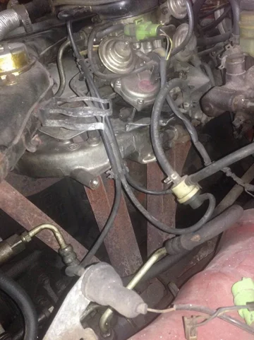

I fixed the vac leaks that were causing my issues by replacing the PCV hose and just routing the distributor cap vent to the air box until I get another VCV. Set the timing to 10 degrees, then buttoned everything up and took her for a test drive. It pulls great through the whole RPM range, and is idling smoother than it ever has in the 12 years I've owned it. All that's left is getting my temporary clamp on exhaust section replaced something more permanent and it'll be running better than it ever has for me.
Everything sure looks a lot simpler under there now. Part of that is because the number of vac lines is even lower than it was with the previous desmog. Part of it is because tackling this job has let me learn a lot about the Cruiser that I didn't know. I recommend taking this job on yourself on if you have the time, regardless of your experience. The resources here are great, and the FSM is helpful as well, and I'll be more confident taking on other jobs like this in the future now that this one is under my belt.
