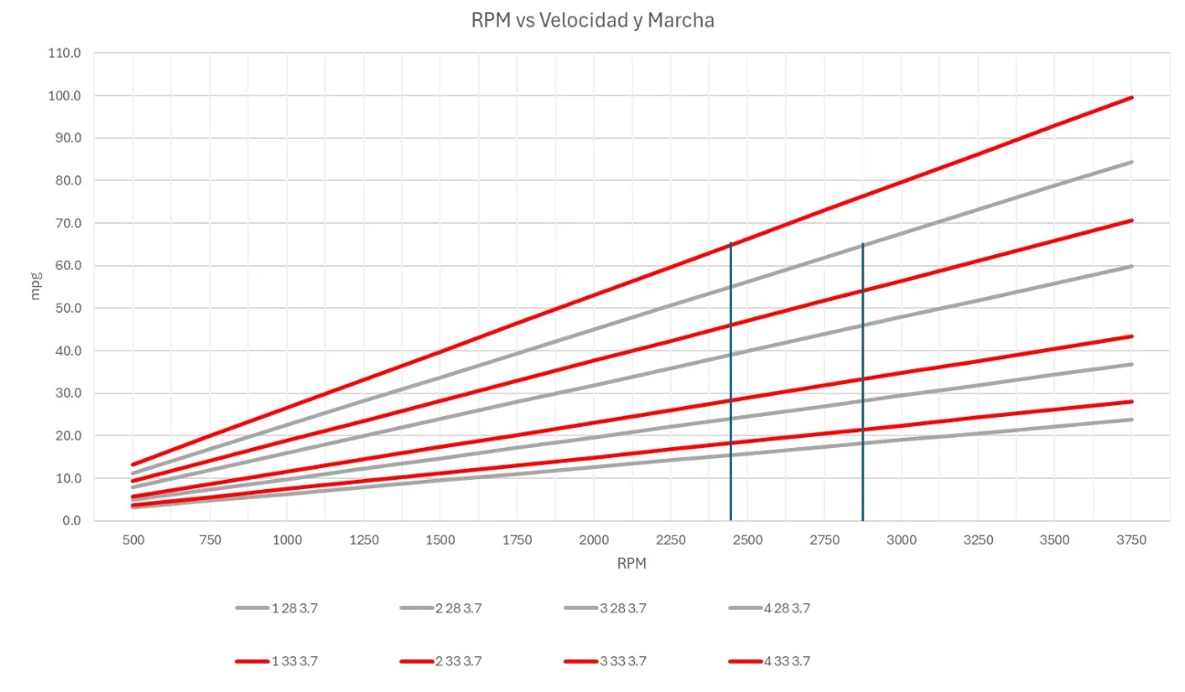

On my offroad trips I found I was changing to 4L a lot sooner than the rest of the pack... I used to think the old truck is just old but talking about 35in tires with a friends we start talking about gear ratios.... so here is is what I found
- Gray line is the stock configuration meaning 28in tires and 3.7 diff. Every line is 1st (ratio 3.55), 2nd (ratio 2.292), 3rd (ratio 1.41) and 4th (ratio 1). And imagine you move to right as you increase RPMs in the engine while velocity increases.
- Red line is the what I have currently, stock setup but 33inches. Noticed that I have lost about 25% of my 1st gear... so now it is something less that the stock 1st gear but is not like I lost it totally and now my 1st gear is 2nd... Everything is off by a good amount... this is specially noticeable when driving on the mountain passes and I have to shift down from 4th to 3rd or even worse from 3rd to 2nd. On really steep climbs (pavement climbs is as bad as I have to engage 4L, no hubs to keep going).

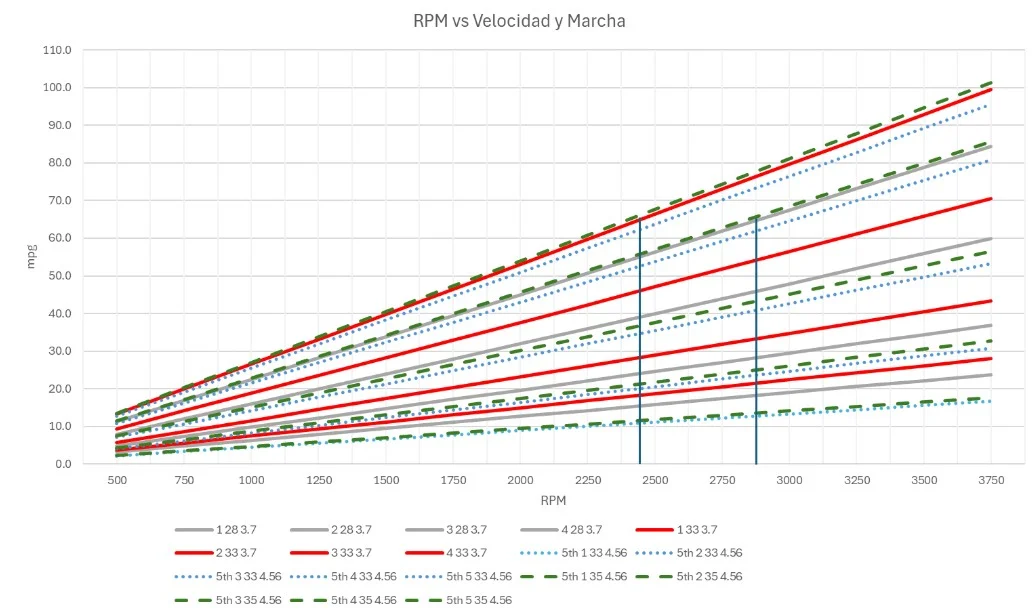

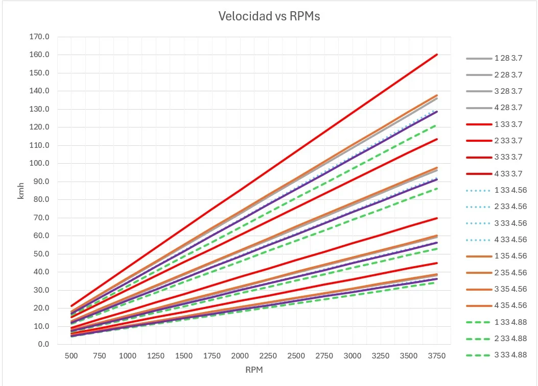

Before continuing with gear ratios I forgot to mention. My current combo is great for my "highway" experience, basically I go with flow, folks from the pack don't have to wait for me at all. Calling Costa Rica roads "highways" is a bit of a stretch.... Totally remain in 3.70 diff ratio with 33in if where you live is flat
The following graph is the worse! but only way to analyze my options
- Red line is what I have, basically stock plus 33in
- Dotted light blue line: 33in tires with 4.56 gears. I have to consider this because even though I want 35in I dont have the money and It can take me about 1 year to get them. Noticed that This blue line is basically taking the car back to stock ratios maybe a bit more punch, maybe a bit slower. I think event thought there is a mathematical difference I dont really think there is a practical difference you would notice... If that is what you are looking for, this is your 1st option. To me, It feels like a compromise as I'm loosing my current speeds at 4th gear but I know I can take it because I have another car (2017 Rav4 manual 6th gear tranny) for family trips where no offroad is needed. This op
- Orange line is 4.56 diff ratio with 35in tires. Notice this is right on stock. The line is above stuck (faster better mpg) but I don't thing the difference in the numbers is enough to actually feel it in the road or the gas pump.
- Green dashed line is the next available gear ratio 4.88 with 33in tires. Difficult to say how much punch you are going to have more on 1st gear with this. I can say I'm not going to load my truck with a bunch of camping gear so weight is no an issue for me. Thinking further into the future, 37in tires is not in my life plan so I dont need to gear for that possibility. Also noticed, compare to my current experience (Redline), I would lost my 4th gear as the 4th green dotted line is basically closer to the 3rd red line. This is too big of a compromise for me, I know at this point is not a diff gearing issue but a tranny issue but in my personal case, 5th gear tranny will come in like 2 years if any.
- Purple line is 4.88 diff ration with 35". As I'll be improving the car over time, years! this is not my option for what I just mentioned. If you have already a 5th gear tranny wait for the next graph because the ratios change!

- Dotted blue line will be 4.56 gear ration with 33in tires BUT 5th gear tranny meaning 1st (ratio 4.843), 2nd (ratio 2.619), 3rd (ratio 1.516), 4th (ratio 1) and 5th (ratio 0.845). Notice how with this combo I endup having a punchy 1st, 2nd, 3rd but also having my current top Speed/RPMs on 5th gear. I have to say this again, if you live in flat lands and want fuel economy and highway experience first buy tires and later buy 5th gear tranny. I don't have the lines for 5th gear tranny with stock diff ration 3.70 and 33in tires because too many lines! but if you read until here you can anticipate having lower RPMs at the same or higher velocities on highway, plus, 5th gear tranny has better ratios
- Green dashed line is the golden future state for me 4.56 gear ratio, 35in tires and 5th gear tranny. Stronger 1st, 2nd and 3rd. Notice how my 2nd will be almost what I currently have for 1st (Lower Red line)!!! and my 5th gear will be as fast (sounds like a joke!! but if you follow till here you know what I mean) as my current top speed.
I found no need to add the 4.88 diff ratio lines here because I already found what I wanted. 4.88 with 5th gear tranny will be overkill for me with even stronger 1st, 2nd and 3rd. Notice that I'm also not comparing against stock 5th gear tranny lines but stock combo was okay for engineers back in the 80s and I am more interested in how my current driving experience will be improved. I have been driving this car for a year already and I thinks this is the best option I can take. If you are considering rock crawling (adding heave rock sliders, under armor) and overlanding (roof rack, camping tent, fridge, gas stove, so on) for a very very heavy truck totally yes... rock the 4.88, 35s and 5th gear!

1st Graph: Stock FJ60 with 33s
Second graph: evaluating all options
Third Graph: future state with h55

Hey! Not sure if the below helps at all or just repeats what you already know.
Current Setup:
  • Vehicle: FJ60 with a 2F engine, 4-speed manual transmission.
  • Tire Size: 33 inches.
  • Differential Gears: 3.7.
  • Driving Conditions:
    • Daily driving: Short trips in traffic-heavy Heredia, Costa Rica (8 miles round trip).
    • Off-road: Mud, hill climbs, no rock crawling.
Challenges with Current Setup:
  1. Lost Low-End Torque:
    • Moving from stock 28-inch tires to 33-inch tires shifted the effective gear ratio higher (approx. 25% reduction in torque).
    • You’re engaging 4L sooner than your trail group due to the lack of crawl ratio.
  2. Steep Climbing Issues:
    • On-road steep climbs require dropping to 3rd or even 2nd gear, and occasionally 4L for tough grades.
  3. Highway Driveability:
    • With the 33s, your 3.7 gears still perform adequately for moderate highway speeds, but it’s not ideal for climbs or high-speed travel.
Proposed Gearing Options:
1. Stick to 3.7 with 33-inch Tires (Your Current Setup):
  • Pros:
    • Works for daily driving and minimal highway use.
    • No additional costs.
  • Cons:
    • Off-road and steep hill climbing will continue to suffer.
    • 35-inch tires in the future would make this setup impractical.
2. 4.56 Gears with 33-inch Tires (Dotted Blue Line):
  • Pros:
    • Brings the truck closer to stock performance with 33-inch tires.
    • Improves low-speed power for climbing and off-road use without over-gearing.
    • Makes a smoother transition for a future move to 35-inch tires.
  • Cons:
    • Slightly higher RPMs at highway speeds, but this is not a significant concern since you rarely use highways.
Feedback:
This is a balanced option and an excellent first step, especially since you're planning on 35-inch tires in the future.
3. 4.88 Gears with 33-inch Tires (Dashed Green Line):
  • Pros:
    • Significant improvement in crawl ratio and off-road performance.
    • Future-proofed for 35-inch tires.
  • Cons:
    • High RPMs on the highway; 4th gear would effectively feel like 3rd gear, reducing usability on-road.
Feedback:
This setup may feel too "short" for your current 33-inch tires unless you’re fully prioritizing off-road capability. It’s better suited for a 5-speed transmission or heavier builds with 35-inch tires.
4. 4.56 Gears with 35-inch Tires + 5-Speed Transmission (Dotted Blue Line with 5th Gear):
  • Pros:
    • Matches stock performance with improved crawl ratio for 35s.
    • The 5th gear keeps highway RPMs reasonable, improving efficiency and driveability.
  • Cons:
    • Significant cost: gears ($1,200), tires ($1,300), and transmission upgrade (~$4,000).
Feedback:
This is the "golden setup" for your build if you’re committed to long-term upgrades. It balances off-road capability, daily drivability, and efficiency.
My Recommendation:
  1. Start with 4.56 Gears:
    • This setup strikes a good balance between your current 33-inch tires and the future move to 35s.
    • It will immediately improve your off-road experience and eliminate the need to engage 4L prematurely.
  2. Plan for the 5-Speed Transmission Later:
    • Adding a 5-speed transmission will future-proof your setup for highway driving and allow you to fully utilize 35-inch tires without over-revving.
Other Considerations:
  1. Brake Upgrades:
    • Ensure your braking system is capable of handling 35-inch tires, especially on steep Costa Rican terrain.
  2. ARB Locker:
    • While expensive, the rear locker is a worthwhile investment for off-road performance, especially if you’re climbing muddy hills with larger tires.
  3. Weight and Stability:
    • A suspension upgrade or keeping a low center of gravity will help with stability, particularly if you move to 35s or consider a spring-over-axle (SOA) conversion.
